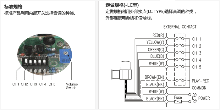

  • ²úÆ·ÄÚ²¿Åä×°ÓÐÒôµ÷Ñ¡Ôñ¿ª¹Ø¼°ÒôÁ¿µ÷½ÚÆ÷£¬Ê¹ÓÃÕß¿ÉÒÔ¸ù¾ÝÐèÇóÏàÓ¦µÄµ÷½ÚÒôµ÷ºÍÒôÁ¿´óС

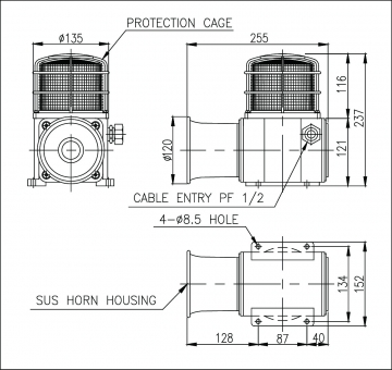

µçÔ´Ïß ÒýÈë¿Ú(CABLE ENTRY)
  • ʹÓ÷ÀË®½ÓÍ·»òÕß´¬²°ÓÃÌîÁϺ¯
  • µçÔ´Ïß ÒýÈë¿Ú ¹æ¸ñ : PF 1/2
  • ÒýÈë¿Ú PF 3/4 ³ß´ç¿ÉÒÔ¶¨×ö
½ÓÏß·½·¨
  • AC µçÔ´²úÆ·£º²»Ó÷ÖÕý¸º¼«¡£
  • DC µçÔ´²úÆ·£ººÚÉ«Ïß¶Ë×ÓÁ¬½ÓÔÚ¸º¼«(-)¡£
¶¨×ö²úÆ·(-LCÐÍ)Òý³öµçÔ´ÏߺÍÐźÅÏß¡£
  • Òý³ö µçÔ´Ïß ¹æ¸ñ : UL1015-NO18(0.75sq) x 2c 400mm
  • Òý³ö ÐźÅÏß ¹æ¸ñ : UL1007-NO.22(0.3sq) 400mm
