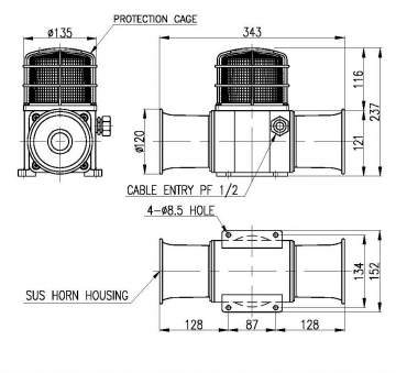

µçÔ´Ïß ÒýÈë¿Ú(CABLE ENTRY)
  • ʹÓ÷ÀË®½ÓÍ·»òÕß´¬²°ÓÃÌîÁϺ¯
  • µçÔ´Ïß ÒýÈë¿Ú ¹æ¸ñ : PF 1/2
  • ÒýÈë¿Ú PF 3/4 ³ß´ç¿ÉÒÔ¶¨×ö

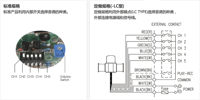

½ÓÏß·½·¨
  • AC µçÔ´²úÆ·£º²»Ó÷ÖÕý¸º¼«¡£
  • DC µçÔ´²úÆ·£ººÚÉ«Ïß¶Ë×ÓÁ¬½ÓÔÚ¸º¼«(-)¡£
¶¨×ö²úÆ·(-LCÐÍ)Òý³öµçÔ´ÏߺÍÐźÅÏß¡£
  • Òý³ö µçÔ´Ïß ¹æ¸ñ : UL1015-NO18(0.75sq) x 2c 400mm
  • Òý³ö ÐźÅÏß ¹æ¸ñ : UL1007-NO.22(0.3sq) 400mm
음색 선택방법
EX)SHD2L -WA -220 -R -(P)
ÐͺŠÒôµ÷ µçѹ ÑÕÉ« ±£»¤Íø
           SHD2L           WS(¾¯¸æÒô)
          WP(ÌØÊ⾯¸æÒô)
          WM(ÒôÀÖÒô)
          WA(¾¯±¨Òô)
          WV(ÉùÒôÐźÅ)
           12-DC12V
           24-DC24V
           110-AC110V
           220-AC220V
             R-ºì
              A-»Æ
             G-ÂÌ
             B-À¶
        ÎÞÖ¸¶¨(None)
        ÎÞ´ø±£»¤ÍøµÄ²úÆ·
        PÖ¸¶¨(Order)
        ´ø±£»¤ÍøµÄ²úÆ·
