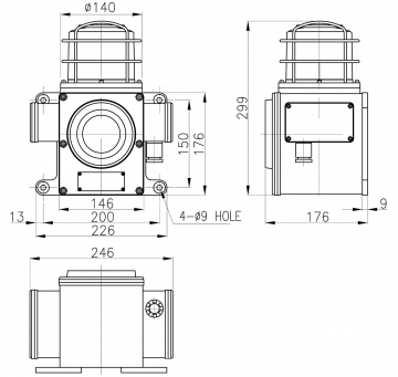

  • ¸úSC3(±Ú¹Òʽ²úÆ·)Ò»Ñù³ß´çµÄ°²×°Ö§¼Ü¿ÉÒÔ¶¨×ö¡£
  • ÌØÊâµçѹ(48V, 440V µÈ) ²úÆ·¿ÉÒÔ¶¨×ö¡£

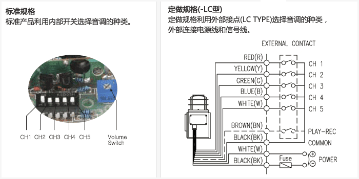

½ÓÏß·½·¨
  • AC µçÔ´²úÆ·£º²»Ó÷ÖÕý¸º¼«¡£
  • DC µçÔ´²úÆ· : ºÚÉ«Ïß¶Ë×ÓÁ¬½ÓÔÚ¸º¼« (-)¡£
¶¨×ö²úÆ·(-LCÐÍ)Òý³öµçÔ´ÏߺÍÐźÅÏß¡£
  • Òý³ö µçÔ´Ïß ¹æ¸ñ : UL1015-NO18(0.75sq) x 2c 400mm
  • Òý³ö ÐźÅÏß ¹æ¸ñ : UL1007-NO.22(0.3sq) 400mm
