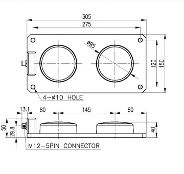

²úÆ·Ãû³Æ£º LED ¼¯×°Ïäµõ¾ßÐźŠ±íʾµÆSSL200-KM
ÐÍ ºÅ£º SSL200-KM
Æ· ÅÆ£º 587
  ÔÚ³¬Ç¿Á¦³å»÷¼°Õ𶯵Ļ·¾³Ï£¬±£³ÖÓÅÐãµÄÄ;ÃÐÔ
  • ºÏÊÊÓÃÓÚ¼¯×°Ïäµõ¾ß, ¸Û¿Ú²úÒµ, ¸÷ÖÖÎÝÍâ°áÔË»úеµÈÐźŴ«´ïÓÃ
  • °ÑÖî°ãÁ㲿¼þ¹à½º´¦Àí£¬ÔÚ³¬Ç¿Á¦³å»÷¼°Õ𶯵Ļ·¾³Ï£¬±£³ÖÓÅÐãµÄÄ;ÃÐÔ
  • ÒòΪ¸÷¶ÎÑÕÉ«Ã÷ÁË£¬Ô¶¾àÀë¿É¼û¶ÈÓÅÐã
  • ²ÉÓ÷ÀÖ¹·´ÉäµÄ¾µÆ¬£¬±ÜÃâ°ÑÒÔÌ«Ñô¹âÏß·´ÉäµÄ¾µÆ¬¹âÏß´íµ±³ÉÐźŹâÏß
  • ²ÄÖÊ : ÉíÌå-Al, µÆÕÖ:PC
  • ±£»¤µÈ¼¶ : IP68(IEC60529)
  • ÄÍÕðÐÔ : 10-500Hz with acceieration up to 10g(IEC 600682-6)
Ðͺеçѹ µçÁ÷ ÖØÁ¿ CABLE ENTRY ÑÕÉ«
              SSL200-KM         DC12V         0.116A           2.15Kg        M12-5PIN
       C10-CABLE

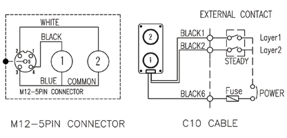

  • M12-5PIN ½ÓÍ·(CONNECTOR)ÐÍ
    µÚ3PINÊǹ«ÓÃÏߣ¬µ«ÄÚ²¿ÓÐÕûÁ÷ÇÅ£¬²»Ó÷ÖÕý¸º¼«½ÓÏßÔÚµÚ3PINºÍµÚ1¡¢4PIN¡£
  • C10 µçÏß Òý³öÐÍ
    Òý³ö µçÔ´Ïß¡¢ÐźÅÏß ¹æ¸ñ : 7G ¡Á0.5㎟ 600V/80¡æ I WIRE 1000mm
