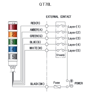

ÐźŵÆ×éºÏ

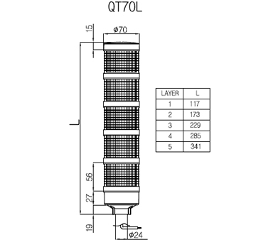

  • Í⾶Ϊ70mmµÄÖ§¸Ë°²×°ÐÍ
  • ÀûÓõ¥²ãÅäÌ××é³ÉµÄÒ»°ã¹æ¸ñ
  • ÐźŵƿÉÒÔ×éºÏ5¸öµ¥²ãÅäÌ×
  • ͨ¹ýµçÄÔUSBÐźÅÏßÀûÓóÌÐòÑ¡ÔñÐźÅÒô
  • ¿Éµ÷½ÚÐźÅÒôÒôÁ¿
  • ×éºÏ¶àÖÖ³¤¶ÈµÄÂÁ¹Ü£¬Ñ¡¶¨·ûºÏÓÚ°²×°»·¾³µÄÖ§¼Ü
  • ±£»¤µÈ¼¶ : IP54
SCREWNUT24 LB24 LW24 QZ24 SZ24A SL24
×é³É¶à¹¦ÄÜÄ£¿éÅäÌ×£¬Ñ¡¶¨ºÏÊÊÓëʹÓÃÕß»·¾³
  • T50LÐÍºÍ QT70LÐÍ ÐźŵÆÅäÌ׺ÍÐźÅÒô£¬ÒÔÌ«ÍøÅäÌ××éºÏÒÔÌ«ÍøÐźŵƣ¬USBÅäÌ××éºÏµÄUSBÐźŵƣ¬ÒÔÉϵIJúÆ·Ä£¿éÅäÌ××é³É£¬Ê¹ÓÃÕßÎÞÐèÆäËû¹¤¾ß°´ÕÕÉ豸µÄ¹¦ÄÜÒªÇó¿ÉÖ±½ÓÉèÖõĶ๦ÄܲúÆ·.
  • ³ýÍⲿÐźÅÒôÐ͵ÄÄ£¿éÅäÌ×ÒÔÍâËùÓеÄÄ£¿éÅäÌ×ʹÓÃÕß¿ÉÉÏÏÂÄܵ÷»»Î»ÖÃ.(רÀû²úÆ·)

ÐͺвãÊý µçѹ µçÁ÷ ÖØÁ¿ ÑÕÉ«
    QT70L-N
     LED ³£ÁÁÐÍ
    QT70L-F
     LED ³£ÁÁ/ÉÁÁÁÐÍ
    QT70L-S
LED ±¬ÉÁÐÍ
    QT70L-R
LED ÐýתÉÁÁÁÐÍ
1
    AC/DC12V
0.120A
0.51Kg
ºì-R
    AC/DC24V
0.060A
0.51Kg
    AC110V
0.018A
0.51Kg
    AC220V
0.020A
0.51Kg
2
    AC/DC12V
0.240A
0.58Kg
ºì-R
Ȯ-A
    AC/DC24V
0.120A
0.58Kg
    AC110V
0.036A
0.58Kg
    AC220V
0.040A
0.58Kg
3
    AC/DC12V
0.360A
0.66Kg
ºì-R
Ȯ-A
ÂÌ-G
    AC/DC24V
0.180A
0.66Kg
    AC110V
0.054A
0.66Kg
    AC220V
0.060A
0.66Kg
4
    AC/DC12V
0.480A
0.74Kg
ºì-R
Ȯ-A
ÂÌ-G
˦-B
    AC/DC24V
0.240A
0.74Kg
    AC110V
0.072A
0.74Kg
    AC220V
0.080A
0.74Kg
5
    AC/DC12V
0.600A
0.82Kg
ºì-R
Ȯ-A
ÂÌ-G
˦-B
°×-W
    AC/DC24V
0.300A
0.82Kg
    AC110V
0.090A
0.82Kg
    AC220V
0.100A
0.82Kg
QT70L-N 3 24 RAG QZ24
ÐͺÅ
²ãÊý
µçѹ
ÑÕÉ«
Ö§¼Ü
QT70L-N
QT70L-F
QT70L-S
QT70L-R
1-1²ã
2-2²ã
3-3²ã
4-4²ã
5-5²ã
           12-DC12V
           24-DC24V
           110-AC110V
           220-AC220V
             ºì-R
Ȯ-A
ÂÌ-G
˦-B
°×-W
±ê×¼-SCREW & NUT
LB24
LW24
QZ24
SZ24
SL24
