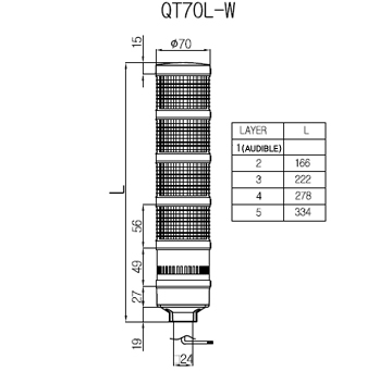

²úÆ·Ãû³Æ£º ¶à¹¦ÄÜ×éºÏʽ LED ÐÅºÅµÆ QT70L-W
ÐÍ ºÅ£º QT70L-W
Æ· ÅÆ£º 587
Éù¹â×éºÏÐÍÐźŵÆ(Ö§¸Ë°²×°ÐÍ)
  • Í⾶Ϊ70mmµÄÖ§¸Ë°²×°ÐÍ
  • ÐźŵÆÅäÌ׺ÍÐźÅÒôÅäÌ××é³ÉµÄÊä³öÐźÅÒô¹æ¸ñ
  • ¿ÉÒÔ×é×°1¸öÐźÅÒôÅäÌ׺Í4¸öÐźŵÆÅäÌ×

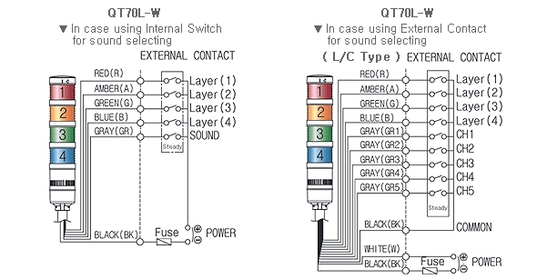

  • ͨ¹ý»úÆ÷ÄÚ²¿¿ª¹Ø»òÍⲿ½ÓµãÑ¡ÔñÐźÅÒôÖÖÀà
  • ¿Éµ÷½Ú·äÃùÆ÷Òô
  • ¿É×éºÏ¶àÖÖ³¤¶ÈµÄÂÁ¹Ü£¬Ñ¡Åä·ûºÏÓÚ°²×°»·¾³µÄÖ§¼Ü
  • ±£»¤µÈ¼¶ : IP54
SCREWNUT24 LB24 LW24 QZ24 SZ24A SL24
×é³É¶à¹¦ÄÜÄ£¿éÅäÌ×£¬Ñ¡¶¨ºÏÊÊÓëʹÓÃÕß»·¾³
  • T50LÐÍºÍ QT70LÐÍ ÐźŵÆÅäÌ׺ÍÐźÅÒô£¬ÒÔÌ«ÍøÅäÌ××éºÏÒÔÌ«ÍøÐźŵƣ¬USBÅäÌ××éºÏµÄUSBÐźŵƣ¬ÒÔÉϵIJúÆ·Ä£¿éÅäÌ××é³É£¬Ê¹ÓÃÕßÎÞÐèÆäËû¹¤¾ß°´ÕÕÉ豸µÄ¹¦ÄÜÒªÇó¿ÉÖ±½ÓÉèÖõĶ๦ÄܲúÆ·.
  • ³ýÍⲿÐźÅÒôÐ͵ÄÄ£¿éÅäÌ×ÒÔÍâËùÓеÄÄ£¿éÅäÌ×ʹÓÃÕß¿ÉÉÏÏÂÄܵ÷»»Î»ÖÃ.(רÀû²úÆ·)

ÐͺвãÊý ÄÚ×°Òô µçѹ µçÁ÷ ÖØÁ¿ ÑÕÉ«
       QT70L-N-W
       LED ³£ÁÁÐÍ
       QT70L-F-W
       LED ³£ÁÁ/ÉÁÁÁÐÍ
       QT70L-S-W
       LED ±¬ÉÁÐÍ
       QT70L-R-W
       LED ÐýתÉÁÁÁÐÍ
    1         WS-¾¯¸æÒô 5Òô
        WM-ÒôÀÖÒô 5Òô
        WA-ÌáʾÒô 5Òô
    AC/DC12V
0.400A
        0.61Kg       ºì-R
    AC/DC24V
0.260A
        0.61Kg
    2     AC/DC12V
0.520A
        0.69Kg
      ºì-R
      »Æ-A
    AC/DC24V
0.320A
        0.69Kg
    3     AC/DC12V
0.640A
        0.76Kg
      ºì-R
Ȯ-A
ÂÌ-G
    AC/DC24V
0.380A
        0.76Kg
    4     AC/DC12V
0.760A
        0.84Kg
      ºì-R
Ȯ-A
ÂÌ-G
˦-B
    AC/DC24V
0.440A
        0.84Kg
    5     AC/DC12V
0.880A
        0.92Kg
      ºì-R
Ȯ-A
ÂÌ-G
˦-B
°×-W
    AC/DC24V
0.500A
        0.92Kg
Ãû ³Æ ƵµÀ ÊÓÌý ÒôÁ¿
¾¯¸æÒô 5Òô »ðÔÖ A-ANG(»ðžÄ)Òô
½ô¼± WA-U(¾o¼±)Òô
¼±¾È PI-PO(¾È¼±)Òô
¶ÏÐøÒô
High-Expansion Foam Release
MAX 90dB
ÒôÀÖÒô 3Òô Sweet Home
For Elise
Sukoos Waltz
Piano Sonata
Turkish March
MAX 90dB
¾¯±¨ Òô 5Òô Beep. intermittent
Door Chime
Phone Ring Sound
PI.PI.PI.PI. Short Interval
Phone Ring Sound
MAX 90dB
