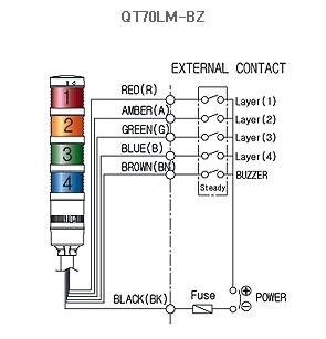

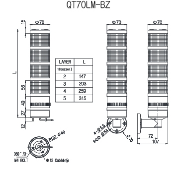

²úÆ·Ãû³Æ£º ¶à¹¦ÄÜ×éºÏʽ LED ÐÅºÅµÆ QT70LM-BZ
ÐÍ ºÅ£º QT70LM-BZ
Æ· ÅÆ£º 587
·äÃùÆ÷ÐÍÐźŵÆ×éºÏ £¨×ÔÁ¢ÐÍ, ±Ú×°ÐÍ)
  • Í⾶Ϊ70mmµÄ ×ÔÁ¢ÐÍ
  • ·äÃùÆ÷ÅäÌ׺͵¥²ãÅäÌ××é³ÉµÄÊä³ö·äÃùÆ÷Òô¹æ¸ñ
  • ¿ÉÒÔ×é×°1¸ö·äÃùÆ÷ÅäÌ׺Í4¸öÐźŵÆÅäÌ×
  • Q70L-BZ(±ê×¼·äÃùÆ÷£©Ä£¿é¿ÉÒÔµ÷½ÚÒôÁ¿
  • ·ÖΪ´¹Ö±°²×°ÐͺͱÚ×°ÐÍ
  • ±£»¤µÈ¼¶ : IP54
SCREWNUT24 LB24 LW24 QZ24 SZ24A SL24
×é³É¶à¹¦ÄÜÄ£¿éÅäÌ×£¬Ñ¡¶¨ºÏÊÊÓëʹÓÃÕß»·¾³
  • T50LÐÍºÍ QT70LÐÍ ÐźŵÆÅäÌ׺ÍÐźÅÒô£¬ÒÔÌ«ÍøÅäÌ××éºÏÒÔÌ«ÍøÐźŵƣ¬USBÅäÌ××éºÏµÄUSBÐźŵƣ¬ÒÔÉϵIJúÆ·Ä£¿éÅäÌ××é³É£¬Ê¹ÓÃÕßÎÞÐèÆäËû¹¤¾ß°´ÕÕÉ豸µÄ¹¦ÄÜÒªÇó¿ÉÖ±½ÓÉèÖõĶ๦ÄܲúÆ·.
  • ³ýÍⲿÐźÅÒôÐ͵ÄÄ£¿éÅäÌ×ÒÔÍâËùÓеÄÄ£¿éÅäÌ×ʹÓÃÕß¿ÉÉÏÏÂÄܵ÷»»Î»ÖÃ.(רÀû²úÆ·)

ÐͺвãÊý µçѹ µçÁ÷ ÖØÁ¿ ÑÕÉ«
    QT70LM-N-BZ
LED ³£ÁÁÐÍ
    QT70LM-F-BZ
LED ³£ÁÁ/ÉÁÁÁÐÍ
    QT70LM-S-BZ
LED ±¬ÉÁÐÍ
    QT70LM-R-BZ
LED ÐýתÉÁÁÁÐÍ
1
    AC/DC12V
0.136A
0.25Kg
ºì-R
    AC/DC24V
0.091A
0.25Kg
    AC110V
0.045A
0.25Kg
    AC220V
0.050A
0.25Kg
2
    AC/DC12V
0.256A
0.33Kg
ºì-R
Ȯ-A
    AC/DC24V
0.151A
0.33Kg
    AC110V
0.063A
0.33Kg
    AC220V
0.070A
0.33Kg
3
    AC/DC12V
0.376A
0.40Kg
ºì-R
Ȯ-A
ÂÌ-G
    AC/DC24V
0.211A
0.40Kg
    AC110V
0.081A
0.40Kg
    AC220V
0.090A
0.40Kg
4
    AC/DC12V
0.496A
0.48Kg
ºì-R
Ȯ-A
ÂÌ-G
˦-B
    AC/DC24V
0.271A
0.48Kg
    AC110V
0.099A
0.48Kg
    AC220V
0.110A
0.48Kg
5
    AC/DC12V
0.616A
0.56Kg
ºì-R
Ȯ-A
ÂÌ-G
˦-B
°×-W
    AC/DC24V
0.331A
0.56Kg
    AC110V
0.117A
0.56Kg
    AC220V
0.130A
0.56Kg
QT70LM-BZ 3 24 RAG BS
ÐͺÅ
²ãÊý
µçѹ
ÑÕÉ«
Ö§¼Ü
QT70LM-N-BZ
QT70LM-F-BZ
QT70LM-S-BZ
QT70LM-R-BZ
1-1²ã
2-2²ã
3-3²ã
4-4²ã
5-5²ã
           12-DC12V
           24-DC24V
           110-AC110V
           220-AC220V
             ºì-R
Ȯ-A
ÂÌ-G
˦-B
°×-W
BS(×ÔÁ¢ÐÍ)
WB(±Ú×°ÐÍ)
