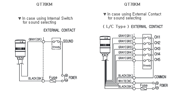

  • ͨ¹ý»úÆ÷ÄÚ²¿¿ª¹Ø»òÍⲿ½ÓµãÑ¡ÔñÐźÅÒôÖÖÀà

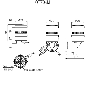

  • ·ÖΪ´¹Ö±°²×°ÐͺͱÚ×°ÐÍ
  • ±£»¤µÈ¼¶ : IP54

±Ú×°ÐÍ Ö§¼Ü
  Q70L-WB  ²ÄÖÊ : ABS
ÐͺŠÄÚ×°Òô µçѹ µçÁ÷ ÖØÁ¿
       QT70KM
