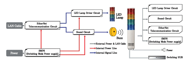

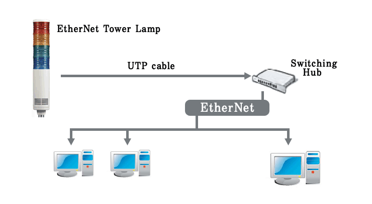

¸ß¿Æ¼¼ÒÔÌ«ÍøÍ¨Ñ¶¶à²ãÐźŵƣ¬Á¬½ÓÔÚÍøÂçºÍ¾ÖÓòÍø(LANÍø)ÉÏ£¬¿ÉÔ¶³Ì¼à¿ØÉ豸
  • Á¬½ÓÔÚÍøÂçºÍ¾ÖÓòÍø(LANÍø)£¬¿ØÖÆÒÔÌ«Íø(EtherNet)ͨѶ¿ØÖÆÓöà²ãÐźŵÆ
  • ÒÔÌ«Íø£ºÔÚ¹¹ÔìÒòÌØÍø»òÕß¾ÖÓòÍøµÄµØ·½, ¿ÉÒÔÔÚÊÀ½çÈκεط½·¢ËͺͽÓÊÜÐÅÏ¢

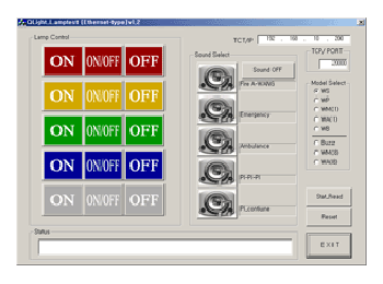

  • ÒÔµçÄÔÉϵÄÓÎÀÀÆ÷»òÓ¦ÓóÌÐò, ͨ¹ýÔ¶³Ì¿ÉÒÔ¼à¿Ø»òÕß¿ØÖÆÉ豸

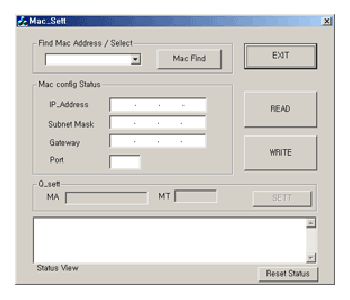

  • ÁíÍâÌṩÉèÖÿì½ÝÓïÑÔ, ¶ÔÓÚ¸÷×°±¸µÄIP, ServeNet Mask, ÍøÁª, µçÄÔʹÓÃÕßÄܹ»ÈÝÒײÙ×÷
  • ×î¶à¿ÉʵÏÖ5²ã°²×°£¬²¢¿É¸ù¾ÝÐèÇóÑ¡Ôñ°²×°ÐźÅÒô

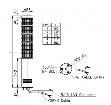

ÐͺÅ(Model) ÏîÄ¿(Item) Ïêϸ²ÎÊý(Descripttion)
              ST56MEL-ETNB
              ÄÚ×°·äÃùÆ÷ÐÍ
        ¶à²ãÐÅºÅµÆ ¶ÎÊý : 1~5
µçѹ : DC24V
µçÁ÷ : 0.27
ÑÕÉ« :  ºì-R »Æ-A ÂÌ-G À¶-B °×-W
       ·äÃùÆ÷ µçѹ/µçÁ÷ : 24V/20mA µçѹ : DC24V
ÒôÁ¿ : Max.90dB/m
       ÐźŠIEEE 8023 Protocol ÐÎʽ, 10 BASE-T(Ö§³Ö 10Mbps/sec.)
       µçÀ ÐźÅl : UTP µçÀ {2m, 8W, (1.°×Öì), (2.Öì), (3.°×ÂÌ), (4.ÂÌ)}, RJ45 Connector
Power : AC220V {2m, 2W, 0.70㎟, ²åÍ·ÐÍ}
       µçÔ´¹©Ó¦·½Ê½ AC-DC Convert SMPS, Fly Back Type
ÊäÈë : AC 85V~265V/240mA
¹©Ó¦ : LED Lamp Power, Piezo Buzzer Power
DC ¨C DC Convert Buck Type
ÊäÈë: DC12V, Output : DC3.3V/1000mA
¹©Ó¦ : EtherNet Controller Power
