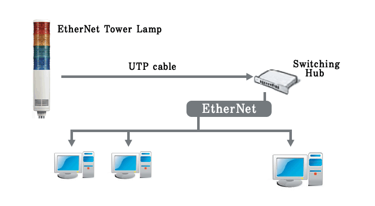

¸ß¿Æ¼¼ÒÔÌ«ÍøÍ¨Ñ¶¶à²ãÐźŵƣ¬Á¬½ÓÔÚÍøÂçºÍ¾ÖÓòÍø(LANÍø)ÉÏ£¬¿ÉÔ¶³Ì¼à¿ØÉ豸
  • Á¬½ÓÔÚÍøÂçºÍ¾ÖÓòÍø(LANÍø)£¬¿ØÖÆÒÔÌ«Íø(EtherNet)ͨѶ¿ØÖÆÓöà²ãÐźŵÆ
  • ÒÔÌ«Íø£ºÔÚ¹¹ÔìÒòÌØÍø»òÕß¾ÖÓòÍøµÄµØ·½, ¿ÉÒÔÔÚÊÀ½çÈκεط½·¢ËͺͽÓÊÜÐÅÏ¢

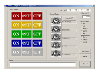

  • ÒÔµçÄÔÉϵÄÓÎÀÀÆ÷»òÓ¦ÓóÌÐò, ͨ¹ýÔ¶³Ì¿ÉÒÔ¼à¿Ø»òÕß¿ØÖÆÉ豸

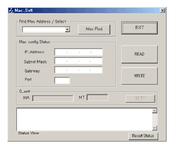

  • ÁíÍâÌṩÉèÖÿì½ÝÓïÑÔ, ¶ÔÓÚ¸÷×°±¸µÄIP, ServeNet Mask, ÍøÁª, µçÄÔʹÓÃÕßÄܹ»ÈÝÒײÙ×÷

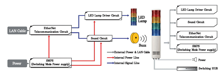

Ëõ΢оƬ, ÒôÏì·Å´óÆ÷¼°ÒôÏäÐÎʽµÄ×°ÖÃÄÚ×°
       ÐźŠIEEE 8023 Protocol ÐÎʽ, 10 BASE-T(Ö§³Ö 10Mbps/sec.)
       µçÀ ÐźŠ: UTP µçÀ {2m, 8W, (1.°×Öì), (2.Öì), (3.°×ÂÌ), (4.ÂÌ)}, RJ45 Connector
µçÔ´ : AC220V {2m, 2W, 0.70㎟, ²åÍ·ÐÍ}
       µçÔ´¹©Ó¦·½Ê½ AC-DC Convert SMPS, Fly Back Type
ÊäÈë : AC 85V~265V/240mA
¹©Ó¦ : LED Lamp Power, Piezo Buzzer Power
DC ¨C DC Convert Buck Type
ÊäÈë: DC12V, Output : DC3.3V/1000mA
¹©Ó¦ : EtherNet Controller Power
