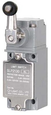

²úÆ·Ãû³Æ£º ·ÀË®ÐÍÐг̿ª¹Ø-¹öÖù ´«¶¯¸ËÐÍ SLP2130-RL
ÐÍ ºÅ£º SLP2130-RL
Æ· ÅÆ£º 587
·ÀË®ÐÍÐг̿ª¹Ø-¹öÖù ´«¶¯¸ËÐÍ SLP2130-RL ÂÁºÏ½ð Íâ¿Ç
SLP2130S-RL ÇàÍ­ Íâ¿Ç
  • °²×° PC ¹öÖùµÄ ¹Ì¶¨´«¶¯¸ËÐÍ£¬µ½¶¯×÷֮ǰµÄÔ˶¯Ð¡£¬´«´ï¸ËµÄÔ˶¯´ó£¬Éè¼ÆÏÞλ¿éÈÝÒ×
  • ²ÉÓÃ2ÖØµ¯»É»Ø¸´ÏµÍ³£¬ÔÚ³¤Ê±¼ä±£³Ö¿ª¹ØON״̬·¢»ÓÎȶ¨µÄ¶¯×÷ÌØÐÔ
  • ÔÚÍⲿʹÓõÄÂÝ˨ºÍÂÝĸʹÓò»Ðâ¸Ö²ÄÁÏÓÅÐãÄ͸¯Ê´ÐÔ
  • SLP2130S-RLÐÍÊÇÇàÍ­Íâ¿Ç²úÆ·£¬ÓÅÐãÄ͸¯Ê´ÐÔ
  • ÊʺÏÓÃÓÚÖÆÒ©¹¤³§¡¢Ê³Æ·¼Ó¹¤»úе¡¢Ï´µÓ»ú¡¢»ú²Õ¡¢Ë®Ä๤³§¡¢ÊÒÍâÉ豸ÓÃ
  • ÉíÌå ±ê×¼ÑÕÉ« : SLP2130 - MUNSELL NO. 5.0 , SLP2130S - MUNSELL NO 7.5BG 7/2
  • ²ÄÖÊ : ÉíÌå-SLP2130 : DIECAST Al, SLP2130S : CAST BRASS,  ÂÝË¿-SUS, ¹öÖù-PC
  • ±£»¤¹¹Ôì : ·ÀË®¡¢·ÀÓÍ¡¢·À³¾¹¹Ôì(IP67)
  • ¼¼ÊõÈÏÖ¤ : KIMM
  • Äͺ®ÐÍ(-40¡æ~+40¡æ)ºÍÄÍÈÈÐÍ(+5¡æ~+120¡æ)¿ÉÒÔ¶¨×öÌṩ
