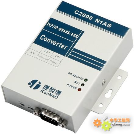

ÐÍ ºÅ£º C2000 N1AS
C2000 N1AS£¬´®¿Ú·þÎñÆ÷,´®¿Ú×ªÍøÂç,485/422תRJ45,485תmodbusÒÔÌ«Íø¡£
C2000 N1ASÊǾ߱¸ÓиßÐÔ¼Û±ÈÇÒÎȶ¨¿É¿¿µÄ485תÒÔÌ«Íø·þÎñÆ÷¡£ËüÌṩRS485/422µ½ TCP/IPÍøÂçºÍTCP/IPÍøÂçµ½RS485/422µÄÊý¾Ý͸Ã÷´«Ê䣬Ëü¿ÉÒÔʹ¾ßÓÐRS485/422´®¿ÚµÄÉ豸Á¢¼´¾ß±¸ÁªÈëTCP/IPÍøÂçµÄ¹¦ÄÜ¡£C2000 N1AS:485×ªÍøÂçÖÐÔËÐÐÓÐǶÈëʽ³ÌÐò£¬ËüÃǵŦÄÜÊÇÓÉÕâ¸öǶÈëʽ³ÌÐòÀ´ÊµÏֵ쬵±Ç¶Èëʽ³ÌÐò³öÏÖ¹ÊÕϾͻᵼÖÂ485תRJ45/ÒÔÌ«ÍøÄ£¿é¹¤×÷Òì³££¬¿´ÃŹ·Éè¼ÆµÄÖ÷Òª×÷ÓÃÊÇ·ÀÖ¹485תTCP/IPÄ£¿éÖеÄǶÈëʽ³ÌÐòÅÜ·É»òËÀËø¡£µ±485תÒÔÌ«ÍøÄ£¿é/´®¿Ú·þÎñÆ÷¹¤×÷Ò쳣ʱ£¬¿´ÃŹ·½«×Ô¶¯¸´Î»¶øÖØÐÂÔËÐÐǶÈëʽ³ÌÐò£¬´ó´óÌá¸ßÁËÎÒÃDzúÆ·µÄÎȶ¨ÐÔ£¬×î´óÏ޶ȱ£Ö¤¿Í»§Í¨Ñ¶É豸Õý³£Îȶ¨ÔËÐС£
C2000 N1ASÏòÉÏÌṩ10MÒÔÌ«Íø½Ó¿Ú£¬ÏòÏÂÌṩ1¸ö±ê×¼RS485/422´®Ðпڣ¬Í¨Ñ¶²ÎÊý¿Éͨ¹ý¶àÖÖ·½Ê½ÉèÖá£C2000 N1AS¿É¹ã·ºÓ¦ÓÃÓÚ»ú·¿¼à¿Ø¡¢Â·µÆ¿ØÖÆ¡¢µçÁ¦¼à¿Ø¡¢ÎïÁªÍø¡¢¿ó¾®¼à¿Ø¡¢ÖÇÄܾƵê/¼Ò¾Ó¡¢ERP/MES¡¢Ìú·Êý¾Ý²É¼¯¡¢ÒøÐмÓÃÜÉ豸¡¢¹ú¼ÒÍøÂ籨˰É豸¡¢PLCÁªÍømodbusÍø¹Ø¡¢Ô¶³Ì³­±í·½°¸¡¢¿ØÖÆÉ豸¡¢¹ã²¥µçÊÓ¡¢ÃŽûÒ»¿¨Í¨¡¢µç×ÓΧÀ¸¡¢¹¤Òµ×Ô¶¯»¯¡¢»·±£ÐÐÒµ¡¢Êý¾Ý²É¼¯¡¢ÎÂʪ¶È²É¼¯É豸¡¢ÖÇÄܽ»Í¨¡¢Ò½ÁÆÆ÷еµÈÐÐÒµ¡£

a)  ±¾²úÆ·ÓÐÒÔÏÂÈýÖÖ¹¤×÷ģʽ£º
1£®×÷ΪTCP·þÎñÆ÷£¬×ª»»Æ÷ÉϵçºóÔÚÖ¸¶¨µÄTCP ¶Ë¿ÚµÈ´ýÊý¾Ý·þÎñÆ÷µÄÁ¬½ÓÇëÇó£¬Êý¾Ý·þÎñÆ÷ÔÚÐèÒªÓëת»»Æ÷ͨѶµÄʱºò£¬Ïòת»»Æ÷µÄ¼àÌý¶Ë¿ÚÇëÇó½¨Á¢TCP Á¬½Ó£¬Á¬½Ó½¨Á¢ºó£¬Êý¾Ý·þÎñÆ÷¿ÉÒÔËæÊ±Ïòת»»Æ÷·¢ËÍÊý¾Ý£¬×ª»»Æ÷Ò²¿ÉÒÔËæÊ±½«Êý¾Ý·¢Ë͵½Êý¾Ý·þÎñÆ÷£¬ÔÚÍê³ÉÖ¸¶¨µÄͨѶºó£¬Êý¾Ý·þÎñÆ÷¿ÉÒÔÖ÷¶¯ÒªÇó¶Ï¿ªÁ¬½Ó£¬·ñÔòÁ¬½ÓÒ»Ö±±£³Ö¡£
2£®×÷ΪTCP¿Í»§¶Ë£¬×ª»»Æ÷Éϵçʱ»áÖ÷¶¯Ïò·þÎñÆ÷ÇëÇóÁ¬½Ó£¬Ö±µ½TCPÁ¬½Ó½¨Á¢ÎªÖ¹£¬²¢ÇÒÁ¬½ÓÒ»µ©½¨Á¢½«Ò»Ö±±£³Ö£¬Á¬½Ó½¨Á¢ºó£¬Êý¾Ý·þÎñÆ÷¿ÉÒÔËæÊ±Ïòת»»Æ÷·¢ËÍÊý¾Ý£¬×ª»»Æ÷Ò²¿ÉÒÔËæÊ±½«Êý¾Ý·¢Ë͵½Êý¾Ý·þÎñÆ÷¡£
3£®UDP·½Ê½£¬µ±C2000 ¹¤×÷ÔÚ“UDP”ģʽʱ£¬ËüÄܽÓÊÕËùÓеÄIPµØÖ·ºÍ¶Ë¿Ú·¢¹ýÀ´µÄÊý¾Ý£¬µ«Ö»½«·µ»ØµÄÊý¾Ý·¢Ë͸øÖ¸¶¨µÄIPµØÖ·ºÍ¶Ë¿Ú¡£
b)  Ó¦ÓÃÈí¼þ¿ÉʹÓÃÈýÖÖ·½Ê½Óëת»»Æ÷ͨѶ£º
1£®Í¨¹ý±¾¹«Ë¾¿ª·¢µÄÐéÄâ´®¿Ú¹ÜÀí³ÌÐò£¬½«ÍøÂçÊý¾ÝÖØ¶¨Ïòµ½ÐéÄâ´®¿Ú£¬È»ºó´ÓÐéÄâ´®¿Ú¶ÁÈ¡Êý¾Ý¡£
2£®Óñ¾¹«Ë¾¿ª·¢µÄ¿Ø¼þEDSockServer.ocx(»ò¶¯Ì¬¿âEDSockServer.dll)¡£
3£®Ê¹ÓÃSocket½øÐÐͨѶ¡£
