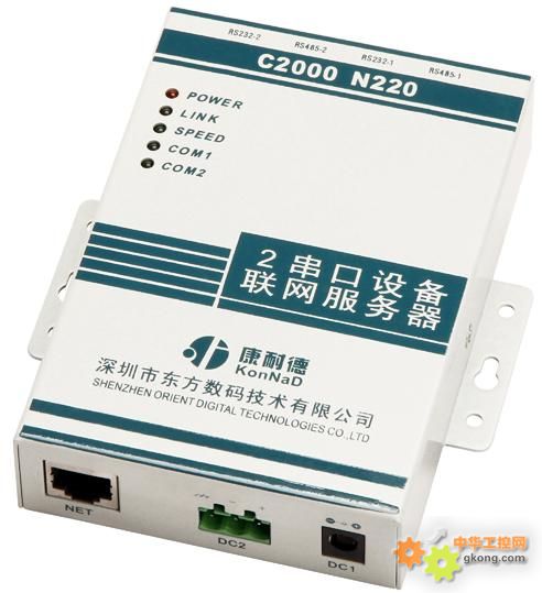

C2000 N220 ¿µÄ͵ Konnad 2¿Ú´®¿Ú×ªÍø¿Ú ¹¤Òµ¼¶485/422/232תTCP/IPÒÔÌ«Íø
¸ÅÊö£º
    C2000 N220ÊÇÒ»ÖÖÎȶ¨¿É¿¿µÄ¸ßÐÔÄܹ¤Òµ¼¶2¿Ú´®¿Ú×ªÍø¿ÚÉ豸ÁªÍø·þÎñÆ÷£¬ËüÌṩ
RS232/485/422µ½TCP/IPÒÔÌ«ÍøºÍTCP/IPÍøÂçµ½RS485/422µÄÊý¾Ý͸Ã÷´«Ê䣬Ëü¿ÉÒÔ
ʹ¾ßÓÐRS485/422´®¿ÚµÄÉ豸Á¢¼´¾ß±¸ÁªÈëTCP/IPÍøÂçµÄ¹¦ÄÜ¡£
    C2000 N220ÏòÉÏÌṩ10/100MÒÔÌ«Íø½Ó¿Ú£¬ÏòÏÂÌṩ2¸ö±ê×¼RS485/422´®Ðпڣ¬
ͨѶ²ÎÊý¿Éͨ¹ý¶àÖÖ·½Ê½ÉèÖᣠC2000 N220?¿É¹ã·ºÓ¦ÓÃÓÚPLC¿ØÖÆÓë¹ÜÀí¡¢ ÃŽû
Ò½ÁÆ¡¢ Â¥Óî×Ô¿Ø¡¢ ¹¤Òµ×Ô¶¯»¯¡¢ ²âÁ¿ÒÇ±í¼°»·¾³¶¯Á¦¼à¿ØÏµÍ³¡¢ ÐÅÏ¢¼Òµç¡¢
LEDÐÅÏ¢ÏÔʾÉ豸ºÍCNC¹ÜÀíµÈ¡£
ÌØµã£º
²ÉÓÃARM7´¦ÀíÆ÷+RTOS£¬¾ßÓиüÇ¿´óµÄʵʱ´¦ÀíÄÜÁ¦
¾ßÓÐTCP Server£¬TCP Client¡¢UDP¡¢ÐéÄâ´®¿Ú¡¢µã¶ÔµãÁ¬½ÓµÈÎåÖÖ²Ù×÷ģʽ£»
Óû§»ùÓÚÍøÂçµÄÈí¼þ£¬²»ÐèÒª×öÈκÎÐ޸ľͿÉÒÔÓëC2000 N220ͨѶ£»
ͨ¹ý°²×°ÎÒÃÇÃâ·ÑÌṩµÄÐéÄâ´®¿ÚÈí¼þ£¬Óû§»ùÓÚ´®¿ÚµÄÈí¼þ²»ÐèÒª×öÈκÎÐ޸ľÍ
¿ÉÒÔÓëC2000 N220ͨѶ£»
¶ÔÓÚÐèÒª¿ª·¢Èí¼þµÄÓû§£¬ÎÒÃÇÃâ·ÑÌṩͨѶ¶¯Ì¬¿â¡¢ÉèÖö¯Ì¬¿â»òOCX¿Ø¼þ
ͨ¹ýä¯ÀÀÆ÷¡¢ÉèÖÃÈí¼þ»òÉèÖö¯Ì¬¿â½øÐвÎÊýÉèÖã»
µÍ¹¦ºÄÉè¼Æ£¬ÎÞÐèÉ¢ÈÈ×°ÖÃ
Ë«¿´ÃŹ·Éè¼Æ£¬Îȶ¨ÐÔ¸ß
µçÔ´¾ßÓйýÁ÷¹ýѹ±£»¤ºÍ·À·´½Ó¹¦ÄÜ
Ó¦Ó㺠
»ú·¿¼à¿Ø¡¢Â·µÆ¿ØÖÆ¡¢µçÁ¦¼à¿Ø¡¢ÎïÁªÍø¡¢¿ó¾®¼à¿Ø¡¢ÖÇÄܾƵê/¼Ò¾Ó¡¢ERP/MES¡¢Ìú·Êý¾Ý²É¼¯¡¢ÒøÐмÓÃÜÉ豸¡¢¹ú¼ÒÍøÂ籨˰É豸¡¢PLCÁªÍømodbusÍø¹Ø¡¢Ô¶³Ì³­±í·½°¸¡¢¿ØÖÆÉ豸¡¢¹ã²¥µçÊÓ¡¢ÃŽûÒ»¿¨Í¨¡¢µç×ÓΧÀ¸¡¢¹¤Òµ×Ô¶¯»¯¡¢»·±£ÐÐÒµ¡¢Êý¾Ý²É¼¯¡¢ÎÂʪ¶È²É¼¯É豸¡¢ÖÇÄܽ»Í¨¡¢Ò½ÁÆÆ÷еµÈ¡£
¼¼Êõ²ÎÊý£º
· ϵͳ
CPU 32-bit  ARM
RAM  64KB
Flash  256KB
· LAN
ÒÔÌ«Íø 10/100 Mbps×ÔÊÊÓ¦£¬RJ45
±£»¤ ÄÚÖÃ1.5KV µç´Å¸ôÀë±£»¤
· ´®¿Ú
´®¿ÚÊýÁ¿    2¸ö
½çÃæ    2¸öRS232/485/422
· ´®¿ÚͨѶ²ÎÊý
У Ñé None£¬Even£¬Odd£¬Space£¬Mark
Êý¾Ýλ 5£¬6£¬7£¬8
ֹͣλ 1£¬1.5£¬2
Á÷Á¿¿ØÖÆ   RTS/CTS, XON/XOFF
ËÙ ÂÊ    300bps ÖÁ115200 bps
· Èí¼þÌØµã
ЭÒé ICMP£¬ARP£¬IP£¬TCP£¬UDP£¬DHCP£¬HTTP£¬DNS
²Ù×÷ģʽ   TCP Server£¬TCP Client£¬UDP£¬ÐéÄâ´®¿Ú£¬µã¶ÔµãÁ¬½Ó
ÉèÖàC2000ÉèÖóÌÐò¡¢Webä¯ÀÀÆ÷¡¢ÉèÖö¯Ì¬¿â¡¢´®¿ÚÉèÖ㨿ÉÑ¡£©
ÌṩÈí¼þ   ÐéÄâ´®¿ÚÈí¼þ¡¢C2000ÉèÖóÌÐò¡¢´®¿Úµ÷ÊÔ¹¤¾ß¡¢ÍøÂç²âÊÔ³ÌÐò¡¢
EDSocketServer.OCX¿Ø¼þ£¬EDSocketServer.DLL¶¯Ì¬¿â¡¢ÉèÖö¯Ì¬¿âÒÔ¼°VB¡¢
VC¡¢BC¡¢DelphiµÄʾÀý´úÂë
Çý¶¯Ö§³Ö      Windows 98/ME/2000/XP/2003
·µçÔ´ÐèÇó
µçÔ´ÊäÈë    DC9~24V £¨ÍƼö12VDC£©
·»·¾³
²Ù×÷ζȠ  -30¡æ~85¡æ£¬5~95%RH
´¢´æÎ¶Ƞ  -60¡æ~125¡æ£¬5~95%RH
¹¤×÷ʪ¶È   5~95%RH£¬²»Äý¶
·ÆäËû
±£ÐÞ  ÎåÄê
³ß´ç 121*85*26mm
