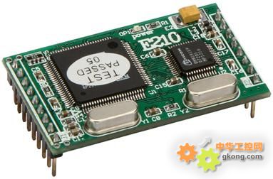

²úÆ·Ãû³Æ£º ´®¿Ú×ªÍø¿Ú,TTLתÒÔÌ«Íø,ÒÔÌ«Íø×ªTTL
ÐÍ ºÅ£º C2000 E210
C2000 E210 ´®¿Ú×ªÍø¿Ú,TTLתÒÔÌ«Íø,ÒÔÌ«Íø×ªTTL
¸ÅÊö£º
    C2000 E210ÊǾßÓиßÐÔ¼Û±ÈÇÒÎȶ¨¿É¿¿µÄ´®¿ÚÉ豸ǶÈëʽÁªÍøÄ£¿é£¬ËüÌṩTTL´®¿Úµ½TCP/IPÍøÂçºÍTCP/IPÍøÂçµ½TTL´®¿ÚµÄÊý¾Ý͸Ã÷´«Ê䣬Ëü¿ÉÒÔʹÉ豸Á¢¼´¾ß±¸ÁªÈëTCP/IPÍøÂçµÄ¹¦ÄÜ¡£
    C2000 E210ÏòÉÏÌṩ10/100MÒÔÌ«Íø½Ó¿Ú£¬ÏòÏÂÌṩ1¸ö±ê×¼TTL´®Ðпڣ¬Í¨Ñ¶²ÎÊý¿Éͨ¹ý¶àÖÖ·½Ê½ÉèÖá£C2000 E210¿É¹ã·ºÓ¦ÓÃÓÚPLC¿ØÖÆÓë¹ÜÀí¡¢ÃŽûÒ½ÁÆ¡¢Â¥Óî×Ô¿Ø¡¢¹¤Òµ×Ô¶¯»¯¡¢²âÁ¿ÒÇ±í¼°»·¾³¶¯Á¦¼à¿ØÏµÍ³¡¢ÐÅÏ¢¼Òµç¡¢LEDÐÅÏ¢ÏÔʾÉ豸ºÍCNC¹ÜÀíµÈ¡£

· ϵͳ
CPU   32-bit ARM
RAM    64KB
Flash    256KB
· LAN
ÒÔÌ«Íø   10/100Mpbs
· ´®¿Ú½Ó¿Ú''
TTL  TXD £¬ RXD £¬ RTS £¬ CTS £¬ GND
· ´®¿ÚͨѶ²ÎÊý
У Ñé    None£¬Even£¬Odd£¬MARK£¬SPACE
Êý¾Ýλ    5£¬6£¬7£¬8
ֹͣλ    1£¬2
Á÷Á¿¿ØÖÆ   RTS/CTS£¬XON/XOFF£¨TTLתRS232£©
RTS/CTS   £¨TTLתRS485/422£©
ËÙ ÂÊ      300 bps ÖÁ115200 bps
· Èí¼þÌØµã
ЭÒé  ICMP£¬ARP£¬IP£¬TCP£¬UDP£¬DHCP£¬HTTP£¬DNS
²Ù×÷ģʽ TCP Server£¬TCP Client£¬UDP£¬ÐéÄâ´®¿Ú£¬µã¶ÔµãÁ¬½Ó
ÉèÖà  C2000ÉèÖóÌÐò¡¢Webä¯ÀÀÆ÷¡¢ÉèÖö¯Ì¬¿â¡¢´®¿ÚÉèÖ㨿ÉÑ¡£©
ÌṩÈí¼þ ÐéÄâ´®¿ÚÈí¼þ¡¢C2000ÉèÖóÌÐò¡¢´®¿Úµ÷ÊÔ¹¤¾ß¡¢ÍøÂç²âÊÔ³ÌÐò¡¢EDSocketServer.OCX¿Ø¼þ£¬EDSocketServer.DLL¶¯Ì¬¿â¡¢ÉèÖö¯Ì¬¿âÒÔ¼°VB¡¢VC¡¢BC¡¢DelphiµÄʾÀý´úÂë
Çý¶¯Ö§³Ö Windows 98/ME/2000/XP/2003
·µçÔ´ÐèÇó
µçÔ´¹æ¸ñ      5VDC £¬± 5%
µçÁ÷        ×î´óµçÁ÷СÓÚ80mA
·»·¾³
²Ù×÷ÎÂ¶È    -40¡æ~85¡æ£¬5~95%RH
´¢´æÎÂ¶È    -60¡æ~125¡æ£¬5~95%RH
·ÆäËû
±£ÐÞ  1ÄêÖʱ£
³ß´ç  44*26mm
