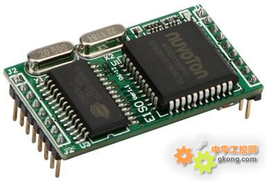

²úÆ·Ãû³Æ£º ¹¤Òµ¼¶TTLתÒÔÌ«Íø,´®¿ÚתRJ45/Íø¿Ú
ÐÍ ºÅ£º C2000 E1S0
C2000 E1S0 ¹¤Òµ¼¶TTLתÒÔÌ«Íø,´®¿ÚתRJ45/Íø¿Ú
¿µÄ͵£¬13ÄêÀ´Ò»Ö±Á¢Ö¾Òª³ÉΪ×î¿É¿¿µÄÎïÁªÍøÇ°¶ËÉ豸ÌṩÉÌ£¬¹«Ë¾×¢²á×ʽð´óÓÚ1000Íò£¬Êǹú¼Ò¼¶¸ßм¼ÊõÆóÒµ¡¢Èí¼þÆóÒµ¡¢Öйú°²·À°ÙÇ¿ÆóÒµ¡¢ÖÇ»ÛÖйúÁªºÏ»áÀíʵ¥Î»¡¢ÉîÛÚÊÐÐÅÏ¢¹¤³ÌЭ»á¸±»á³¤µ¥Î»¡¢ÉîÛÚÊа²·À²úÒµ±ê×¼ÁªÃËÀíʵ¥Î»¡£¹¤Òµ¼¶´®¿Ú·þÎñÆ÷¡¢´®¿Úת»»Æ÷¡¢I/OÁªÍøÄ£¿é¡£
C2000 E1S0ÊǾßÓиßÐÔ¼Û±ÈÇÒÎȶ¨¿É¿¿µÄ´®¿ÚÉ豸ǶÈëʽÁªÍøÄ£¿é£¬ËüÌṩTTL´®¿Úµ½TCP/IPÍøÂçºÍTCP/IPÍøÂçµ½TTL´®¿ÚµÄÊý¾Ý͸Ã÷´«Ê䣬Ëü¿ÉÒÔʹÉ豸Á¢¼´¾ß±¸ÁªÈëTCP/IPÍøÂçµÄ¹¦ÄÜ¡£
C2000 E1S0ÏòÉÏÌṩ10MÒÔÌ«Íø½Ó¿Ú£¬ÏòÏÂÌṩ1¸ö±ê×¼TTL´®Ðпڣ¬Í¨Ñ¶²ÎÊý¿Éͨ¹ý¶àÖÖ·½Ê½ÉèÖᣠC2000 E1S0 ¿É¹ã·ºÓ¦ÓÃÓÚPLC¿ØÖÆÓë¹ÜÀí¡¢ ÃŽûÒ½ÁÆ¡¢ Â¥Óî×Ô¿Ø¡¢ ¹¤Òµ×Ô¶¯»¯¡¢ ²âÁ¿ÒÇ±í¼°»·¾³¶¯Á¦¼à¿ØÏµÍ³¡¢ ÐÅÏ¢¼Òµç¡¢ LEDÐÅÏ¢ÏÔʾÉ豸ºÍCNC¹ÜÀíµÈ¡£
