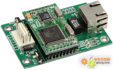

C2000 E2MS RS232תÒÔÌ«Íø´®¿Ú·þÎñÆ÷/RS232תRJ45ͨѶ˫Ïò·þÎñÆ÷/´®¿Ú·þÎñÆ÷
C2000 E2MSÊǾßÓиßÐÔ¼Û±ÈÇÒÎȶ¨¿É¿¿µÄRS232×ªÍøÂçÄ£¿é£¬ËüÌṩRS232ºÍTTL´®¿Úµ½TCP/IPÍøÂçºÍTCP/IPÍøÂçµ½RS232ºÍTTL´®¿ÚµÄÊý¾Ý͸Ã÷´«Ê䣬Ëü¿ÉÒÔʹÉ豸Á¢¼´¾ß±¸
ÁªÈëTCP/IPÍøÂçµÄ¹¦ÄÜ¡£C2000 E2MS£º´®¿ÚתRJ45Ä£¿é/RS232×ªÍø¿ÚÄ£¿éÖÐÔËÐÐÓÐǶÈëʽ³ÌÐò£¬ËüÃǵŦÄÜÊÇÓÉÕâ¸öǶÈëʽ³ÌÐòÀ´ÊµÏֵ쬵±Ç¶Èëʽ³ÌÐò³öÏÖ¹ÊÕϾͻᵼÖÂRS232תTCP/IP£¨´®¿Ú×ªÍøÂ磩ģ¿é¹¤×÷Òì³££¬¿´ÃŹ·Éè¼ÆµÄÖ÷Òª×÷ÓÃÊÇ·ÀÖ¹RS232תRJ45/´®¿Úת»»Æ÷Ä£¿éÖеÄǶÈëʽ³ÌÐòÅÜ·É»òËÀËø¡£µ±´®¿ÚתÒÔÌ«ÍøÄ£¿éC2000 E2MS¹¤×÷Ò쳣ʱ£¬¿´ÃŹ·½«×Ô¶¯¸´Î»¶øÖØÐÂÔËÐÐǶÈëʽ³ÌÐò£¬´ó´óÌá¸ßÁËÎÒÃDzúÆ·µÄÎȶ¨ÐÔ£¬×î´óÏ޶ȱ£Ö¤¿Í»§Í¨Ñ¶É豸Õý³£Îȶ¨ÔËÐС£
——10M µ¥¿ÚRS232×ªÍøÂç/´®¿ÚתRJ45Ä£¿é¾ßÓÐË«¿´ÃŹ·Éè¼Æ£¬Ë«Öر£»¤¡£
——100M µ¥¿ÚRS232תTCP/IPÄ£¿é¾ßÓе¥¿´ÃŹ·Éè¼Æ¡£
C2000 E2MSÏòÉÏÌṩ10/100MÒÔÌ«Íø½Ó¿Ú£¬ÏòÏÂÌṩ1¸ö±ê×¼RS232ºÍTTL´®Ðпڣ¬Í¨Ñ¶²ÎÊý¿Éͨ¹ý¶àÖÖ·½Ê½ÉèÖᣠC2000 E2MS¿É¹ã·ºÓ¦ÓÃÓÚPLC¿ØÖÆÓë¹ÜÀí¡¢ ÃŽûÒ½ÁÆ¡¢ Â¥Óî×Ô¿Ø
¡¢ ¹¤Òµ×Ô¶¯»¯¡¢ ²âÁ¿ÒÇ±í¼°»·¾³¶¯Á¦¼à¿ØÏµÍ³¡¢ ÐÅÏ¢¼Òµç¡¢ LEDÐÅÏ¢ÏÔʾÉ豸ºÍCNC¹ÜÀíµÈ¡£
¡¡C2000 E2MSÌØ µã
→¾ßÓÐTCP Server£¬TCP Client¡¢UDP¡¢ÐéÄâ´®¿Ú¡¢µã¶ÔµãÁ¬½ÓµÈÎåÖÖ²Ù×÷ģʽ£»
→Óû§»ùÓÚÍøÂçµÄÈí¼þ£¬²»ÐèÒª×öÈκÎÐ޸ľͿÉÒÔÓëC2000 E2MSͨѶ£»
→ͨ¹ý°²×°ÎÒÃÇÃâ·ÑÌṩµÄÐéÄâ´®¿ÚÈí¼þ£¬Óû§»ùÓÚ´®¿ÚµÄÈí¼þ²»ÐèÒª×öÈκÎÐ޸ľͿÉÒÔÓëC2000 E2MSͨѶ£»
→¶ÔÓÚÐèÒª¿ª·¢Èí¼þµÄÓû§£¬ÎÒÃÇÃâ·ÑÌṩͨѶ¶¯Ì¬¿â¡¢ÉèÖö¯Ì¬¿â»òOCX¿Ø¼þ
→ͨ¹ýä¯ÀÀÆ÷¡¢ÉèÖÃÈí¼þ»òÉèÖö¯Ì¬¿â½øÐвÎÊýÉèÖã»
→µÍ¹¦ºÄÉè¼Æ£¬ÎÞÐèÉ¢ÈÈ×°ÖÃ
→¾ßÓп´ÃŹ·Éè¼Æ£¬Îȶ¨ÐԸߠ
C2000 E2MSÓ¦ Óà
→PLC¿ØÖÆÓë¹ÜÀí
→ÃŽûÒ½ÁÆ
→Â¥Óî×Ô¿Ø
→¹¤Òµ×Ô¶¯»¯
→²âÁ¿ÒÇ±í¼°»·¾³¶¯Á¦¼à¿ØÏµÍ³
→ÐÅÏ¢¼Òµç
→LEDÐÅÏ¢ÏÔʾÉ豸
→CNC¹ÜÀí
