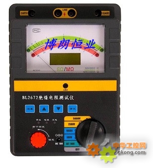

¡ô¸ÅÊö
ÎÒ¹«Ë¾Éú²úµÄBL2672µç×Óʽ¾øÔµµç×è²âÁ¿ÒDzÉÓÃǶÈëʽ¹¤Òµµ¥Æ¬»úʵʱ²Ù×÷ϵͳ£¬³¬±¡ÐÎÕÅË¿±íÍ·ÓëͼÐεãÕóÒº¾§ÏÔʾÆ÷ÍêÃÀ½áºÏ£¬¸ÃϵÁбí¾ßÓжàÖÖµçѹÊä³öµÈ¼¶£¨500V¡¢1000V¡¢2500V¡¢5000V£©¡¢ÈÝÁ¿´ó¡¢¿¹¸ÉÈÅÇ¿¡¢Ö¸ÕëÓëÊý×Öͬ²½ÏÔʾ¡¢½»Ö±Á÷Á½ÓᢲÙ×÷¼òµ¥¡¢×Ô¶¯¼ÆËã¸÷ÖÖ¾øÔµÖ¸±ê(ÎüÊձȡ¢¼«»¯Ö¸Êý)¡¢¸÷ÖÖ²âÁ¿½á¹û¾ßÓзÀµôµç¹¦ÄܵÈÌØµã¡£µç×Óʽ¾øÔµµç×è²âÁ¿ÒÇÊDzâÁ¿´óÈÝÁ¿±äѹÆ÷¡¢»¥¸ÐÆ÷¡¢·¢µç»ú¡¢¸ßѹµç¶¯»ú¡¢µçÁ¦µçÈÝ¡¢µçÁ¦µçÀ¡¢±ÜÀׯ÷µÈ¾øÔµµç×èµÄÀíÏë²âÊÔÒÇÆ÷¡£
¡ô²úÆ·ÌØÐÔ
1¡¢ ÓжàÖÖµçѹÊä³öÑ¡ÔñBL2672(500V¡¢1000V¡¢2500V¡¢5000V)£¬²âÁ¿µç×èÁ¿³Ì·¶Î§¿É´ï0¡«200GΩ£¬µç×èÁ¿³Ì·¶Î§¿É×Ô¶¯×ª»»£¬²¢ÓÐÏàÓ¦µÄָʾ¡£
2¡¢ Á½ÖÖ·½Ê½Í¬²½ÏÔʾ¾øÔµ×èÖµ¡£»úеָÕë²ÉÓ󬱡ÐÍÕÅË¿½á¹¹¿¹ÕðÄÜÁ¦Ç¿¡£»úеָÕëµÄ²ÉÓÿÉÈÝÒ×¹Û²ì¾øÔµµç×èµÄ±ä»¯·¶Î§£¬µãÕóÒº¾§ÆÁµÄ²ÉÓÿÉÖ¸µ¼Óû§²Ù×÷ÒÇ±í²¢¿É¾«È·µÃ³ö²âÁ¿½á¹û¡£
3¡¢ »úе±íÍ·ÓëÒº¾§ÆÁºÏ¶þΪһ¡£Ë«¿Ì¶ÈÏÔʾ£¬Á¿³Ì×Ô¶¯×ª»»¡£²ÊÉ«¿Ì¶ÈÒ×ÓÚ¶Áʶ¡£
4¡¢ ²ÉÓÃǶÈëʽ¹¤Òµµ¥Æ¬»úºÍʵʱ²Ù×÷Èí¼þϵͳ¡£×Ô¶¯»¯³Ì¶È¸ß¡¢¿¹¸ÉÈÅÄÜÁ¦Ç¿£¬ÒÇÆ÷¿É×Ô¶¯¼ÆËãÎüÊձȺͼ«»¯Ö¸Êý£¬ÎÞÐëÈ˹¤¸ÉÔ¤¡£
5¡¢ ²Ù×÷½çÃæÓѺ㬸÷ÖÖ²âÁ¿½á¹û¾ßÓзÀµôµç¹¦ÄÜ£¬¿ÉÁ¬Ðø´æ´¢20´ÎµÄ²âÁ¿½á¹û¡£
6¡¢ ÒDZí²úÉú¸ßѹʱ£¬ÓÐÌáʾÒôÊä³ö¡£
7¡¢ ÄÚÖòÐÁô¸ßѹ·Åµçµç·£¬²âÊÔÍê±Ï¿É×Ô¶¯·Åµô±»²âÉ豸ÉϵIJÐÁô¸ßѹ¡£
  1. ½»Ö±Á÷Á½Óã¬ÅäÖÿɳäµç³ØºÍ½»Á÷ÊÊÅäÆ÷¡£
  2. ÒDZí²ÉÓñãЯʽÉè¼Æ£¬±ãÓÚÒ°Íâ²Ù×÷¡£
  3. ¸ßѹ¶Ì·µçÁ÷≥3mA£¬ÊDzâÁ¿´óÐͱäѹÆ÷¡¢»¥¸ÐÆ÷¡¢·¢µç»ú¡¢¸ßѹµç¶¯»ú¡¢µçÁ¦µçÈÝ¡¢µçÁ¦µçÀ¡¢±ÜÀׯ÷µÈ¾øÔµµç×èµÄÀíÏë²âÊÔÒÇÆ÷¡£

¡ôÒDZíÍâÐÎ
