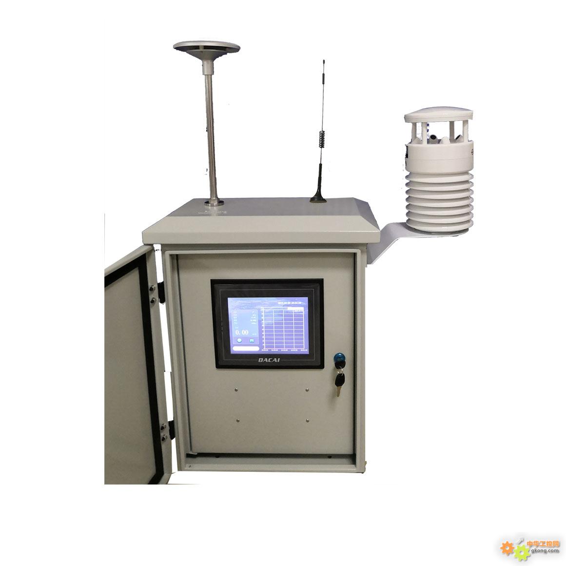

²úÆ·ÌØµã
²ÉÓýø¿Ú¸ß¾«´«¸ÐÆ÷
°Ë´ç¿í´ó´¥ÃþÆÁÏÔʾ
Ä£¿é»¯Éè¼Æ£¬·½±ãÉ豸ά»¤
ÄÚÖÃÁ÷Á¿¼Æ¡¢·Û³¾¹ýÂËÆ÷µÈ×é³ÉµÄ³õ¼¶Ô¤´¦Àíϵͳ
ÏäÌåÄÚÔöÉèºãÎÂÄ£¿é
´øÊý¾Ý´æ´¢¹¦ÄÜ
¾ßÓÐ×Ô¶¯²âÊÔ¡¢×Լ졢¹ÊÕϱ¨¾¯¡¢ÆÁÄ»ÏÔʾ¡¢½á¹û²éѯµÈ¹¦ÄÜ
ÆøÏó¼à²âµ¥Ôª²ÉÓüáʵÄÍÓõij¬Éù²¨·çÉè¼Æ¡¢Õû¸öϵͳÃâά»¤
modbusͨѶ¿ÉÁ¬½ÓÉÏλ»ú£¬¼æÈݳ£¹æ¿ØÖÆÊä³ö·½Ê½£º1·4~20mAµçÁ÷¡¢2·¼ÌµçÆ÷£¬Éù¹â±¨¾¯Êä³ö
È«ÖÐÎIJÙ×÷½çÃæ£¨¿Éת»»³ÉÓ¢ÎĽçÃæ£©
·ÀÓê·À»Ò³¾Íâ¿ÇÉè¼Æ

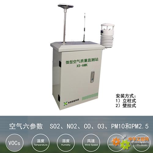

É豸¼ò½é
XS-AMK-VOCÊÇÎÒ¹«Ë¾Éú²úµÄ³§½çVOC»Ó·¢ÐÔÓлú»¯ºÏÎïÔÚÏß¼à²âÒÇ£¬½áºÏ³§½ç»·¾³µÄÌØÊâÐÔ£¬Ôö¼ÓÁË·çÏò¡¢·çËÙ¡¢Î¶ȡ¢Êª¶È¡¢ÆøÑ¹µÈÆøÏóÎå²ÎÊýµÄ¼ì²â£¬¾ßÓÐÎïÁªÍøÔÆÊý¾Ý¹²Ïí¹¦ÄÜ£¬¿ÉÅäÊý´«Ä£¿éͨ¹ýGSMÍø/GPRSÍø£¬ÊµÏÖ¼à²âÒÇÔÆÊý¾ÝÁ¬½ÓÔ¶¾àÀë²¼Íø¼à²â£¬´«Êä²»ÊܾàÀëÏÞÖÆ¡£Òѽ¨Á¢³§½çÊý¾Ý¼à²âÓë·ÖÎöϵͳ£¬½øÒ»²½Ìá¸ß¶Ô³§½ç´óÆøÎÛȾ¼à²âÊý¾ÝµÄ´¦ÀíºÍ¹ÜÀíÄÜÁ¦£¬Îª»·¾³¹æ»®ºÍ»·¾³ÆÀ¼ÛÌṩ¾ö²ßÒÀ¾Ý¡£
