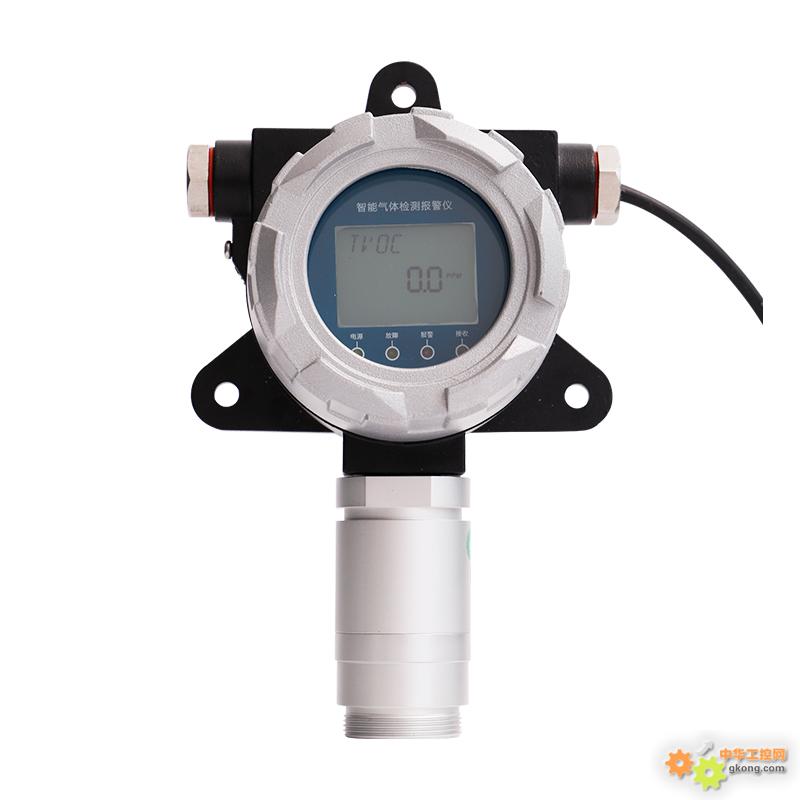

²úÆ·Ãû³Æ£º ¹Ì¶¨Ê½VOC¼ì²âÒÇ
ÐÍ ºÅ£º XS-1000-VOC
¹Ì¶¨Ê½VOC¼ì²âÒÇÊÇÒ»ÖÖ¹âÀë×Ó¼ì²âÆ÷£¬Ö÷ÒªÓÃÓÚ¼ì²â»Ó·¢ÐÔµÄÓлúÆøÌ壬ÀýÈçÌþÀࣨ±½¡¢¼×±½¡¢¶þ¼×±½µÈ£©£¬È©À࣬´¼À࣬ÃÑÀàµÈµÈ¡£Ö÷ÒªÓÃÓÚ¼ì²â»·¾³ÖеÄVOCÆøÌå×ÜŨ¶È¡£Ôö¼ÓÔ¤´¦Àíϵͳ£¨´«¸ÐÆ÷¶Ô»·¾³ÖÊÁ¿ÒªÇ󼫸ߣ¬Ò»¶¨Òª¼ÓÔ¤´¦Àí³ýʪ¡¢³ý³¾¡¢³ýÓÍÖ¬£©£¬Ò²¿ÉÒÔ¼ì²âÓÐ×éÖ¯µÄ·ÏÆøVOC¼à²â¡£
¹Ì¶¨Ê½VOC¼ì²âÒÇ  ÐͺţºXS-1000-VOC
Ò»¡¢¹Ì¶¨Ê½VOC¼ì²âÒǼò½é
¹Ì¶¨Ê½VOC¼ì²âÒÇÊÊÓÃÓÚ¸÷ÖÖ¹¤Òµ»·¾³¼°ÌØÊâ»·¾³ÖеÄVOCŨ¶ÈÁ¬ÐøÔÚÏß¼ì²â£¬±¾ÒÇÆ÷²ÉÓÃÔ­×°½ø¿Ú¹âÀë×ÓPID´«¸ÐÆ÷ºÍ΢¿ØÖÆÆ÷¼¼Êõ£¬ÐźÅÎȶ¨£¬¾«¶È¸ß¡¢Öظ´ÐԺ㬷À±¬½ÓÏß·½Ê½ÊÊÓÃÓÚ¸÷ÖÖΣÏÕ³¡Ëù¡£ÒÇÆ÷¼æÈݸ÷ÖÖ±¨¾¯¿ØÖÆÆ÷¡¢PLC¡¢DCS µÈ¿ØÖÆÏµÍ³£¬¿ÉÒÔʵÏÖÔ¶³Ì¼à¿Ø£¬Ô¶³Ì±¨¾¯£¬µçÄÔÊý¾Ý´æ´¢µÈ¹¦ÄÜ¡£
¶þ¡¢¹Ì¶¨Ê½VOC¼ì²âÒDzúÆ·ÌØµã
  1. ½á¹¹Ä£¿é»¯¡¢Î¬»¤·½±ã£¬½ÓÏß°²×°¼òµ¥
  2. ÖÇÄÜ´«¸ÐÆ÷ƽ̨£¬¿É¼´²å¼´Óã¬ÎÞÐèÏÖ³¡±ê¶¨
  3. ¿ìËÙÏìÓ¦¡¢²âÁ¿¾«¶È¸ß£¬ÔËÐÐÎȶ¨µÄ¼ì²âÒÇÆ÷
  4. ·á¸»µÄ´«¸ÐÆ÷Á¿³ÌÑ¡Ôñ£¬¿ÉÒÔÂú×ã¿Í»§µÄÒªÇó
  5. ÒDZí¾ßÓÃ4-20MAÊä³ö»òRS-485Êä³ö
  6. ¿ÉÒÔÓëXSϵÁб¨¾¯Ö÷»ú×éÍøÊ¹Óã»Ã¿µãÆ¥Å䣬µãµã×éºÏ
  7. ²úÆ·Ñ¡Ôñ²ÄÖʾ«Á¼£¬¾ßÓÐÁ¼ºÃµÄÃÜ·âÐÔ£¬·À¸¯ÐÔ£¬·À±¬ºÍ¿¹´Å¸ÉÈÅÇ¿
  8. ²ÉÓøô±¬¼æ±¾°²ÐÍÉè¼Æ
Èý¡¢¹Ì¶¨Ê½VOC¼ì²âÒÇÖ÷ÒªÓ¦ÓÃÁìÓò
ʯÓÍ¡¢Ê¯»¯¡¢Ò±½ð¡¢»¯¹¤¡¢Ïû·À¡¢È¼Æø¡¢»·±£¡¢µçÁ¦¡¢Í¨Ñ¶¡¢ÔìÖ½£¬Ó¡È¾¡¢ÎÛË®´¦Àí¡¢Ê³Æ·ÄðÔì¡¢¿ÆÑС¢½ÌÓý¡¢¹ú·À
  • ¹Ì¶¨Ê½VOC¼ì²âÒÇÐÔÄÜÖ¸±ê
±»²âÆøÌ壺TVOC »Ó·¢ÐÔÓлúÎï
¼ì²âÔ­Àí£ºPID ¹âÀë×Ó
²ÉÑù·½Ê½£ºÀ©É¢Ê½»ò¹ÜµÀʽ
Á¿³Ì£º0-20ppm¡¢0-100ppm¡¢0-200ppm¡¢0-2000ppm¡¢0-10000ppm¿ÉÑ¡
·Ö±æÂÊ£º0.01ppm¡¢0.1ppm¡¢1ppm
¾«¶È£º3%FS
ÏìӦʱ¼ä£º<3s
ÐźÅÊä³ö£º4-20mAºÍRS485£¬2·¿ª¹ØÁ¿
¹©µç£º24VDC
·À±¬µÈ¼¶£ºEXD II CT6
·À»¤µÈ¼¶£ºIP66
¹¤×÷ζȣº-20¡æ~+50¡æ
¹¤×÷ʪ¶È£º0-95%RH£¨ÎÞÀäÄý£©
²Ä    ÖÊ£ºADC12ÂÁºÏ½ð/316²»Ðâ¸Ö
Ö´Ðбê×¼£ºGB15322.1-2003¡¢GB3836.1-2010¡¢GB3836.2-2010¡¢GB3836.4-2010
µçÆø½Ó¿Ú£ºM20*1.5ÄÚÂÝÎÆ£¬¿ÉÑ¡ G3/4¡¢G1/2¡¢1/2NPT¡¢3/4NPT
ÖØ    Á¿£º2kg
³ß    ´ç£º195mm*178mm*90mm£¨MAX£©
