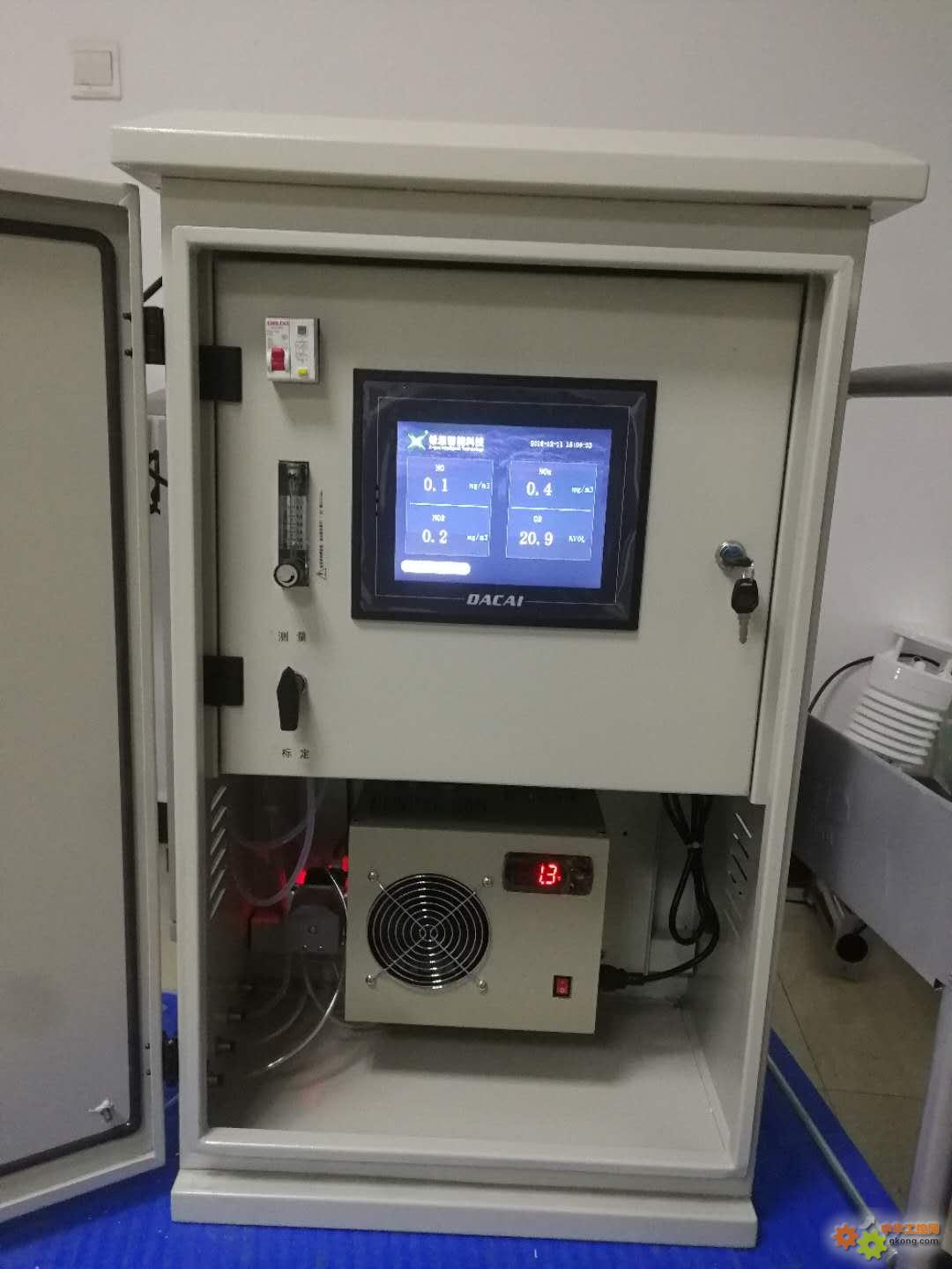

  • µªÑõ»¯ÎïÎ²Æø·ÖÎöÒDzúÆ·ÌØµã
1¡¢²ÉÓõ绯ѧ´«¸ÐÆ÷£¬ADC²ÉÓÃ24λ¸ß¾«¶ÈоƬ
2¡¢°Ë´ç¿í´ó´¥ÃþÆÁÏÔʾ
3¡¢ÄÚÖÃNO¡¢NO2¡¢O2·ÖÎöÄ£¿é
4¡¢ÄÚÖÃÁ÷Á¿¼Æ¡¢·Û³¾¹ýÂËÆ÷¡¢ÀäÄýÆ÷µÈ×é³ÉµÄÔ¤´¦Àíϵͳ
5¡¢´øÊý¾Ý´æ´¢¹¦ÄÜ£¬ÄÚÖÃ8G´æ´¢¿¨£¨ÄÜ´æ´¢3ÄêÒÔÉÏÀúÊ·Êý¾Ý£©
6¡¢¾ßÓÐ×Ô¶¯²âÊÔ¡¢×Լ졢¹ÊÕϱ¨¾¯¡¢ÆÁÄ»ÏÔʾ¡¢½á¹û²éѯµÈ¹¦ÄÜ
7¡¢modbusͨѶ¿ÉÁ¬½ÓÉÏλ»ú£¬¼æÈݳ£¹æ¿ØÖÆÊä³ö·½Ê½£º1·4~20mAµçÁ÷¡¢2·¼ÌµçÆ÷£¬Éù¹â±¨¾¯Êä³ö
8¡¢È«ÖÐÎIJÙ×÷½çÃæ£¨¿Éת»»³ÉÓ¢ÎĽçÃæ£©
9¡¢·ÀÓê·À»Ò³¾Íâ¿ÇÉè¼Æ

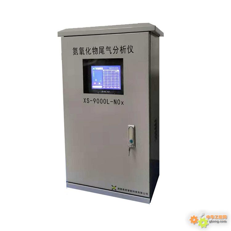

XS-9000L-NOXÐ͵ªÑõ»¯ÎïÎ²Æø·ÖÎöÒÇÊÇÎÒ¹«Ë¾¸ù¾ÝÈ¼Æø¹øÂ¯ÖÎÀí¡¢µÍµª¸ÄÔìµÄÒªÇó£¬ÅäºÏ½ü10ÄêµÄÆøÌå¼ì²âÉ豸Ñз¢¡¢Éè¼Æ¡¢Éú²ú¾­ÑéÌØÍÆ³öµÄÒ»¿îµªÑõ»¯ÎïÎ²ÆøÔÚÏß¼à²âÒÇ£¬È«Ììºò24Сʱʵʱ¼à²âÈ¼Æø¹øÂ¯¡¢È¼ÉÕ·¨VOCÖÎÀíµÈÏà¹ØÉè±¸Î²ÆøÖеªÑõ»¯ÎïÅÅ·ÅʵʱŨ¶È¡£
Èý¡¢µªÑõ»¯ÎïÎ²Æø·ÖÎöÒǼ¼Êõ²ÎÊý
´«¸ÐÆ÷ÀàÐÍ   µç»¯Ñ§
²âÁ¿Òò×Ó    ±êÅ䣺µªÑõ»¯Îï(Ò»Ñõ»¯µª¡¢¶þÑõ»¯µª)¡¢
±êÅ䣺ÑõŨ¶È£¨O2£©
Ñ¡Å䣺ζȡ¢Ñ¹Á¦¡¢Á÷ËÙ¡¢Êª¶È
Ñ¡Å䣺¶þÑõ»¯Áò
Ñ¡Å䣺¿ÅÁ£Îï
²ÉÑù·½Ê½    ±ÃÎüʽ£¨µÂ¹úKNFÑÌÆø·ÖÎöÒÇרÓ÷À¸¯Õæ¿Õ±Ã£©
ÆøÌåÁ¿³Ì    0-100mg/m3
¾« È· ¶È    ≤±3%FS
·Ö ±æ ÂÊ     0.1mg/M3
ÖØ ¸´ ÐÔ    ≤±2 % F S
ÁãµãÆ¯ÒÆ    ≤±2 % F S / 6 h
¿ç¶ÈÆ¯ÒÆ    ≤±5 % F S / 6 h
ÏìӦʱ¼ä    T90<30s
Êä³öÐźŠ   RS485Êý×ÖÐźÅ(Á¬½ÓDTU¡¢Êý²ÉÒÇ»ò¸öÈ˵çÄÔ)£»
4 - 2 0 m A Ä£ÄâÐźÅ(Á¬½Ó¾ß±¸4 - 2 0 m A½Ó¿ÚµÄP L C¼°ÆäËüÉÏλ»ú)
212ЭÒéGPRSÎÞÏß´«Êä¶Ô½Ó»·±£¾Ö£¨Ñ¡Å䣩
´¥µãÈÝÁ¿    30VDC/1A
ÎïÀí°´¼ü    ´¥ÃþÆÁ²Ù×÷
¿ØÖÆÊä³ö     ¶þ¼¶±¨¾¯¼ÌµçÆ÷
ÏԠʾ ÆÁ     »úÏä 8´ç×é̬¹¤Òµ´®¿ÚÆÁ
³ß    ´ç     880MM*480MM*320MM

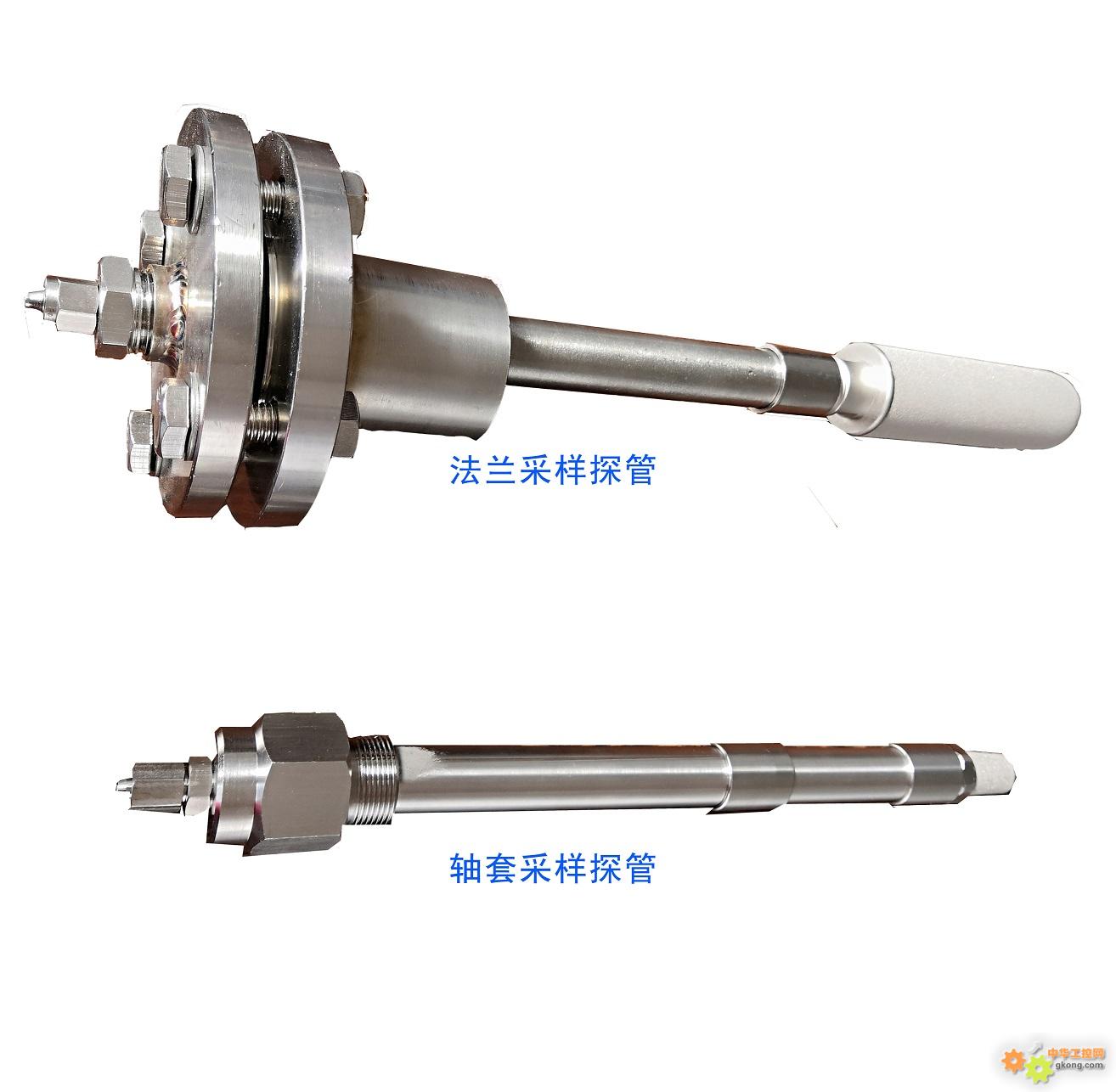

Åä¼þ         ÑÌÆø²ÉÑù̽ͷ
