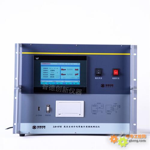

ÐÍ ºÅ£º ZJD-87
ZJD-87¸ßѹ×Ô¶¯¿¹¸ÉÈž«ÃÜÐͽéµç³£Êý½éËð²âÊÔÒÇ
Ò»¡¢·ûºÏ±ê×¼£º
GB/T1409²âÁ¿µçÆø¾øÔµ²ÄÁÏÔÚ¹¤Æµ¡¢ÒôƵ¡¢¸ßƵ(°üÀ¨Ãײ¨²¨³¤´æÄÚ)ϵçÈÝÂʺͽéÖÊËðºÄÒòÊýµÄÍÆ¼ö·½·¨;
GB/T5654-2007ÒºÌå¾øÔµ²ÄÁÏÏà¶ÔµçÈÝÂÊ¡¢½éÖÊËðºÄÒòÊýºÍÖ±Á÷µç×èÂʵIJâÁ¿;
¶þ¡¢²úÆ·¸ÅÊö£º
    ZJD-87¸ßѹ×Ô¶¯¿¹¸ÉÈž«ÃÜÐͽéµç³£Êý½éËð²âÊÔÒÇÊÇÒ»¿îרΪʵÑéÊÒÑÐÖÆµÄ¸ß¾«¶È¸ßѹµçÇÅ£¬Í»ÆÆÁË´«Í³µÄµçÇŲâÁ¿·½Ê½£¬²ÉÓÃ±äÆµµçÔ´¼¼Êõ£¬ÀûÓõ¥Æ¬»úºÍÏÖ´ú»¯µç×Ó¼¼Êõ½øÐÐ×Ô¶¯ÆµÂʱ任¡¢Ä£/Êýת»»ºÍÊý¾ÝÔËË㣻´ïµ½¿¹¸ÉÈÅÄÜÁ¦Ç¿¡¢²âÊÔËٶȿ졢¾«¶È¸ß¡¢È«×Ô¶¯Êý×Ö»¯¡¢²Ù×÷¼ò±ã£»µçÔ´²ÉÓôó¹¦ÂÊ¿ª¹ØµçÔ´£¬Êä³ö45HzºÍ55Hz´¿ÕýÏÒ²¨£¬×Ô¶¯¼Óѹ£¬¿ÉÌṩ×î¸ß10ǧ·üµÄµçѹ¡£ËùÓнӲå¼þ¾ùΪÆÁ±Î½Ó²å¿Ú£¬ÓÐЧµÄÌá¸ßÁËÒÇÆ÷µÄ²âÁ¿¾«¶È£¬ÊÇרΪʵÑéÊÒ²âÊÔÑÐÖÆµÄÐÂÐͽéµç³£Êý½éËð²âÊÔÒDzâÊÔÒÇ£¬¹ã·ºµÄÓ¦Óõ½¾øÔµ²ÄÁϵĽéÖÊËðºÄºÍ½éµç³£ÊýµÄ²âÊÔ¡£¿ÉÒÔÔÚ¼Óѹ£¬¼ÓΣ¬Õæ¿ÕÌõ¼þÏ£¬ÔÚ¹¤Æµµçѹ϶Ը÷Àà¹ÌÌå¾øÔµ²ÄÁÏ£¨Èç¾Û±½ÒÒÏ©£¬¾Û±ûÏ©£¬µçÈÝÖ½µÈ£©µÄÊÔÆ·×÷½éÖÊËðºÄÒòÊý£¬Ïà¶Ô½éµç³£Êý²âÁ¿¡£ÔÚÍâ½ÓµçÁ÷»¥¸ÐÆ÷£¨Á¿³ÌÀ©Õ¹Æ÷£©1000/1=1000±¶µÄÇé¿öÏ£¬¿ÉÒÔ²âÊÔ´óµçÁ÷¸ßѹµçÆ÷µÄ½éËðÖµ¡£
Èý¡¢¼¼ÊõÖ¸±ê
׼ȷ¶È£º Cx:±£¨¶ÁÊý×0.5%+0.5pF£©£»tgδ:±£¨¶ÁÊý×0.5%+0.00005£©£»
µçÈÝÁ¿·¶Î§£ºÄÚÊ©¸ßѹ£º3pF¡«60000pF/10kV£»60pF¡«1μF/0.5kV£»
ÍâÊ©¸ßѹ£º3pF¡«1.5μF/10kV£»60pF¡«30μF/0.5kV£»
*·Ö±æÂÊ£º×î¸ß0.001pF£¬4λÓÐЧÊý×Ö£»
*½éµç³£Êýε²âÊÔ·¶Î§£º0-200£»
*½éµç³£Êýε׼ȷ¶È£º0.5%
*½éÖÊËðºÄtgδ²âÊÔ·¶Î§£º²»ÏÞ£¬
*½éÖÊËðºÄtgδ·Ö±æÂÊ£º0.000001£¬µçÈÝ¡¢µç¸Ð¡¢µç×èÈýÖÖÊÔÆ·×Ô¶¯Ê¶±ð¡£
ÊÔÑéµçÁ÷·¶Î§£º5μA¡«5A£»
*ÄÚÊ©¸ßѹ£ºÉ趨µçѹ·¶Î§£º0.5¡«10kV £»
×î´óÊä³öµçÁ÷£º200mA£»
*Éý½µÑ¹·½Ê½£ºµçÑ¹ËæÒâÉèÖᣱÈÈç5123V¡£
ÊÔÑ鯵ÂÊ£º 40-70Hzµ¥ÆµËæÒâÉèÖᣱÈÈç48.7Hz.
ƵÂʾ«¶È£º±0.01Hz
ÍâÊ©¸ßѹ£º½ÓÏßʱ×î´óÊÔÑéµçÁ÷5A£¬¹¤Æµ»ò±äƵ40-70Hz
²âÁ¿Ê±¼ä£ºÔ¼30s£¬Óë²âÁ¿·½Ê½Óйأ»
¸ßѹµç¼«Ö±¾¶Óë±íÃæ»ý£º¡é98mm(75.43cm2)
²âÁ¿µç¼«Ö±¾¶Óë±íÃæ»ý£º ¡é50 mm(19.63cm2)
µç¼«²ÄÁÏ£º²»Ðâ¸Ö1Cr13Ni9Ti
µç¼«¹¤×÷Ãæ£º¾«ÃæÃæÄ¥
µç¼«¼ä¾à£º²»´óÓÚ5 mm
µç¼«¼ÓÈȹ¦ÂÊ£º >2*500W
µç¼«×î¸ßζȣº180°
¼ÓÈÈʱ¼ä£º30·ÖÖÓ
µç¼«Ñ¹Á¦£º0~1.0MpaÁ¬Ðø¿Éµ÷
×î´ó²âÁ¿µçѹ£º2000V£¬50Hz
Õæ¿Õ¶È £ºµç¼«¿É³éÕæ¿ÕÖÁ3*10-2 Mpa
ÊäÈëµçÔ´£º180V¡«270VAC£¬50Hz±1%£¬Êеç»ò·¢µç»ú¹©µç
*¼ÆËã»ú½Ó¿Ú£º±ê×¼RS232½Ó¿Ú£¬UÅ̲å¿Ú(×Ô¶¯UÅÌ´æ´¢Êý¾Ý)¡£
´òÓ¡»ú£ºÎ¢ÐÍÈÈÃô´òÓ¡»ú
»·¾³Î¶ȣº-10¡æ¡«50¡æ
Ïà¶Ôʪ¶È£º<90%
Ö÷»úÍâÐγߴ磺490*520*360£¨³¤¿í¸ßmm£©
µç¼«³ß´ç£º400*300*400£¨³¤¿í¸ßmm£©
ÒÇÆ÷ÖØÁ¿£º35kg
ËÄ¡¢²úÆ·ÓÅÊÆ£º
*¿¹¸ÉÈÅÄÜÁ¦Ç¿¡¢²âÊÔËٶȿ졢¾«¶È¸ß¡¢È«×Ô¶¯Êý×Ö»¯¡¢²Ù×÷¼ò±ã£»
*ÔÚ²âÊÔ¾øÔµ²ÄÁÏʱ¿ÉÒÔÖ±½ÓÏÔʾÏà¶Ô½éµç³£ÊýεºÍ½éÖÊËðºÄtgδ£»
*50±0.1Hzµ½50±10Hz×Ô¶¯Ë«±äÆµËæÒâÉèÖã»
*60±0.1Hzµ½60±10Hz×Ô¶¯Ë«±äÆµËæÒâÉèÖã»
*Íâ½ÓÏß·ʱ¿ÉÒÔÁ¬½ÓÁ¿³ÌÀ©Õ¹Æ÷£¬µçÁ÷¿É´ï¼¸Ç§°²Åࣻ
*¿ÉÒÔÔÚ¼Óѹ£¬¼ÓΣ¬Õæ¿ÕÌõ¼þϲâÊÔ£»
Îå¡¢²úÆ·ÌØµã£º
1¡¢ÒÇÆ÷²ÉÓøµÁ¢Ò¶±ä»»Êý×ÖÂ˲¨¼¼Êõ£¬²âÁ¿µçÈÝ¡¢½éÖÊËðºÄ¼°ÆäËü²ÎÊý¡£²âÊÔ½á¹û¾«¶È¸ß£¬±ãÓÚʵÏÖ×Ô¶¯»¯²âÁ¿¡£
2¡¢ÒÇÆ÷²ÉÓÃÁË±äÆµ¼¼ÊõÀ´Ïû³ýÏÖ³¡50Hz¹¤Æµ¸ÉÈÅ£¬¼´Ê¹ÔÚÇ¿µç´Å¸ÉÈŵĻ·¾³ÏÂÒ²ÄܲâµÃ¿É¿¿µÄÊý¾Ý¡£
3¡¢Ê¹ÓÃÈ«´¥Ãþ³¬´óÒº¾§ÏÔʾÆ÷£¬²Ù×÷¼òµ¥¡£È«´¥ÃþÒº¾§ÏÔʾÆÁ£¬³¬´óȫͼÐβÙ×÷½çÃæ£¬Ã¿¹ý³Ì¶¼·Ç³£ÇåÎúÃ÷ÁË£¬²Ù×÷ÈËÔ±²»ÐèÒª¶îÍâµÄרҵÅàѵ¾ÍÄÜʹÓá£ÇáÇá´¥Ãþ¾ÍÄÜÍê³ÉÕû¸ö¹ý³ÌµÄ²âÁ¿¡£
4¡¢´æ´¢Êý¾Ý£ºÄÚ²¿Å䱸ÓÐÈÕÀúоƬºÍ´óÈÝÁ¿´æ´¢Æ÷£¬Äܽ«¼ì²â½á¹ûËæÊ±±£´æ£¬ËæÊ±¿ÉÒԲ鿴ÀúÊ·¼Ç¼£¬²¢¿ÉÒÔ´òÓ¡Êä³ö¡£µ±Ç°Ê±¼äºÍ´æ´¢Ê±¼ä¶¼ÄÜËæÊ±ÏÔʾºÍ´òÓ¡¡£
5¡¢¿ÆÑ§ÏȽøµÄÊý¾Ý¹ÜÀí£ºÒÇÆ÷Êý¾Ý¿ÉÒÔͨ¹ýUÅ̵¼³ö£¬¿ÉÔÚÈÎÒâһ̨PC»úÉÏͨ¹ýרÓÃÈí¼þ£¬²é¿´ºÍ¹ÜÀíÊý¾Ý¡£
6¡¢ÒÇÆ÷²Ù×÷¼ò±ã£¬²âÁ¿¹ý³ÌÓÉ΢´¦ÀíÆ÷¿ØÖÆ£¬Ö»ÒªÑ¡ÔñºÃºÏÊʵIJâÁ¿·½Ê½£¬Êý¾ÝµÄ²âÁ¿¾Í¿ÉÔÚ΢´¦ÀíÆ÷¿ØÖÆÏÂ×Ô¶¯Íê³É¡£
7¡¢Ò»Ì廯»úÐÍ£¬ÄÚ¸½±ê×¼µçÈݺ͸ßѹµçÔ´£¬±ãÓÚÏÖ³¡²âÊÔ£¬¼õÉÙÏÖ³¡½ÓÏß¡£
8¡¢ÒÇÆ÷²âÁ¿×¼È·¶È¸ß£¬¿ÉÂú×ãÓͽéËð²âÁ¿ÒªÇó£¬Òò´ËÖ»ÐèÅ䱸±ê×¼Óͱ­£¬ºÍרÓòâÊÔÏß¼´¿ÉʵÏÖÓͽéËð²âÁ¿¡£Ò²¿ÉÅ䱸רÓõ缫À´²âÊÔ¹ÌÌå¾øÔµ²ÄÁϵĽéËðÖµºÍ½éµç³£Êý¡£
9¡¢Äܹ»Ê¶±ðÍâ½Ó¸ßѹµçԴƵÂÊ40Hz~70Hz£¬ÔÊÐíÓù¤ÆµµçÔ´»ò´®Á¬Ð³ÕñµçÔ´×ö´óÈÝÁ¿¸ßµçѹ½éËðÊÔÑé¡£
10¡¢×Ô´øÈÈÃô´òÓ¡»ú¿É´òÓ¡Êä³ö£¬´øÈÕÀúʱÖÓ,·½±ãÓû§³ö²âÊÔ±¨¸æ, ´øÓÐUÅÌÊä³ö¡£
11¡¢½ÓµØ±£»¤¹¦ÄÜ£¬µ±ÒÇÆ÷²»½ÓµØÏß»ò½ÓµØ²»Á¼Ê±£¬ÒÇÆ÷²»½øÈëÕý³£³ÌÐò£¬²»Êä³ö¸ßѹ¡£¹ýÁ÷±£»¤¹¦ÄÜ£¬ÔÚÊÔÆ·¶Ì·»ò»÷´©Ê±ÒÇÆ÷²»ÊÜË𻵡£
