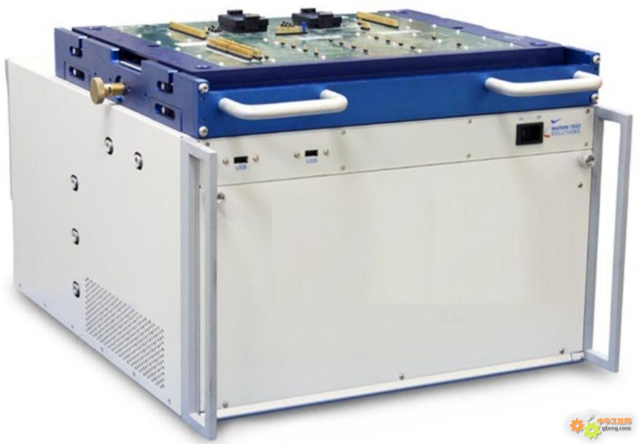

²úÆ·Ãû³Æ£º °ëµ¼Ìå·ÖÁ¢Æ÷¼þ¾²Ì¬²ÎÊý²âÊÔÒÇ
ÐÍ ºÅ£º STD2000
Æ· ÅÆ£º ÌìÊ¿Á¢
°ëµ¼Ìå·ÖÁ¢Æ÷¼þ¾²Ì¬²ÎÊý²âÊÔÒÇϵͳ

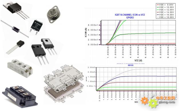

ÉÂÎ÷ÌìÊ¿Á¢¿Æ¼¼ÓÐÏÞ¹«Ë¾/STD2000/°ëµ¼Ìå·ÖÁ¢Æ÷¼þ²ÎÊý²âÊÔÒÇϵͳ¿ÉÒÔ²âÊÔSi,SiC,GaN & IGBT¡¢Mosfet¡¢Diode¡¢BJT¡¢SCR¡¢OC/¹âñî......µÈºÜ¶àµç×ÓÔªÆ÷¼þµÄ¾²Ì¬Ö±Á÷²ÎÊýºÍIVÇúÏߣ¨Èç»÷´©µçѹV(BR)CES/V(BR)DSs¡¢Â©µçÁ÷ICEs/lGEs/IGSs/lDSs¡¢ãÐÖµµçѹ/VGE(th)¡¢¿ªÆôµçѹ/VCE(on)¡¢¿çµ¼/Gfe/Gfs¡¢Ñ¹½µ/Vf¡¢ÄÚ×èRds(on)£©ÒÔ¼°IVÌØÐÔÇúÏßµÈ

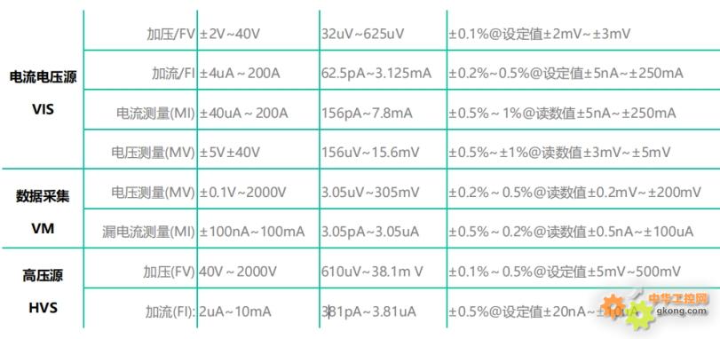

Ò»¼ü¼ÓÈÈ£ºÒ»¼üÂö³å×Ô¶¯¼ÓÈÈÖÁ+130°C£¬ºÄʱ< 1s
¸ßѹԴ£º1400V (Ñ¡Åä 2KV)
¸ßÁ÷Ô´£º40A(Ñ¡Åä 100A,200A,500A)
Çý¶¯µçѹ£º20V/10uA~100mA (Ñ¡Åä+40V/10uA~100mA)
©µç²âÁ¿£º1nA ©µç³ÖÐøÎȶ¨²âÁ¿£¬±íÏÖ³öÓÅÐãµÄÒ»ÖÂÐÔºÍÎȶ¨ÐÔ£¬¸üÓÐ1.5pA ΢µçÁ÷²âÁ¿Ñ¡¼þ¿É¹©Ñ¡Ôñ¡£
¸ß¾«¶È£º16 λ ADC/DAC£¬0.1%¾«¶È£¬1M/S²ÉÑùËÙÂÊ

01. Diode / ¶þ¼«¹Ü£¨ÎÈѹ¡¢Ë²Ì¬¡¢Èý¶ËÐ¤ÌØ»ù¡¢TVS¡¢ÕûÁ÷ÇÅ¡¢ÈýÏàÕûÁ÷ÇÅ£©
02. BJT / Èý¼«¹Ü
03. Mosfet & JFET / ³¡Ð§Ó¦¹Ü
04. SCR / ¿É¿Ø¹è£¨µ¥Ïò/Ë«Ïò£©
05. IGBT / ¾øÔµÕ¤Ë«¼«´ó¹¦Âʾ§Ìå¹Ü
06. OC / ¹âñî
07. Relay / ¼ÌµçÆ÷
08. Darlington tube / ´ïÁÖ¶ÙÕóÁÐ
09. Current sensor/µçÁ÷´«¸ÐÆ÷
10. »ù×¼IC(TL431)
11. µçѹ¸´Î»IC
12. ÎÈѹÆ÷£¨Èý¶Ë/ËĶˣ©
13. Èý¶Ë¿ª¹Ø¹¦ÂÊÇý¶¯Æ÷
14. Æß¶Ë°ëÇÅÇý¶¯Æ÷
15. ¸ß±ß¹¦ÂÊ¿ª¹Ø
16. µçѹ±£»¤Æ÷£¨µ¥×é/Ë«×飩
17. ¿ª¹ØÎÈѹ¼¯³ÉÆ÷
18. ѹÃôµç×è
19.µçѹ¼à¿ØÆ÷
