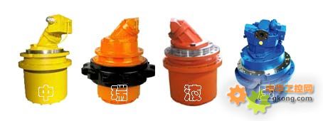

产品名称: GFB系列回转减速机
型  号: GFB系列
价  格:
●GFB※※型液压回转装置技术参数
型号
Type / version
输出转矩
Output torque
传动比 Ratio
i
液压马达
Hydraulic motor
输出齿轮参数
Output Gear Parameter
m×z×x×b
减速机重量
Weight without motor (approx.)
Kg
挖掘机
excavator
起重机
crane
GFB 17 T3
7700
12000
78.95
A2FE45/61W-VZL
8×14×0.5×70
140
89.23
A2FE56/61W-VZL
10×12×0.35×85
103.62
A2FE63/61W-VZL
12×13×0.5×85
GFB 26 T2
10000
16500
37.80
A2FE56/61W-VZL
10×15×0.5×110
140
43.87
A2FE63/61W-VZL
12×13×0.5×90
51.22
*A2FE80/61W-VZL
14×15×0.5×120
63.00
*A2FE90/61W-VZL
16×12×0.5×100
GFB 36 T2
16000
26000
24.0
A2FE56/61W-VZL
10×15×0.5×110
160
A2FE63/61W-VZL
12×13×0.5×90
12×16×0.5×120
28.93
*A2FE80/61W-VZL
14×15×0.5×120
*A2FE90/61W-VZL
16×12×0.5×100
GFB 36 T3
16000
26000
67.96
A2FE45/61W-VZL
10×15×0.5×110
180
80.36
A2FE56/61W-VZL
12×13×0.5×90
101.02
A2FE63/61W-VZL
12×16×0.5×120
117.55
*A2FE80/61W-VZL
14×15×0.5×120
132.00
*A2FE90/61W-VZL
16×12×0.5×100
GFB 40 T2
18000
29000
36.46
A2FE80/61W-VZL
12×15×0.5×100
210
42.04
A2FE90/61W-VZL
49.28
*A2FE107/61W-VZL
14×13×0.5×100
60.13
*A2FE125/61W-VZL
GFB 60 T2
25000
45000
34.03
A2FE107/61W-VZL
16×13×0.5×95
390
A2FE125/61W-VZL
16×16×0.5×170
40.41
*A2FE160/61W-VZL
18×14×0.5×170
*A2FE180/61W-VZL
20×14×0.5×190
GFB 60 T3
25000
45000
87.46
A2FE80/61W-VZL
16×13×0.5×95
420
106.53
120.83
A2FE90/61W-VZL
16×16×0.5×170
140.86
*A2FE107/61W-VZL
18×14×0.5×170
170.89
*A2FE125/61W-VZL
20×14×0.5×190
GFB系列回转减速机型号
GFB 17 T3 GFB 26 T2 GFB 36 T2 GFB 36 T3 GFB 40 T2 GFB 60 T2 GFB 60 T3
