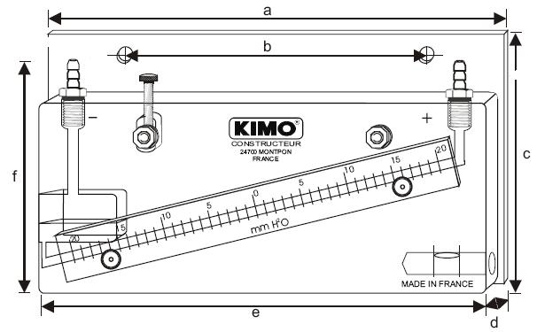

²úÆ·¹æ¸ñ£º
    ²úÆ·Ñ¡ÐÍ
     ÐͺÅ
    ²âÁ¿·¶Î§
    ¿Ì»­ÁéÃô¶È
     ·Ö±æÂÊ
    mm CE
    Pa
    In . WG
    1 mm CE  »ò 10 Pa
    0.1 In . WG
    KX 202
    20-0-20
    200-0-200
    0.8-0-0.8
    4 mm
    10.16 mm
     1 mm CE »ò 10 Pa »ò 0.02  In. WG
    KX 205
    25-0-25
    250-0-250
    1-0-1
    3 mm
    7.62 mm
    KX 303
    30-0-30
    300-0-300
    1.2-0-1.2
    3 mm
    7.62 mm
    KX 404
    40-0-40
    400-0-400
    1.6-0-1.6
    2.5 mm
    6.36 mm
    KX 505
    50-0-50
    500-0-500
    2-0-2
    2.5mm
    6.36 mm
    ²úÆ·³ß´ç
    ÐͺÅ
    a
    b
    c
    d
    e
    f
    ÖØÁ¿
    KX 202
    192 mm
    124 mm
    105 mm
    25 mm
    188 mm
    80 mm
    420 g
    KX 205
    178 mm
    110 mm
    117 mm
    25 mm
    174 mm
    109 mm
    420 g
    KX 303
    206 mm
    138 mm
    129 mm
    25 mm
    202 mm
    104 mm
    560 g
    KX 404
    219 mm
    151 mm
    154 mm
    25 mm
    215 mm
    129 mm
    660 g
    KX 505
    265 mm
    197 mm
    175 mm
    25 mm
    269 mm
    150 mm
    920 g
