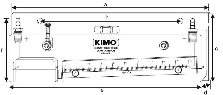

    ²úÆ·³ß´ç
    ÐͺÅ
    a
    b
    c
    d
    e
    f
    g
    HP 5
    184 mm
    116 mm
    80 mm
    30 mm
    180 mm
    71 mm
    340 mm
    HP 10
    234 mm
    166 mm
    80 mm
    30 mm
    230 mm
    71 mm
    430 mm
    HP 15
    234 mm
    166 mm
    80 mm
    30 mm
    230 mm
    71 mm
    430 mm
