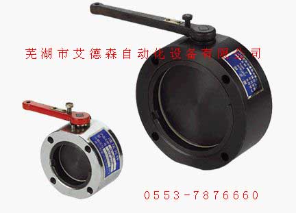

| JZFÐͽØÖ¹·§ |
ͼÐηûºÅ
ÐͺÅ˵Ã÷

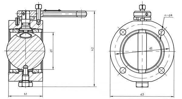

 ¢Ù ²úÆ·´úºÅ£ºJZF½ØÖ¹·§ ¢Ú ¹«³ÆÍ¨¾¶£º40¡¢60¡¢65¡¢80¡¢100mm ¢Û Á¬½ÓÐÎʽ£ºF-·¨À¼Ê½ ÍâÐγߴç
ÐͺŠ|
h1 |
h2 |
d1 |
d2 |
d3 |
n-d4 |
Á½¶ËÃÜ·âÐÎʽ |
JZF-40FA |
40 |
90 |
§¶44 |
§¶64 |
§¶75 |
4-§¶7 |
Á½¶ËÆ½Ãæ¡¢ÎÞOÐÎȦ¹µ²Û |
JZF-40FB |
40 |
90 |
§¶44 |
§¶70 |
§¶81 |
4-§¶7 |
Á½¶Ë´ø56¡Á3.5 OÐÎȦ¹µ²Û |
JZF-60F |
45 |
115 |
§¶68 |
§¶92 |
§¶105 |
4-§¶7 |
Á½¶ËÆ½Ãæ¡¢ÎÞOÐÍȦ¹µ²Û |
JZF-65F |
50 |
150 |
§¶68 |
§¶108 |
§¶135 |
6-§¶11 |
JZF-80F |
50 |
150 |
§¶91 |
§¶120 |
§¶135 |
4-§¶9 |
JZF-100F |
55 |
175 |
§¶116 |
§¶148 |
§¶165 |
4-§¶9 |
Á½¶ËÆ½Ãæ¡¢ÎÞOÐÍȦ¹µ²Û | | | |
