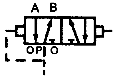

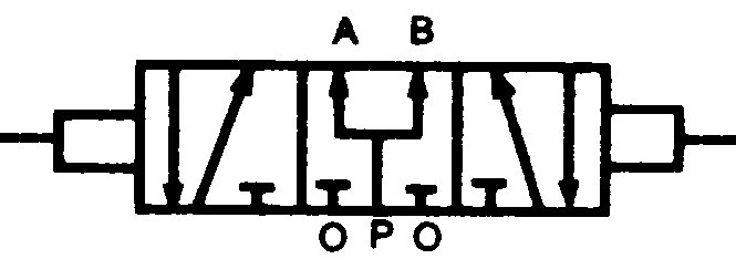

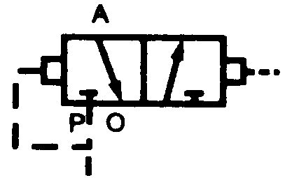

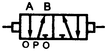

QQKϵÁÐÆø¿Ø»»Ïò·§
QQK-2452        QQK-2632b       QQK-2332        QQK-1342T
QQK-2352        QQK-1362T       QQK-2642b       QQK-2662a
QQK-2462        QQK-2652b       QQK-1362        QQK-2532c
QQK-1422        QQK-2522c       QQK-2622c       QQK-1352T
QQK-1432        QQK-2542c       QQK-2632c       QQK-2662b
QQK-1442        QQK-2552c       QQK-2642c       QQK-1342
QQK-1452        QQK-2562c       QQK-2652c       QQK-2622b
QQK-1462        QQK-2622a       QQK-2662c       QQK-2322
QQK-1322T       QQK-1322        QQK-2422        QQK-2632a
QQK-2432        QQK-2642a       QQK-2342        QQK-1352
QQK-1332T       QQK-1332        QQK-2442        QQK-2652a
QQK-2362

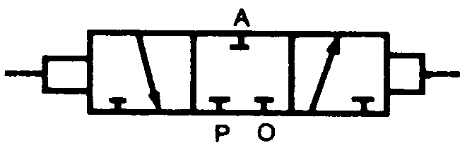

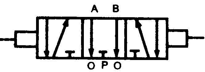

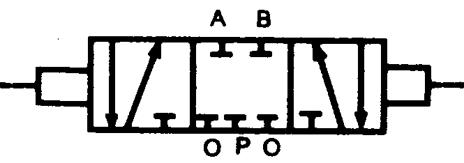

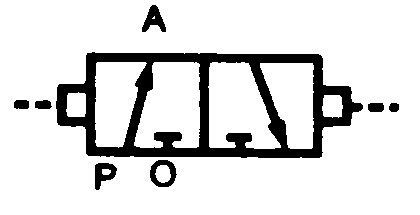

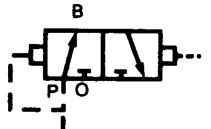

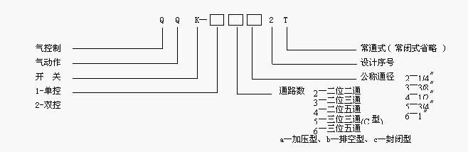

Ò»¡¢ÐͺÅ
¶þ¡¢Í¼ÐηûºÅ
¶þ
λ
Èý
µ¥
Æø
¿Ø
³£±ÕÐÍ
Èýλ
Èýͨ
·â±ÕÐÍ
³£Í¨ÐÍ
Èý
λ
Îå
¼ÓѹÐÍ
Ë«Æø¿Ø
ÅÅ¿ÕÐÍ
¶þ
λ
Îå
µ¥Æø¿Ø
·â±ÕÐÍ
Ë«Æø¿Ø

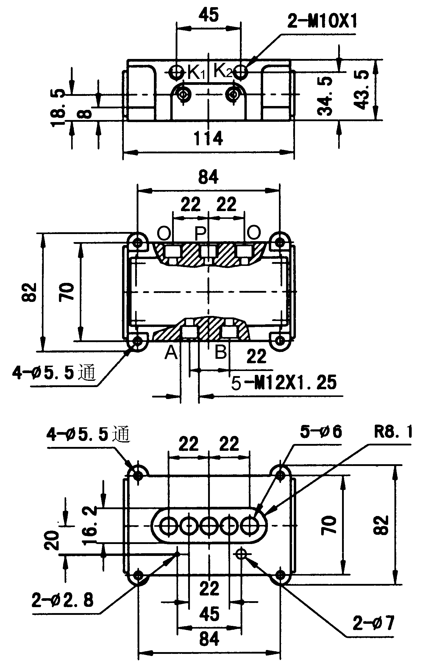

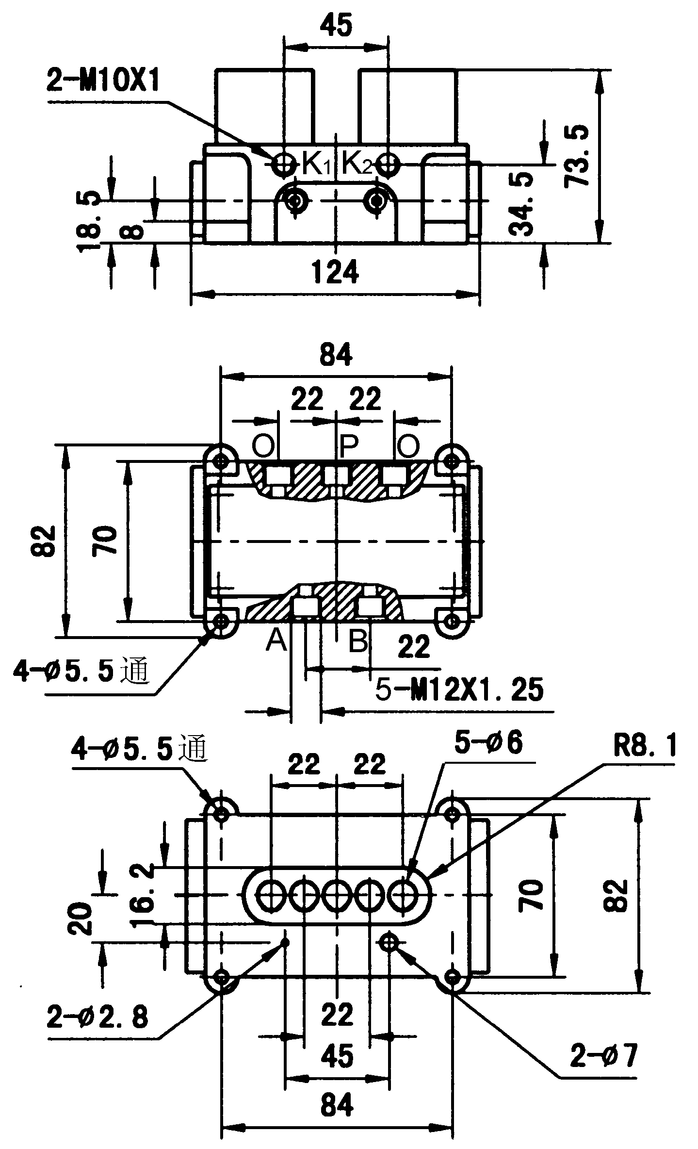

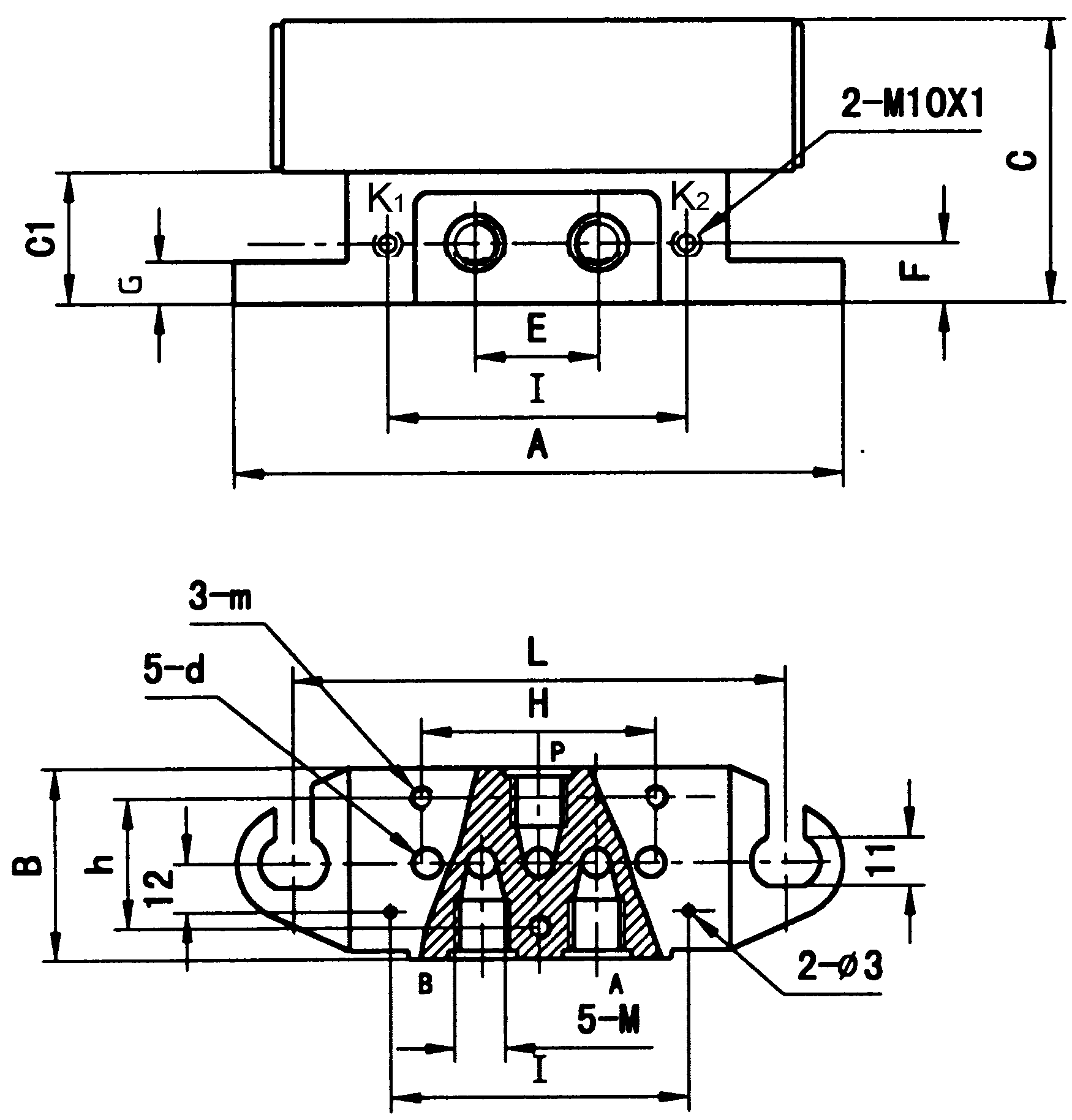

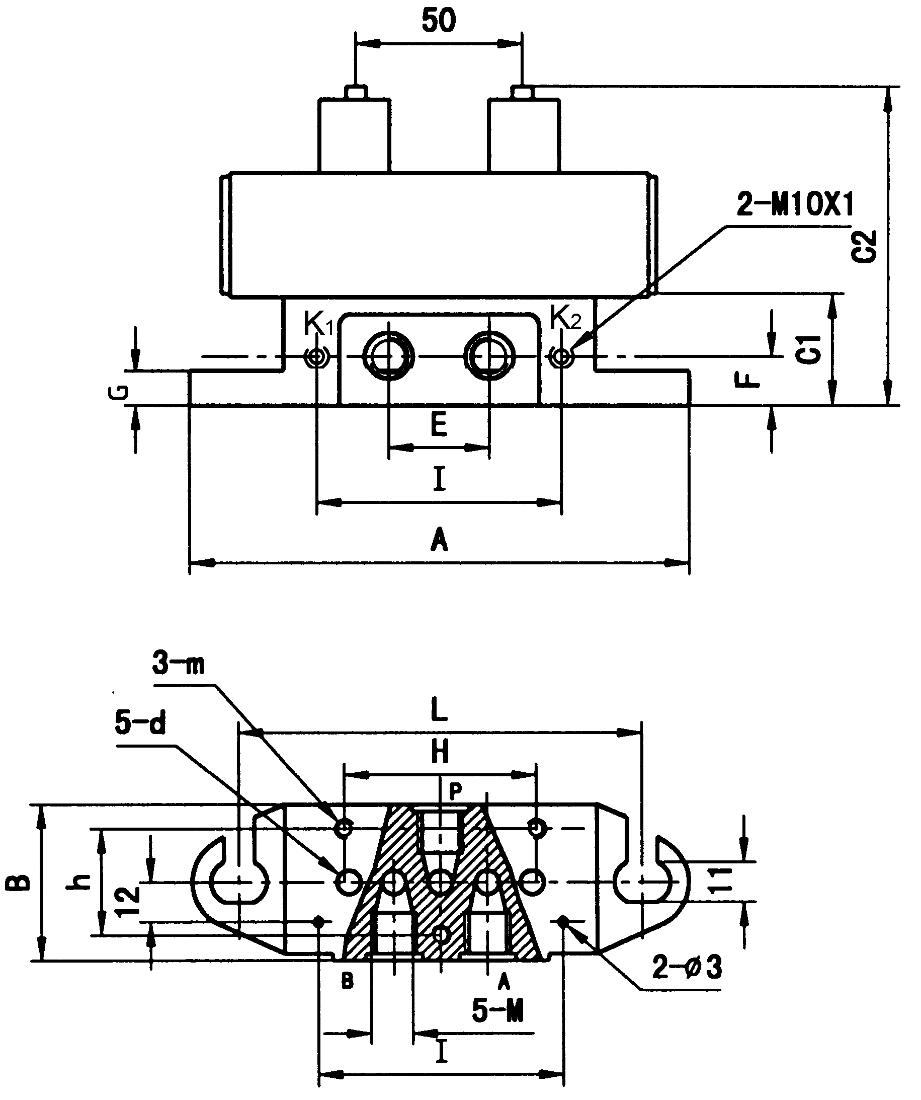

Îå¡¢ÍâÐμ°°²×°³ß´ç
£¨¹Ü½Óʽ£©
£¨¹Ü½Óʽ£©
£¨°å½Óʽ£©
£¨°å½Óʽ£©
       1/4¡å¶þÎ»Æø¿Ø»»Ïò·§                                   1/4¡åÈýÎ»Æø¿Ø»»Ïò·§
   3/8¡å¡¢1/2¡å¡¢3/4¡å¡¢1¡å¶þÎ»Æø¿Ø»»Ïò·§            3/8¡å¡¢1/2¡å¡¢3/4¡å¡¢1¡åÈýÎ»Æø¿Ø»»Ïò·§
        £¨È¥µô·§×ùΪ°å½Ó·§£©                               £¨È¥µô·§×ùΪ°å½Ó·§£©
ͨ¾¶
A
B
C
C1
C2
E
F
G
L
M
m
H
h
I
d
3/8¡å
200
66
98.5
46
126
42
21
14
160
M16¡Á1.5
3 - M6Éî9
60
45
102
¦µ15
1/2¡å
200
66
98.5
46
126
42
21
14
160
M20¡Á1.5
3 - M6Éî9
60
45
102
¦µ10
3/4¡å
248
112
138.5
52
166
64
30
15
202
M27¡Á2
4 - M6Éî9
60
90
148
¦µ20
1¡å
248
112
138.5
52
166
64
30
15
202
M33¡Á2
4 - M6Éî9
60
90
148
¦µ25
