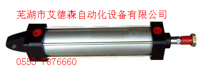

QGA¡¢QGBϵÁÐÆø¸×

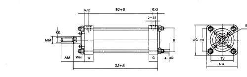

QGAϵÁÐÎÞ»º³åÆø¸×
QGAϵÁÐÆø¸×ÊÇÎÞ»º³å×°ÖÃµÄÆÕÍ¨Æø¸×£¬¹¤×÷½éÖÊΪ¾­¹ý¾»»¯´¦ÀíµÄº¬ÓÍÎíѹËõ¿ÕÆø¡£
±êע˵Ã÷:QGA¢Ù-¢Ú-¢Û
¢ÙÆø¸×ÄÚ¾¶ ¢ÚÆø¸×ÐÐ³Ì ¢ÛÆø¸×°²×°ÐÎʽ Î޼Ǻţº»ù±¾ÐÍ f£ºÇ°·¨À¼Ê½
F£ººó·¨À¼Ê½ G£º½Å¼Üʽ B£ºÖмä°ÚÖáʽ S£ºÎ²²¿Ðü¹Òʽ
»ù±¾²ÎÊý:
Æø¸×ÄÚ¾¶
£¨mm)
Ðг̷¶Î§
(mm)
¹¤×÷ѹÁ¦·¶Î§
(MPa)
ÖÜΧ½éÖÊζÈ
£¨¡æ£©
ÀíÂÛ×÷ÓÃÁ¦£¨N£©
£¨Ñ¹Á¦Îª0.4MPaʱ¼ÆË㣩
ÍÆÁ¦
À­Á¦
¦Õ40
0¡«300
0.15¡«0.8
-10¡«80
500
450
¦Õ50
0¡«300
0.15¡«0.8
780
700
¦Õ63
0¡«800
0.15¡«0.8
1250
1120
¦Õ80
0¡«800
0.15¡«0.8
2010
1880
¦Õ100
0¡«1500
0.15¡«0.8
3140
2950
¦Õ125
0¡«2000
0.1¡«0.8
4910
4720
¦Õ160
0¡«2500
0.1¡«0.8
8040
7720
¦Õ200
0¡«2500
0.1¡«0.8
12570
12250
¦Õ250
0¡«2500
0.1¡«0.8
19640
19140
×¢£º¸ù¾ÝÉϱíÑ¡ÓÃÆø¸×ʱ£¬Ó¦½«ÀíÂÛÍÆÁ¦ºÍÀ­Á¦Ôö´ó15¡«20%

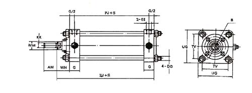

QGBϵÁлº³åÆø¸×
QGB50¡Á180-CA
QGBϵÁÐÆø¸×
ÊÇ»º³åÆø¸×¡£¹¤×÷½éÖÊΪ¾­¹ý¾»»¯´¦ÀíµÄº¬ÓÍÎíѹËõ¿ÕÆø¡£
  Æø¸×µÄ»º³å×÷Óã¬Êǵ±»îÈûÔ˶¯µ½½Ó½üÐгÌÄ©¶Ëʱ£¬°²×°ÓÚÆø¸×ÄÚ²¿µÄ»º³å×°ÖÿªÊ¼Æð×÷Óã¬Ê¹»îÈûÔ˶¯ËٶȽµµÍ£¬Ô˶¯Æ½ÎÈ£¬±ÜÃâ·¢Éú³å»÷ÏÖÏ󣬸ÃϵÁÐÆø¸×¸×¾¶¦Õ40¡¢¦Õ50mm
  µÄΪ²»¿Éµ÷»º³å£¬¸×¾¶¦Õ63mm¼°ÒÔÉϸ׾¶µÄÆø¸×Ϊ¿Éµ÷»º³å¡£
±êע˵Ã÷QGA¢Ù-¢Ú-¢Û
  ¢ÙÆø¸×ÄÚ¾¶ ¢ÚÆø¸×ÐÐ³Ì ¢ÛÆø¸×°²×°ÐÎʽ Î޼ǺÅ:»ù±¾ÐÍ f:ǰ·¨À¼Ê½
    F:ºó·¨À¼Ê½ G:½Å¼Üʽ B:Öмä°ÚÖáʽ S:β²¿Ðü¹Òʽ
»ù±¾²ÎÊý
Æø¸×ÄÚ¾¶
£¨mm)
Ðг̷¶Î§
(mm)
¹¤×÷ѹÁ¦·¶Î§
(MPa)
ÖÜΧ½éÖÊζÈ
£¨¡æ£©
ÀíÂÛ×÷ÓÃÁ¦£¨N£©
£¨Ñ¹Á¦Îª0.4MPaʱ¼ÆË㣩
ÍÆÁ¦
À­Á¦
¦Õ40
40¡«300
0.15¡«0.8
-10¡«80
500
450
¦Õ50
40¡«300
0.15¡«0.8
780
700
¦Õ63
63¡«800
0.15¡«0.8
1250
1120
¦Õ80
63¡«800
0.15¡«0.8
2010
1880
¦Õ100
100¡«1500
0.15¡«0.8
3140
2940
¦Õ125
100¡«2000
0.1¡«0.8
4920
4520
¦Õ160
160¡«2500
0.1¡«0.8
8040
7540
¦Õ200
160¡«2500
0.1¡«0.8
12560
12060
¦Õ250
250¡«2500
0.1¡«0.8
19640
18860
¦Õ320
300¡«2500
0.1¡«0.8
32160
30910
¦Õ400
300¡«2500
0.1¡«0.8
50400
48400
