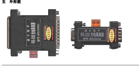

  ²¨Ê¿µç×ÓµÄBS232H ϵÁÐÓÐÔ´RS-232 ¸ßËÙ¹âµç¸ôÀëÆ÷ÓÃÓÚʵÏÖRS-232 ´®ÐпڵĸßËÙ¹âµç¸ôÀë¡£BS232HϵÁÐÓÃÓÚʵÏÖ RS-232 ´®ÐÐͨÐŵĻúÆ÷Ö®¼äµÄ¸ßËÙ¹âµç¸ôÀë¡¢±£»¤Í¨ÐÅµÄ RS-232´®Ðпڼ°»úÆ÷¡£
¶þ¡¢Ó²¼þ°²×°
        BS232H ϵÁÐÓÐÔ´ RS-232 ¸ßËÙ¹âµç¸ôÀëÆ÷ÓÐÈýÖÖÐͺţº BS232H9 ÐÍ¡¢BS232H25 ÐÍ¡¢BS232HC25ÐÍ¡£
BS232H25ÐÍ¡¢BS232HC25Ð͵ÄÍâÐξùΪDB-25(Õë)/DB-25(¿×)´óС¡£BS232H25ÐÍÖ»¸ôÀë²¢ÇÒÖ»´«ËÍRS-232µÄÊÕ¡¢·¢¡¢µØ¡£BS232HC25ÐͲ»½ö¸ôÀëRS-232µÄÊÕ¡¢·¢¡¢µØ£¬¶øÇÒ»¹¸ôÀëRTS ºÍCTS¡¢DTR ºÍDSR¡£BS232H9Ð͵ÄÍâÐÎΪDB-9(Õë)/DB-9(¿×)´óС¡¢Ö»¸ôÀë²¢ÇÒÖ»´«ËÍRS-232µÄÊÕ¡¢·¢¡¢µØ¡£Èç¹û½«BS232HϵÁÐRS-232¹âµç¸ôÀëÆ÷µÄ¿××ùÒ»¶ËÖ±½Ó²åÔÚPC»úµÈÊý¾ÝÖÕ¶ËÉ豸£¨DTE£©µÄ DB-25 ÕëRS-232²å×ù£¨Õë×ù£©ÉÏ£¬ÔòBS232H ϵÁеÄÁíÍâÒ»¶Ë£¨Õë×ù£©Ï൱ÓÚÒ»¸öеĹâµç¸ôÀëµÄRS-232¿Ú¡£Èç¹û½«BS232HϵÁÐRS-232¹âµç¸ôÀëÆ÷µÄÕë×ùÒ»¶ËÖ±½Ó²åÔÚMODEM µÈÊý¾ÝͨÐÅÉ豸£¨DCE£©µÄ DB-25 ÕëRS-232²å×ù£¨¿××ù£©ÉÏ£¬ÔòBS232H ϵÁеÄÁíÍâÒ»¶Ë£¨¿××ù£©Ï൱ÓÚÒ»¸öеĹâµç¸ôÀëµÄRS-232¿Ú¡£
Èý¡¢Èí¼þ˵Ã÷
±¾²úÆ·¾ùÎÞÐèÈκγõʼ»¯ÉèÖã¡Ö»Óõ½RXD£¨ÊÕ£©¡¢TXD£¨·¢£©¡¢GND£¨µØ£©Ðźż´¿É£¬¼ÓÉ϶ÀÓеÄÄÚ²¿ÁãÑÓʱ×Ô¶¯ÊÕ·¢×ª»»¼¼Êõ£¬È·±£ÊʺÏËùÓÐÈí¼þ£¡¹º3 Ö»ÒÔÉÏÔùËÍWINDOWSϵÄRS-232/RS-485ͨÐżì²âÈí¼þÒÔ¼°VB,C++,DELPHI µÄRS-232´®ÐÐͨÐÅ¿ª·¢Èí¼þ¡£
ËÄ¡¢ÐÔÄÜ˵Ã÷
       BS232HϵÁÐRS-232¸ßËÙ¹âµç¸ôÀëÆ÷ÐèÍâ½Ó5V¹©µç£¨µçѹ4.5ÖÁ5.5V£¬¹¦ºÄСÓÚ50mA£©£¬¸ôÀëµçѹ2500V£¬²¢ÇÒ¿ÉÒÔÔö¼ÓRS-232µÄÇý¶¯ÄÜÁ¦¡£Íâ½ÓµçÔ´µÄGND Óë²úÆ·µÄDB-9¿×£¨²åPC»úµÄÒ»²à£©µÄGNDÊǹ²µØ¶Ì½ÓµÄ¡£BS232H9¡¢BS232H25¡¢BS232HC25µÄͨÐÅËÙÂʱ£Ö¤×î¸ß150Kbps,×îµÍΪ0¡£
BS232H9¿ÉÒÔÖ±½Ó²å²¨Ê¿µç×ÓµÄϵÁÐRS-232/485/422ת»»Æ÷¡£BS232H[C]25 µÄDB-25Õë×ùÒ²¿ÉÒÔͨ¹ýDB-25£¨¿×£©/DB-9£¨Õ룩ת½ÓÍ·²å²¨Ê¿µç×ÓµÄϵÁÐRS-232/485/422ת»»Æ÷¡£
