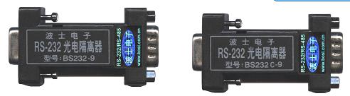

        ²¨Ê¿µç×ÓµÄBS232 ϵÁÐRS-232 ¹âµç¸ôÀëÆ÷ÓÃÓÚʵÏÖRS-232´®ÐпڵĹâµç¸ôÀë¡£BS232ÓÃÓÚ±£»¤Í¨ÐŵÄRS-232´®Ðпڼ°»úÆ÷£¬»¹¿ÉÓÃÓÚʵÏÖRS-232 ´®ÐÐͨÐŵĻúÆ÷Ö®¼äµÄ¹âµç¸ôÀ롣ĿǰÊÀ½çÉÏÖ»Óв¨Ê¿µç×ÓÄܹ»ÔÚDB-9/DB-9 ת½ÓºÐ´óСÄÚʵÏÖRS-232 µÄÈýÏßÒÔÉϵĹâµç¸ôÀ룬ÆäÖÐBS232C-9¸ôÀëÁËÈ«²¿RS-232Ðźţ¡
¶þ¡¢Ó²¼þ°²×°
BS232ϵÁÐRS-232 ¹âµç¸ôÀëÆ÷ÓÐËÄÖÖÐͺţº BS232?-9Ð͵ÄÍâÐÎΪDB-9(¿×)/DB-9(Õë)ת½ÓºÐ´óС¡¢BS232?-25 Ð͵ÄÍâÐÎΪDB-25(Õë)/DB-25(¿×)´óС¡£Èç¹û½« BS232-9 ÐÍ RS-232 ¹âµç¸ôÀëÆ÷µÄ¿××ùÒ»¶ËÖ±½Ó²åÔÚ PC »úµÈÊý¾ÝÖÕ¶ËÉ豸£¨DTE£©µÄRS-232²å×ù£¨Õë×ù£©ÉÏ£¬ÔòBS232-9 Ð͵ÄÁíÍâÒ»¶Ë£¨Õë×ù£©Ï൱ÓÚÒ»¸öеĹâµç¸ôÀëµÄRS-232¿Ú¡£Èç¹û½«BS232-9 ÐÍRS-232¹âµç¸ôÀëÆ÷µÄÕë×ùÒ»¶ËÖ±½Ó²åÔÚMODEMµÈÊý¾ÝͨÐÅÉ豸£¨DCE£©µÄRS-232²å×ù£¨¿××ù£©ÉÏ£¬ÔòBS232-9 Ð͵ÄÁíÍâÒ»¶Ë£¨¿××ù£©Ï൱ÓÚÒ»¸öеĹâµç¸ôÀëµÄRS-232¿Ú¡£ ×¢Ò⣺BS232-9¡¢BS232-25ÐÍÖ»¸ôÀë²¢ÇÒÖ»´«ËÍRS-232µÄÊÕ¡¢·¢¡¢µØ¡£
         BS232B-9ÐÍRS-232 ¹âµç¸ôÀëÆ÷£¨DB-9Õë/DB-9¿×ת½ÓºÐ´óС£©²»½ö¸ôÀëRS-232 µÄÊÕ¡¢·¢¡¢µØ£¬¶øÇÒ»¹¸ôÀëRTS ºÍCTS¡£Èç¹ûÒª¸ôÀëDTRºÍDSR£¬»òÕ߯äËûÐźſÉÒÔÌØ±ðÉùÃ÷¡£
BS232C-9ÐÍRS-232 ¹âµç¸ôÀëÆ÷£¨DB-9 Õë/DB-9 ¿×ת½ÓºÐ´óС£©²»½ö¸ôÀëRS-232 µÄÊÕ¡¢·¢¡¢µØ£¬¶øÇÒ»¹¸ôÀëRTS ºÍCTS¡¢DTR ºÍDSR¡£½«BS232C-9 µÄDB-9¿××ùÖ±½ÓÍâ²åPC»úµÄRS-232´®ÐпÚ(DB-9Õë×ù)£¬Ôò BS232C-9 µÄÁíÍâÒ»¶Ë(DB-9 Õë×ù)ΪеĹâµç¸ôÀëºóµÄ RS-232 ´®Ðпڡ£BS232C-25Ð͹âµç¸ôÀëÆ÷¹¦ÄÜͬBS232C-9£¬Ö»ÊÇÍâÐÎΪDB-25 Õë/DB-25 ¿×ת½ÓºÐ´óС¡£
Èý¡¢Èí¼þ˵Ã÷
±¾²úÆ·¾ùÎÞÐèÈκγõʼ»¯ÉèÖã¡Ö»Óõ½RXD£¨ÊÕ£©¡¢TXD£¨·¢£©¡¢GND£¨µØ£©Ðźż´¿É£¬¼ÓÉ϶ÀÓеÄÄÚ²¿ÁãÑÓʱ×Ô¶¯ÊÕ·¢×ª»»¼¼Êõ£¬È·±£ÊʺÏËùÓÐÈí¼þ£¡ ¹º 3 Ö»ÒÔÉÏÔùËÍ WIN95 Ï嵀 RS-232/RS-485ͨÐżì²âÈí¼þÒÔ¼°VB,C++,DELPHI µÄRS-232´®ÐÐͨÐÅ¿ª·¢Èí¼þ¡£
ËÄ¡¢ÐÔÄÜ˵Ã÷
BS232 ϵÁÐ RS-232 ¹âµç¸ôÀëÆ÷¶¼ÎÞÐ蹩µç£¬¸ôÀëµçѹ 2500V£¬Í¨ÐÅËÙÂÊÒ»°ã±£Ö¤×î¸ß9600bps£¬Êµ¼Ê¿É´ï38.4KbpsÒÔÉÏ¡£
