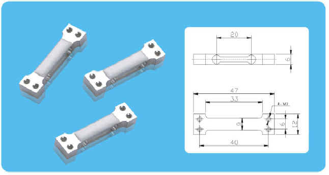

²úÆ·Ãû³Æ£º XH11СÁ¿³Ì³ÆÖزâÁ¦´«¸ÐÆ÷ >>
ÐÍ ºÅ£º XH11
Æ· ÅÆ£º 3139
²ú Æ· ˵ Ã÷
²úƷͼƬ(Products Picture)£º
²ÎÊý(Technical data)
µ¥Î»(Unit)
ÊýÖµ(data)
Á¿³ÌCAPACITY
g
1\2\3\5\10\20\50\100\200\300\500\750\1000
Êä³öÁéÃô¶ÈOUTPUT SENSITIVITY
mV/V
0.6¡À0.15/1.0¡À0.15
×ÛºÏÎó²îCOMPREHENSIVE ERROR
%F.S
0.05/0.03
ÁãµãÆ¯ÒÆ TEMP.EFFECT ON ZERO
£¨30min£©%F.S
0.05/0.03
ÁãµãÎÂ¶ÈÆ¯ÒÆ ZERO DRIFT
%F.S/10¶È
0.05/0.03
ÁãµãÊä³öZERO OUTPUT
mV/V
¡À0.1
ÊäÈë×迹INPUT RESISTANCE
   1055¡À15
Êä³ö×迹OUTPUT RESISTANCE
1000¡À5
¹ýÔØÄÜÁ¦OVERLOAD CAPACITY
%F.S
200
