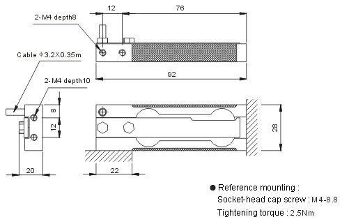

²úÆ·Ãû³Æ£º ͨÓóÆÖزâÁ¦´«¸ÐÆ÷ >> XH21
ÐÍ ºÅ£º XH21
Æ· ÅÆ£º 3139
²ú Æ· ˵ Ã÷
²ÎÊý(Technical)
µ¥Î»(Unit)
ÊýÖµ(Data)
Á¿³Ì
kg
0.5¡¢1¡¢2¡¢3¡¢5¡¢7.5
Êä³öÁéÃô¶È
mV/V
2.0¡À10%
×ÛºÏÎó²î
%F.S
0.03
ÁéÃô¶ÈÎÂ¶ÈÆ¯ÒÆ
%F.S/10¡æ
0.03
ÁãµãÎÂ¶ÈÆ¯ÒÆ
%F.S/10¡æ
0.03
ÁãµãÊä³ö
mV/V
¡À0.04
ÊäÈë×迹
   410¡À30
Êä³ö×迹
350¡À3
¹ýÔØÄÜÁ¦
%F.S
150
ÍÆ¼ö¼¤Àøµçѹ£¨EXCITATION VOLTAGE£©:0.5-12V£¬×î´ó¼¤Àøµçѹ£¨MAX VA£©:18V.ÂÁºÏ½ð²ÄÖÊ,¸ß¾«¶È¸ßÎȶ¨ÐÔ,·½Î»Æ«²îС£¬¿ÉÓÃÓÚ¸÷ÖÖ×Ô¶¯¿ØÖÆÉ豸¡¢×Ô¶¯²âÁ¦É豸¡¢¸÷Öֳӵȣ¬¿É¸ù¾Ý¿Í»§ÒªÇó¶¨ÖÆ.ÒýÏß¶¨Òå:ºì(red): E+   ºÚ(black): E-   °×(white): V-    À¶»òÂÌ(blue or green): V+
