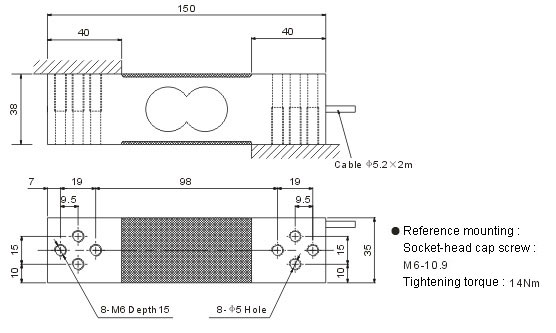

²úÆ·Ãû³Æ£º ͨÓóÆÖزâÁ¦´«¸ÐÆ÷ >> XH23
ÐÍ ºÅ£º XH23
Æ· ÅÆ£º 3139
²ú Æ· ˵ Ã÷
²ÎÊý(Technical data)
µ¥Î»(Unit)
ÊýÖµ(data)
Á¿³ÌCAPACITY
kg
60¡¢100¡¢200¡¢250¡¢300¡¢350
Êä³öÁéÃô¶ÈOUTPUT SENSITIVITY
mV/V
2.0¡À10%
×ÛºÏÎó²îCOMPREHENSIVE ERROR
%F.S
0.05
ÁãµãÎÂ¶ÈÆ¯ÒÆ TEMP.EFFECT ON ZERO
%F.S/10¡æ
0.05
ÁéÃô¶ÈÎÂ¶ÈÆ¯ÒÆTEMP.EFFECT ON OUPT
%F.S/10¡æ
0.05
ÁãµãÊä³öZERO OUTPUT
mV/V
¡À0.04
ÊäÈë×迹INPUT RESISTANCE
   410¡À30
Êä³ö×迹OUTPUT RESISTANCE
350¡À3
¹ýÔØÄÜÁ¦OVERLOAD CAPACITY
%F.S
150
ºì(red): E+   ºÚ(black): E-   °×(white): V-    À¶»òÂÌ(blue or green): V+
ÍÆ¼ö¼¤Àøµçѹ0.5-12V£¬×î´ó¼¤Àøµçѹ18V¡£µ¥µãƽÐÐÁº½á¹¹£¬ÂÁÖÆ´«¸ÐÆ÷£¬·½Î»Æ«²îС£¬¿ÉÓÃÓÚ¸÷ÖÖ×Ô¶¯¿ØÖÆÉ豸¡¢×Ô¶¯²âÁ¦É豸¡¢¼Æ¼Û³Ó¡¢µç×Ó³Ó¡¢ÌìÆ½µÈ¡£¿É¸ù¾ÝÓû§µÄ¾ßÌåÒªÇóºÍÍâÐÎ³ß´ç¶¨ÖÆ´«¸ÐÆ÷¡£ÉîÛÚÊÐÁ¦ÕýÐ˿Ƽ¼ÓÐÏÞ¹«Ë¾
