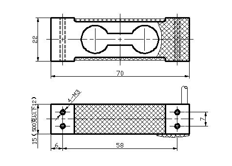

    ²ú Æ· ˵ Ã÷
²úÆ·ÍâÐÎͼ
²ÎÊý
µ¥Î»
ÊýÖµ(Data)
Á¿³Ì
kg
0.3¡¢0.5¡¢1¡¢2¡¢3¡¢5¡¢10¡¢15¡¢20¡¢30¡¢50
Êä³öÁéÃô¶È
mV/V
2.0
×ÛºÏÎó²î
%F.S
0.05
ÁãµãÎÂ¶ÈÆ¯ÒÆ
%F.S/10¡æ
0.05
ÁéÃô¶ÈÎÂ¶ÈÆ¯ÒÆ
%F.S/10¡æ
0.05
ÁãµãÊä³ö
mV/V
¡À0.04
¹ýÔØÄÜÁ¦
%F.S
150
ÍÆ¼ö¼¤Àøµçѹ(Recommend excitation)0.5-10V£¬×î´ó¼¤Àøµçѹ(Maximum excitation)15V¡£ÓÅÖʳ¬Ó²ÂÁºÏ½ð²ÄÖÊ,³¤ÆÚÎȶ¨ÐÔºÃ,·½Î»Æ«²î΢С,½á¹¹Ð¡ÇÉ,¹ýÔØÄÜÁ¦ºÍ¿¹³å»÷ÄÜÁ¦Ç¿,ÊÊÓÃÓÚ¸÷Öָ߾«¶È¼ì²âÉ豸,×Ô¶¯»¯É豸,°ü×°²úÏßµÈ.¿É¸ù¾ÝÓû§µÄ¾ßÌåÒªÇóºÍÍâÐÎ³ß´ç¶¨ÖÆ´«¸ÐÆ÷¡£µçÀ¶¨Òå:ºì(red): E+   ºÚ(black): E-   °×(white): V-    À¶»òÂÌ(blue or green): V+
