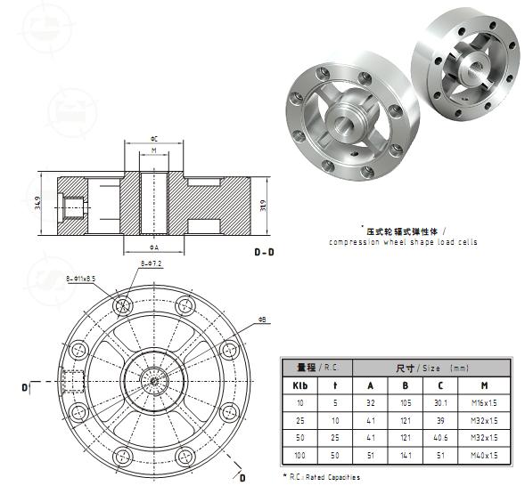

³ÆÖزâÁ¦Å¤¾Ø´«¸ÐÆ÷
    ²ú Æ· ˵ Ã÷
ÍâÐγߴçͼ:
²ÎÊý(Technical data)
µ¥Î»(Unit)
ÊýÖµ(data)
Á¿³ÌCAPACITY
kg
10¡¢20¡¢30¡¢50¡¢100¡¢200¡¢300¡¢500¡¢1000¡¢2000
Á¿³ÌCAPACITY
t
 5¡¢10¡¢20¡¢30¡¢50¡¢100¡¢200¡¢300¡¢500
Êä³öÁéÃô¶ÈOUTPUT SENSITIVITY
mV/V
2.0¡À10%
×ÛºÏÎó²îCOMPREHENSIVE ERROR
%F.S
0.05
ÁãµãÎÂ¶ÈÆ¯ÒÆ TEMP.EFFECT ON ZERO
%F.S/10¡æ
0.05
ÁéÃô¶ÈÎÂ¶ÈÆ¯ÒÆTEMP.EFFECT ON OUPT
%F.S/10¡æ
0.05
ÁãµãÊä³öZERO OUTPUT
mV/V
¡À0.04
ÊäÈë×迹INPUT RESISTANCE
   410¡À30
Êä³ö×迹OUTPUT RESISTANCE
350¡À3
¹ýÔØÄÜÁ¦OVERLOAD CAPACITY
%F.S
150
ºì(red): E+   ºÚ(black): E-   °×(white): V-    À¶»òÂÌ(blue or green): V+
ÍÆ¼ö¼¤Àøµçѹ£¨EXCITATION VOLTAGE£©0.5-10V£¬×î´ó¼¤Àøµçѹ£¨MAX VOLTAGE£©15V¡£
¼ôÇÐÂÖ·øÊ½½á¹¹£¬ºÏ½ð¸Ö´«¸ÐÆ÷£¬Ó¦ÓÃÓÚ±¡ÐÍÃæÌ¨³Ó¡¢»ù¿Óʽ̨³Ó¡¢Ìì³µ³Ó¡¢Á϶·ºÍÁϹÞ
³Ó¡¢Éú²ú¹ý³Ì³ÆÖØ¡¢Ê³Æ·¹¤Òµ³ÆÖصȡ£¿É¸ù¾ÝÓû§µÄ¾ßÌåÒªÇóºÍÍâÐÎ³ß´ç¶¨ÖÆ´«¸ÐÆ÷¡£ÁíÓлî
¶¯Ö§½Å¡¢³ÆÖØÄ£¿éµÈ¸½¼þÅäÌס£
