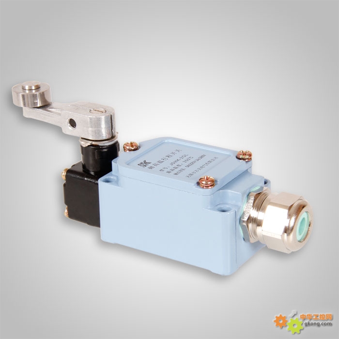

²úÆ·Ãû³Æ£º Ä͸ßÎÂÐг̿ª¹Ø
ÐÍ ºÅ£º JDHK-2GL
Æ· ÅÆ£º 6141
   “Íò¿Ë”ÅÆÄ͸ßÎÂÐг̿ª¹ØÄÚ²¿²ÉÓÃÄ͸ßβÄÁϽ½Öý³ÉµÄÈ«·â±Õ´¥µã¿ª¹Ø£¬Ò»×é³£¿ªÒ»×é³£±Õ×î´óÔÊÐíµçÁ÷5A/AC 220V£¬´¥µã¾­¹ýÌØÊâ´¦Àíºó¿ÉÔÚ¸ßλ·¾³Ï³¤Ê±¼äʹÓöø²»±»Ñõ»¯»òÎÛȾ¶øµ¼ÖÂË𻵡£JDHK-2ϵÁÐÄ͸ßÎÂÐг̿ª¹Ø×î¸ßζÈΪ350¡æ£¬JDHK-3ϵÁÐÄ͸ßÎÂÐг̿ª¹Ø×î¸ßζÈΪ650¡æ£¬Ã¿¸öϵÁеÄÄ͸ßÎÂÐг̿ª¹Ø¶¼Óйö×Ó±ÛÐÍ¡¢¿Éµ÷¸ËÐÍ¡¢Ñ¹ÖùÈû¼°¹öÂÖѹÖùÐÍ£¬¿ÉÂú×㲻ͬ³¡ºÏʹÓÃÒªÇ󡣹㷺ʹÓÃÓÚµçÁ¦¡¢»¯¹¤¡¢Ê¯ÓÍ¡¢·ÄÖ¯¡¢¸ÖÌúµÈÐÐÒµ¡£
Æ·ÅÆ    wk    ÐͺŠ   JDHK-2GL
¶î¶¨µçѹ    380£¨V£©    ¶î¶¨µçÁ÷    5£¨A£©
Ó¦Ó÷¶Î§    ¸ßγ¡Ëù    ²úÆ·ÈÏÖ¤
ISO9002
²úÆ··ûºÏ±ê×¼£ºGB 14048.5  IEC  60947-5-1.

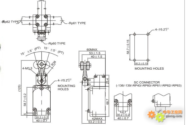

JDHK-2GL¹öÂÖÖùÈûÐÍÄ͸ßÎÂÐг̿ª¹Ø
×î´ó¶¯×îÁ¦14N            ×îС¸´Î»Á¦3N
×î´ó¶¯×÷ÐгÌ15±5°      ¼«Ï޽ǶÈ70°
±Û³¤µ÷½Ú·¶Î§25-89mm      ´¥µãÊýÁ¿1×é³£¿ª£¬1×é³£±Õ
´¥µãÈÝÁ¿5A/220V          ×î´ó²Ù×÷ƵÂÊ80´Î/·Ö£¨250¡æ£©
¾øÔµµç×è100M Ω£¨DC500V£©Ä͵çѹͬ¼«¶Ë×Ӽ䣨1000V£©
×î¸ßʹÓÃζÈ350¡æ
