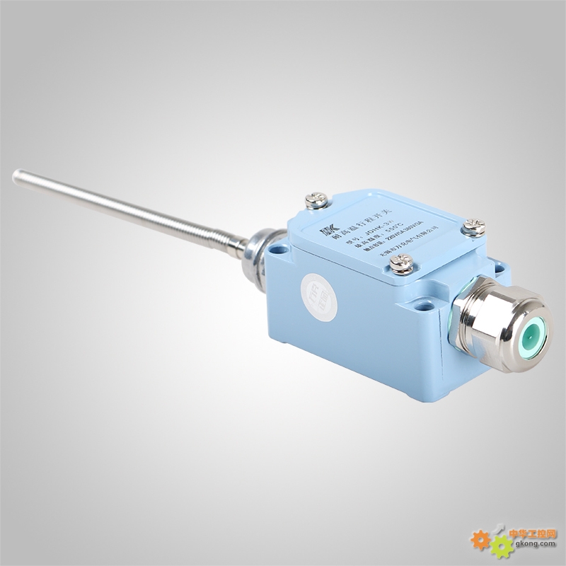

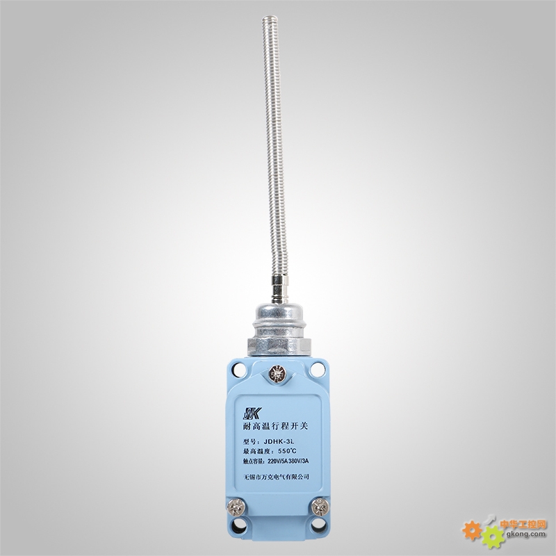

²úÆ·Ãû³Æ£º Íò¿ËÄ͸ßÎÂÐг̿ª¹Ø JDHK-3W ÍòÏòµ¯»ÉÐÍ
ÐÍ ºÅ£º JDHK-3W
¹©Ó¦ÎÞÎýÍò¿ËÅÆÍòÏòÐÍÄ͸ßÎÂÐг̿ª¹ØJDHK-3W£¬²úÆ·ÖÊÁ¿¿É¿¿£¬Ê¹ÓÃÊÙÃü³¤
¹«Ë¾Éú²úµÄÄ͸ßÎÂÐг̿ª¹Ø²úÆ·ÖÊÁ¿¿É¿¿£¬ÄÍθߣ¬ÊǹúÄÚ×îרҵµÄ¸ßÎÂÐг̿ª¹Ø³§¼Ò
¹©Ó¦ÎÞÎýÍò¿ËÅÆÄ͸ßÎÂÐг̿ª¹ØJDHK-2W£¬²úÆ·ÖÊÁ¿¿É¿¿£¬Ê¹ÓÃÊÙÃü³¤
²úÆ·±êÇ©£º Ä͸ßÎÂÐг̿ª¹Ø ÄÍÈÈÐг̿ª¹Ø JDHK-3W
· ·¢ »õ ÆÚ£ºÏÖ»õ
· Ëù ÔÚ µØ£ºÉϺ£  ÉϺ£
¶©»õÁ¿£¨Ö»£©
¼Û¸ñ
1 - 9
600.00Ôª/ Ö»
≥10
550.00Ôª/ Ö»
Æ·ÅÆ£º
Íò¿Ë
Ðͺţº
JDHK-3W
¶î¶¨µçѹ£º
220
¹¤×÷Ðг̣º
3mm
³¬Ðг̣º
15±5°
½á¹¹ÀàÐÍ£º
°Ú±ÛÐÍ
¿ª¹ØÀàÐÍ£º
1³£¿ª1³£±Õ
¶î¶¨µçÁ÷£º
5
Ó¦Ó÷¶Î§£º
Ä͸ßÎÂÐг̿ª¹Ø
²úÆ·ÈÏÖ¤£º
ISO9002
     ÎÞÎýÍò¿ËµçÆøÓÐÏÞ¹«Ë¾ÊÇÒ»¼ÒרҵÉú²úÏúÊÛÄ͸ßÎÂJDHKϵÁÐÐг̿ª¹Ø£¨ÒÔϼò³Æ¿ª¹Ø£©µÄ¹«Ë¾£¬¹«Ë¾ÔÚÉϺ£±±¾©Â·ÉèÓÐÏúÊÛר¹ñ£¬±¾¹«Ë¾ÓÐ×ÅÊ®¶àÄêµÄÉú²ú¾­Ñ飬ÔÚͬÐÐÒµÖÐÓÐןܺõĿڱ®£¬¸Ã²úÆ·Ö÷ÒªÓÃÓÚ½»Á÷50HZ/60HZ,380V,Ö±Á÷220V¼°ÒÔϸßλ·¾³µÄµçÆøÏß·ÖУ¬×÷Ô˶¯»ú¹¹µÄÐг̿ØÖÆ¡¢Ô˶¯·½Ïò»òËٶȵı任¡¢»ú´²µÄ×Ô¶¯¿ØÖÆ¡¢Ô˶¯»ú¹¹µÄÏÞλ¶¯×÷¼°¿ØÖÆ»ò³ÌÐòÖ®Óᣠ
   “Íò¿Ë”ÅÆÄ͸ßÎÂÐг̿ª¹ØÄÚ²¿²ÉÓÃÄ͸ßβÄÁϽ½Öý³ÉµÄÈ«·â±Õ´¥µã¿ª¹Ø£¬Ò»×é³£¿ªÒ»×é³£±Õ×î´óÔÊÐíµçÁ÷5A/AC 220V£¬´¥µã¾­¹ýÌØÊâ´¦Àíºó¿ÉÔÚ¸ßλ·¾³Ï³¤Ê±¼äʹÓöø²»±»Ñõ»¯»òÎÛȾ¶øµ¼ÖÂË𻵡£JDHK-2ϵÁÐÄ͸ßÎÂÐг̿ª¹Ø×î¸ßζÈΪ350¡æ£¬JDHK-3ϵÁÐÄ͸ßÎÂÐг̿ª¹Ø×î¸ßζÈΪ650¡æ£¬Ã¿¸öϵÁеÄÄ͸ßÎÂÐг̿ª¹Ø¶¼Óйö×Ó±ÛÐÍ¡¢¿Éµ÷¸ËÐÍ¡¢Ñ¹ÖùÈû¼°¹öÂÖѹÖùÐÍ£¬¿ÉÂú×㲻ͬ³¡ºÏʹÓÃÒªÇ󡣹㷺ʹÓÃÓÚµçÁ¦¡¢»¯¹¤¡¢Ê¯ÓÍ¡¢·ÄÖ¯¡¢¸ÖÌúµÈÐÐÒµ¡£
²úÆ··ûºÏ±ê×¼£ºGB 14048.5  IEC  60947-5-1.
  JDHK-3WÍòÏòÐÍÄ͸ßÎÂÐг̿ª¹Ø
×î´ó¶¯×îÁ¦
14N
×îС¸´Î»Á¦
3N
×î´ó¶¯×÷ÐгÌ
15±5°
¼«Ï޽ǶÈ
70°
±Û³¤µ÷½Ú·¶Î§
25-89mm
´¥µãÊýÁ¿
1×é³£¿ª£¬1×é³£±Õ
´¥µãÈÝÁ¿
5A/220V
×î´ó²Ù×÷ƵÂÊ
80´Î/·Ö£¨250¡æ£©
¾øÔµµç×è
100M Ω£¨DC500V£©
Ä͵çѹ
ͬ¼«¶Ë×Ӽ䣨1000V£©
×î¸ßʹÓÃζÈ
550¡æ
