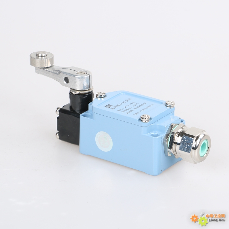

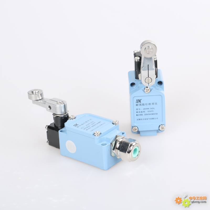

  Íò¿Ë¹öÂÖ°Ú±ÛÐÍÄ͸ßÎÂÐг̿ª¹ØJDHK-3GL
 Ò»¡¢²úÆ·½éÉÜ
      ÎÞÎýÍò¿ËµçÆøÓÐÏÞ¹«Ë¾ÊÇÒ»¼ÒרҵÉú²úÏúÊÛÄ͸ßÎÂJDHKϵÁÐÐг̿ª¹Ø£¨ÒÔϼò³Æ¿ª¹Ø£©µÄ¹«Ë¾£¬¹«Ë¾ÔÚÉϺ£±±¾©Â·ÉèÓÐÏúÊÛר¹ñ£¬±¾¹«Ë¾ÓÐ×ÅÊ®¶àÄêµÄÉú²ú¾­Ñ飬ÔÚͬÐÐÒµÖÐÓÐןܺõĿڱ®£¬¸Ã²úÆ·Ö÷ÒªÓÃÓÚ½»Á÷50HZ/60HZ,380V,Ö±Á÷220V¼°ÒÔϸßλ·¾³µÄµçÆøÏß·ÖУ¬×÷Ô˶¯»ú¹¹µÄÐг̿ØÖÆ¡¢Ô˶¯·½Ïò»òËٶȵı任¡¢»ú´²µÄ×Ô¶¯¿ØÖÆ¡¢Ô˶¯»ú¹¹µÄÏÞλ¶¯×÷¼°¿ØÖÆ»ò³ÌÐòÖ®Óᣠ
    Íò¿ËÅÆÄ͸ßÎÂÐг̿ª¹ØÄÚ²¿²ÉÓÃÄ͸ßβÄÁϽ½Öý³ÉµÄÈ«·â±Õ´¥µã¿ª¹Ø£¬Ò»×é³£¿ªÒ»×é³£±Õ×î´óÔÊÐíµçÁ÷5A/AC 220V£¬´¥µã¾­¹ýÌØÊâ´¦Àíºó¿ÉÔÚ¸ßλ·¾³Ï³¤Ê±¼äʹÓöø²»±»Ñõ»¯»òÎÛȾ¶øµ¼ÖÂË𻵡£JDHK-2ϵÁÐÄ͸ßÎÂÐг̿ª¹Ø×î¸ßζÈΪ350¡æ£¬JDHK-3ϵÁÐÄ͸ßÎÂÐг̿ª¹Ø×î¸ßζÈΪ550¡æ£¬Ã¿¸öϵÁеÄÄ͸ßÎÂÐг̿ª¹Ø¶¼Óйö×Ó±ÛÐÍ¡¢¿Éµ÷¸ËÐÍ¡¢Ñ¹ÖùÈû¼°¹öÂÖѹÖùÐÍ£¬¿ÉÂú×㲻ͬ³¡ºÏʹÓÃÒªÇ󡣹㷺ʹÓÃÓÚµçÁ¦¡¢»¯¹¤¡¢Ê¯ÓÍ¡¢·ÄÖ¯¡¢¸ÖÌúµÈÐÐÒµ¡£
¶þ¡¢¹¦ÄÜ˵Ã÷
     Ä͸ßÎÂÐг̿ª¹ØÓÖ³ÆÄ͸ßÎÂÏÞλ¿ª¹Ø,ÓÃÓÚÔÚ¸ßλ·¾³ÖпØÖÆ»úеÉ豸µÄÐг̼°ÏÞλ±£»¤¡£ÔÚʵ¼ÊÉú²úÖÐ,½«Ðг̿ª¹Ø°²×°ÔÚÔ¤ÏȰ²ÅŵÄλÖÃ,µ±×°ÓÚÉú²ú»úеÔ˶¯²¿¼þÉϵÄÄ£¿éײ»÷Ðг̿ª¹ØÊ±,Ðг̿ª¹ØµÄ´¥µã¶¯×÷,ʵÏֵ緵ÄÇл»¡£Òò´Ë,Ðг̿ª¹ØÊÇÒ»ÖÖ¸ù¾ÝÔ˶¯²¿¼þµÄÐгÌλÖöøÇл»µç·µÄµçÆ÷,ËüµÄ×÷ÓÃÔ­ÀíÓë°´Å¥ÀàËÆ¡£Ä͸ßÎÂÐг̿ª¹Ø¹ã·ºÓÃÓÚÔÚ¸ßλ·¾³Öй¤×÷µÄ¸÷ÀàÁ¶¸ÖÈÛ¯¡¢µç³§¡¢ºæ¸É»úе¡¢¶¨ÐÍ»ú£¬ºæÏäºæ·¿µÈ£¬ÓÃÒÔ¿ØÖÆÆäÐг̡¢½øÐÐÖÕ¶ËÏÞλ±£»¤¡£
 Èý¡¢²úÆ·ÓÅÊÆËµÃ÷
   Ä͸ßÎÂÐг̿ª¹ØÓÖÃûÄ͸ßÎÂÏÞλ¿ª¹Ø£¬ÊÇÒ»ÖÖרÃÅÓÃÓÚ¸ßγ¡ËùµÄÄÍÈÈ´«¶¯¿ØÖÆ×°Öã¬Íò¿Ë¹«Ë¾ÊÇרҵÑо¿Éú²ú´ËÀà¿ØÖÆ¿ª¹ØµÄÆóÒµ£¬¹«Ë¾µÄËùÑз¢µÄÄ͸ßβúÆ·ÔÚ¹úÄÚÍâ¶¼´¦ÓÚÁìÏÈˮƽ¡£3ϵÁкÍ5ϵÁеĿª¹Ø¸üÊÇÌî²¹Á˹úÄÚÍâµÄ´ËϵÁпª¹ØµÄ¿Õ°×£¡
ËÄ¡¢²úÆ·ÌØÕ÷
Æ·ÅÆ        wk                      ÐͺŠ       JDHK-3GL
¶î¶¨µçѹ    380£¨V£©                ¶î¶¨µçÁ÷    5£¨A£©
Ó¦Ó÷¶Î§    ¸ßγ¡Ëù                ²úÆ·ÈÏÖ¤    ISO9002
²úÆ··ûºÏ±ê×¼£ºGB 14048.5  IEC  60947-5-1.
  • ²úÆ·²ÎÊý
×î´ó¶¯×îÁ¦        14N               ×îС¸´Î»Á¦    3N
×î´ó¶¯×÷Ðг̠     15±5°           ¼«Ï޽ǶȠ     70°
±Û³¤µ÷½Ú·¶Î§      25-89mm           ´¥µãÊýÁ¿      1×é³£¿ª£¬1×é³£±Õ
´¥µãÈÝÁ¿          5A/220V           ×î´ó²Ù×÷ƵÂÊ  80´Î/·Ö£¨250¡æ£©
¾øÔµµç×è          100M Ω£¨DC500V£© Ä͵çѹ        ͬ¼«¶Ë×Ӽ䣨1000V£©
×î¸ßʹÓÃÎÂ¶È      550¡æ
