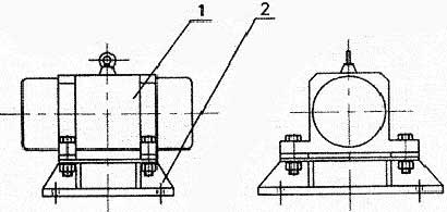

    ½á¹¹ÈçͼËùʾ¡£ÓÉÕñ¶¯µç»ú£¨1£©£¬µ××ù£¨2£©Á½²¿·Ö×é³É¡£Õñ¶¯µç»úºÍµ××ùÓÉÂÝ˨½ôÃܵع̶¨ÎªÒ»Ìå¡£ÓÉÓÚµ××ù½ô¹ÌµØ°²×°ÔÚÁϲֱÚÉÏ£¬ÕâÑù¾Í¹¹³ÉÁ˵¥Öʵ㶨ÏòÇ¿ÆÈÕñ¶¯ÏµÍ³¡£
    µ±LZF·À±ÕÈû ¹¤×÷ʱ£¬Õñ¶¯µç»úµÄ¸ßËÙת¶¯£¬±ã²úÉúÁ˶ÔÁϲֱڵÄÖÜÆÚÐÔ¸ßÆµÕñ¶¯£¬ÓÉÓÚ·À±ÕÈû×°ÖõÄÖÜÆÚÐÔÕñ¶¯£¬Ò»·½ÃæÊ¹ÎïÁÏÓë²Ö±ÚÍÑÀë½Ó´¥¡¢Ïû³ýÎïÁÏÓë²Ö±ÚµÄĦ²Á£¬ÁíÒ»·½ÃæÊ¹ÎïÁÏÊܽ»±äËٶȺͼÓËٶȵÄÓ°Ï죬´¦ÓÚ²»Îȶ¨×´Ì¬£¬´Ó¶øÓÐЧµØ¿Ë·þÎïÁϵÄÄÚĦ²ÁÁ¦ºÍ¾Û¼¯Á¦£¬ÒÔÏû³ýÁϲÖÄÚÎïÁϼäµÄÏà¶ÔÎȶ¨ÐÔ£¬Ê¹ÎïÁÏ´ÓÁϲֿÚ˳ÀûÅųö¡£
