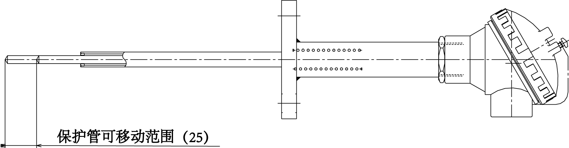

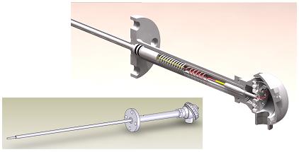

¸ß¯ÈȵçżµÄÌØµã
YAMARIµÄ¸ß¯Èȵçż¾ßÓжÀÒ»ÎÞ¶þµÄ½á¹¹£º
1. ±íÃæ½Ó´¥Ð͵ÄÈȵçż½á¹¹
ÕâÀàÈȵçż½â¾öÁ˱íÃæ½Ó´¥ÎÊÌ⣬¼´Ê¹Òòζȱ仯²úÉúÖÜÆÚÐÔµÄÀ©ÕźÍÊÕËõ£¬ÈȵçżµÄǰ¶Ë»¹Êǽô½ôµÄ¶¥×ÅÄÍ»ðש¡£
2. ·ÀÖØÓͺý×´ÎïÉøÈë½á¹¹
ÌØÊâÉè¼ÆµÄÖ§³Å¹ÜÄÜ·ÀÖ¹ÖØÓͺý×´ÎïÉøÈëµ½²âÎÂÌåÄÚ²¿¡£
