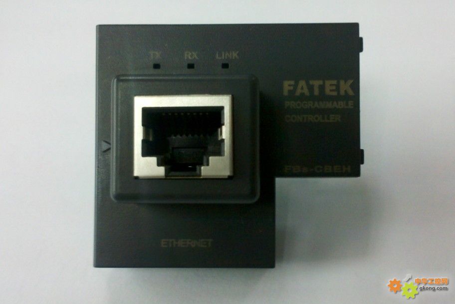

²úÆ·Ãû³Æ£º ÒÔÌ«ÍøÄ£¿é FBs-CBEH
ÐÍ ºÅ£º FBs-CBEH
Æ· ÅÆ£º 15
FBs-CBEHÏêϸ¹æ¸ñ£º
ÍøÂç½çÃæ
 100 Base T
ÍøÂçЭÒé
TCP/UDP/IP£¬ICMP£¬ARP
Ó¦ÓÃЭÒé
 FATEKK¿Í»§¼°ËÅ·þģʽ£¬Modbus-TCP¿Í»§»òËÅ·þģʽ
PLCÁªÍøÍ¨Ñ¶½çÃæ
Port1£¬Port2
 PLCͨѶËÙÂÊ
115.2Kbps
À©³äͨѶ¶Ë¿Ú
ÎÞ
 Ó¦ÓÃÕ¾ºÅ
FATEKÕ¾ºÅ500£¬Modbus-TCP  502»ò×Ô¶¨
 Í¨Ñ¶½ÓÍ·
ÍøÂçRJ-45
