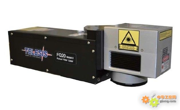

Telesis F-ϵÁйâÏ˼¤¹âÆ÷FQ10/20ºÍFQ20DHÉè¼ÆÐÂÓ±¡¢½á¹¹½ô´Õ¡¢Ê¹ÓÃÁé»î£¬·Ç³£ÊʺÏÓÚÎÞÈËά»¤7*24СʱÁ¬Ðø¹¤×÷£»10W FQ10ÊʺÏÖÐËÙ´ò±êÓ¦Óã¬20W FQ20ÊʺϸßËÙ´ò±êÓ¦Óã»ÕâÁ½ÖÖ¼¤¹âÆ÷¶¼ÓÐÄÚÖõĹâ¸ôÀëÆ÷£¬ÊµÏÖ³¤ÆÚµÄ°²È«·À»¤¡£
Telesis F-ϵÁйâÏ˼¤¹âÆ÷FQ10/20ºÍFQ20DHÌØÐÔ
²¨³¤ ....................................................................................... 1070nm
¼¤¹âÀàÐÍ ..........................................................Q¿ª¹Ø²ôïî¹âÏ˼¤¹âÆ÷
ƽ¾ù¹¦ÂÊFQ10 .............................................................................10W
ƽ¾ù¹¦ÂÊFQ20 .............................................................................20W
·åÖµ¹¦ÂÊFQ10 .......................................................................... >4KW
·åÖµ¹¦ÂÊFQ20 .......................................................................... >8KW
¹âÊøÖÊÁ¿ ....................................................................................M2<2
¹âÏ˳¤¶ÈFQ10 ......................................................... 5m (16 feet)±ê×¼
Telesis F-ϵÁйâÏ˼¤¹âÆ÷FQ10/20ºÍFQ20DHÄ£ÐÍ¿ØÖÆÆ÷
¹âÏ˳¤¶ÈFQ20 ........................................................ 3m (9.8 feet)±ê×¼
¹â¸ôÀëÆ÷FQ10 ............................................................................. ±ê×¼
¹â¸ôÀëÆ÷FQ20 ............................................................................. ±ê×¼
¶¨Î» ........................................................................... ¿É¼ûºì¹â¶þ¼«¹Ü
¿ÉÑ¡ÊäÈ빦ÂÊ ........................................... 115VAC/230VAC, 50/60HZ
ÀäÈ´ ......................................................................... ·çÀä,·çÉÈ/¹ýÂËÆ÷ ÎÞÐèË®Àä
²Ù×÷ζȷ¶Î§ ...................................................18¡ãµ½ 35¡ãÎÞÄý½á(65¡ãµ½95¡ãF)
ÊäÈëµçѹΪ110/230VAC£¬Ã»ÓÐË®ÀäÈ´µÄÒªÇó£¬FϵÁдò±êϵͳԪ¼þ¿É¿¿ÐԸߣ¬Ê¹ÓÃÊÙÃü³¤¡£
¿ÉÓþµÍ·
½¹¾à                    ´ò±ê·¶Î§
100mm                  65mm X 65mm (2.56&#733; X 2.56&#733;)
160mm                  90mm X 90mm (3.54&#733; X 3.54&#733;)
163mm                 110mm X 110mm (4.33&#733; X 4.33&#733;)
254mm                 175mm X 175mm (6.88&#733; X 6.88&#733;)
330mm                 230mm X 230m  m (9.06&#733; X 9.06&#733;)
350mm                 250mm X 250mm (9.84&#733; X 9.84&#733;)
420mm                 290mm X 290mm (11.42&#733; X 11.42&#733;)
FQ20DHÊÇ»ùÓÚÂö³å¹âÏ˼¤¹âÆ÷£¬ÆäÌØÕ÷ÊǾßÓÐÁ½¸öÕñ¾µÍ·ÄÜͬʱ¸ßËÙ¸ßÖÊÁ¿µÄÔÚÁ½¸ö±íÃæÉϽøÐдò±ê£»Ëæ×ŲúÁ¿µÄÔö¼Ó£¬ÆäÔË×÷³É±¾½µµÍ£¬Í¬Ê±¼«´óµÄÌá¸ßÁËЧÂÊ£»³ýÁË´ò±ê£¬FQ20DHÔÚ¿Ì»®£¬¼¤¹âÐÞÕûºÍÐí¶à²ÄÁϼӹ¤Ó¦ÓÃÖÐÒ²ÊÇÒ»¸ö¼«¼ÑµÄÑ¡Ôñ¡£
