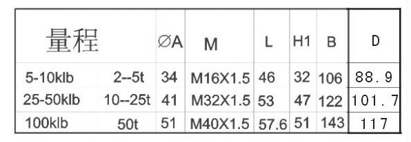

³ÆÖØ´«¸ÐÆ÷
ÐͺŠmodel
    Ó¦ÓÃ Application
Æû³µºâ
truck scale
    Á¿³Ì Capacity        Klb (t)
2¡¢5¡¢10¡¢25¡¢40¡¢50¡¢
£±£°£°¡¢£²£°£°¡¢300
    Êä³öÁéÃô¶È Output sensitivity(mV/V)
2.0¡À0.004 ¡¡ 4.0¡À0.04
    ·ÇÏßÐÔ Nonlinearity(%FS)
0.02
0.03
    Öظ´ÐÔ Repeatability(%FS)
0.015
0.02
    ³ÙµÙ Hysteresis(%FS)
0.02
0.03
    Èä±ä Creep(%FS/30min)
0.02
0.03
    Î¶ÈÁéÃô¶ÈÆ¯ÒÆ Temperature effect on sensitivity
0.0016
0.002
    Î¶ÈÁãµãÆ¯ÒÆ Temperature effect on zero
0.005
    Áãµãƽºâ Zero balance
¡À1.0
    ÊäÈë×迹 input resistance
725¡À8
725¡À8
    Êä³ö×迹 output resistance
700¡À5
700¡À5
    ¾øÔµµç×è insulation resistance
5000
    ÍƼö¼«Á¦µçѹ Recommended excitation voltage
10
    ×î´ó¼«Á¦µçѹ Maximum excitation voltage
15
    Î¶Ȳ¹³¥·¶Î§ Compensated temperature range
-10¡«+55
    ¹¤×÷²¹³¥·¶Î§ Operating temperature range
-35¡«+80
    °²È«³¬ÔØ Safe Overload
150
    ¼«ÏÞ·¶Î§ Ultimate Overload
200
    ´«¸ÐÆ÷²ÄÁÏ Load cell material
ºÏ½ð¸Ö Alloy steel
²»Ðâ¸Ö Stainless steel
    ½ÓÏßµçÀ Connecting
2-25t¡é5.7*8m
40-300t¡é5.7*13m
    ½ÓÏß·½Ê½ Method of connecting wire
ºìÊäÈë(+)ºÚÊäÈ루-£©
ÂÌÐźţ¨+£©°×Ðźţ¨-£©
