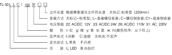

Ðͺűíʾ
TL-50ϵÁо¯Ê¾µÆÐͺÅ

ÐͺÅÀ¸ÖÐ""´¦×¢Ã÷ÑÕÉ«,""´¦×¢Ã÷µçѹµÈ¼¶´úÂë

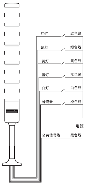

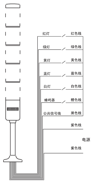

½ÓÏßͼ
³£ÁÁÐÍ ÉÁÁÁÐÍ

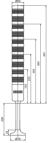

ÍâÐγߴç
