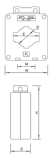

ÐͺÅ
¹æ¸ñ³ß´ç
³ß´ç ¹æ¸ñÐͺŠÍâÐÎ³ß´ç ´©¿×³ß´ç °²×°³ß´ç °²×°·½Ê½
W H D E ¦µ M
30¢ñ 59 78 30 30.5 23 31 A.B.C
30¢ñ-¢ñ 59 80 45 30.5 23 31 A.B.C
40¢ñ 75 97 44 42 30.5 45 A.B.C
60¢ñ 102 126 46 61.5 45 62 B.C
80¢ñ 118 138 45 81.5 52 60 B.C.E
100¢ñ 147 162 45 101.5 62 80 B.C.E

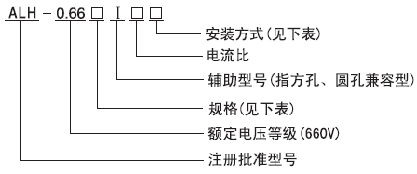

¼¼Êõ²ÎÊý
Ò»´ÎµçÁ÷ 5¡«3000A
¶þ´ÎµçÁ÷ 5A¡¢1A
¶î¶¨µçѹ  AC 660V
¶î¶¨¹¦ÂÊ 50¡«60Hz
»·¾³ÎÂ¶È -30¡æ¡«£«70¡æ
×î¸ßÄÍΠ120¡æ
º£°Î¸ß¶È ¡Ü3000m
¹²ÆµÄÍѹ 3000V 1min 50Hz(Íâ¿ÇÓë¶þ´ÎÏßȦ¼ä£©
