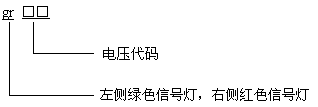

    LW39A-16ÐÍ¡¢LW39-G25ÐͺÍLW39-63ÐÍ¿ÉÒÔÅäÖÃÐźŵƣ¬ÐͺÅΪ£ºLW39A-16/gr¡õ¡õÐÍ¡¢LW39-25/gr¡õ¡õÐͺÍLW39-63/gr¡õ¡õ¡£
´øµÆÐÍ´úºÅ
£¨µÆµÄÑÕÉ«¡¢ÅÅÁк͵çѹ£©

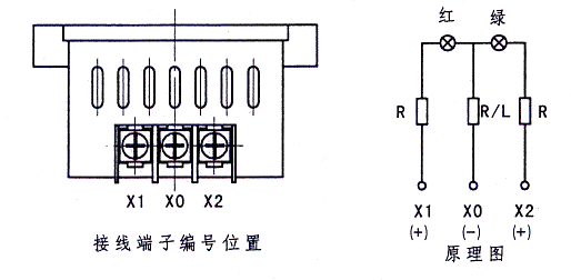

3¡¢ÐźŵƵÄÔ­ÀíºÍ½ÓÏß¿´Í¼Ê¾¡£
