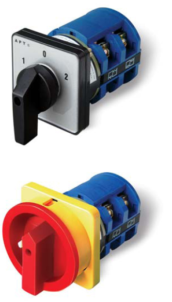

²úÆ·ÌØµã
    LW39-63ϵÁÐÍòÄÜת»»¿ª¹ØÎÈÖØ´ó·½£¬¿ª¹Ø´¥µãÈÝÁ¿´ó£¬ÊÊÓÃÓÚ½»Á÷50-60Hz£¬µçѹ690V¼°ÒÔÏ£¬Ö±Á÷440VÒÔÒÔϵĵç·ÖÐ×÷µç·µÄ½Óͨ¡¢·Ö¶ÏºÍת»»¶Ôµ¥Ì¨µç¶¯»úµÄÆð¶¯¡¢¼ÓËÙ¡¢¿ØÖƺÍÍ£Ö¹Ö®Óá£Òà¿ÉÔÚ´óÈÝÁ¿¿ØÖƵç·ÖÐ×÷ΪµçÆ÷¿ØÖƵÄת»»ºÍÅäµçÉ豸µÄÔ¶¾àÀë¿ØÖÆÖ®Óá£
¡ö΢°å²ÉÓýø¿Ú²ÄÁϺ͹úÍâͬÀà²úÆ·¼¼ÊõÖÆ×÷£¬ÃÀ¹ÛÄÍÓ㬴ﵽ¹ú¼ÊË®×¼£¬¿É¸ù¾Ý²»Í¬µÄ¿Í»§ÐèÒª£¬µñ¿ÌÌØÊâµÄ×Ö·ûÎÄ×Ö£»
¡ö¿ÇÌå²ÉÓÃ×èȼPBT£¬ÄÍÈÈ¡¢×ÔϨ£»
¡öµçÆøÐÔÄܸü¿É¿¿,ÐԼ۱ȸߣ»
¡ö¶¨Î»½Ç¶ÈÓÐ30¡ã¡¢60¡ã¡¢90¡ã£¬Ò»Öܹ²ÓÐ12¸öλÖã»
¡ö¿ª¹Ø´¥µãÈÝÁ¿´ó£¬Ô¼¶¨·¢ÈȵçÁ÷Ϊ63A£»
¡öÓµÓÐÁËÆÕͨÐÍ£¬´øËøÐÍ£¬°²È«Ð͵ȶàÖÖ¹¦ÄÜ ¡£

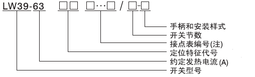

Ðͺź¬Òå
×¢£º½Óµã±í±àºÅÓÉ´Ó×ö¿ªÊ¼µÄ¸÷¸ö²Ù×÷λÖýÓͨ´¥µãÊýÁ¿µÄÊý×ÖÅÅÁС£
±í1»ù±¾ÐͺŵĶ¨Î»ÌØÕ÷´úºÅ
ÌØÕ÷´úºÅ ÊÖ±ú²Ù×÷λÖÃ
×Ô¸´Ê½ A 0¡ã¡û30¡ã
B -30¡ã¡ú0¡ã¡û30¡ã
¶¨Î»Ê½ C 0¡ã 60¡ã
D 60¡ã 0¡ã 60¡ã
E -90¡ã -30¡ã 30¡ã 90¡ã
F -120¡ã -60¡ã 0¡ã 60¡ã 120¡ã
G -120¡ã -60¡ã 0¡ã 60¡ã 120¡ã180¡ã
GT -120¡ã -60¡ã 0¡ã 60¡ã 120¡ã180¡ã ÎÞÏÞλ ×¢£¨1£©
R -30¡ã30¡ã
S -90¡ã 0¡ã 90¡ã
T -90¡ã 0¡ã 90¡ã180¡ã
TT -90¡ã 0¡ã 90¡ã180¡ã ÎÞÏÞλ

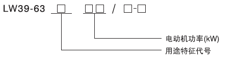

²Ù×÷µç¶¯»ú¿ª¹ØµÄ²úÆ·ÐͺÅ
±í2 ²Ù×÷µç¶¯»úµÄÓÃÍ¾ÌØÕ÷´úºÅ
ÓÃ; Ö±½ÓÆô¶¯ÊóÁýʽµç¶¯»ú Õý·´ÏòÆð¶¯ÊóÁýʽµç¶¯»ú Ë«Ëٵ綯»úÖ±½ÓÆð¶¯ºÍ±äËÙ ÐÇÈý½ÇÆð¶¯ÊóÁýµç¶¯»ú
ÌØÕ÷´úºÅ Q N S XS

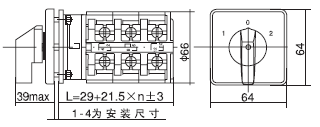

°²×°
¿ª¹ØÓÃ4¸öM4¡Á18³ÁÍ·Âݶ¤×é,°²×°ÔÚºñ¶È1~4mmµÄ¹ø°å»ò×㹻ǿ¶ÈµÄËÜÁϰåÉÏ¡£¿ª¹ØµÄÍâÐγߴçºÍ°²×°³ß´ç
Ãæ°å°²×° ¿ª¹ØÐͺŠÍâÐÍ³ß´ç °²×°³ß´ç
AÐÍËÜÁÏÊܱú
Ò»°ã·½ÐÎÃæ°å
LW39-63Ãæ°å°²×°ÐÎʽ´úºÅ
ºÚÉ«ÊÖ±ú²»±êÖ¾£¬ºìÉ«ÊÖ±ú±êAr
GÐÍËÜÁÏÊܱú
°²È«ÐÍÃæ°å
LW39-63/GÃæ°å°²×°ÐÎʽ´úºÅ
ºÚÉ«ÊÖ±ú±êGk£¬ºìÉ«
