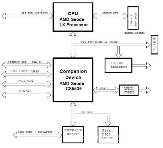

¹¦ÄÜʾÒâͼ
undefined

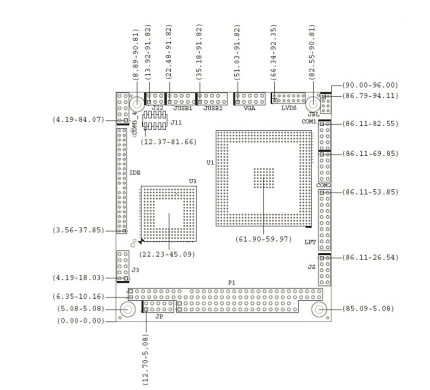

»úе½á¹¹
undefined
µ¥Î»£ºmm
