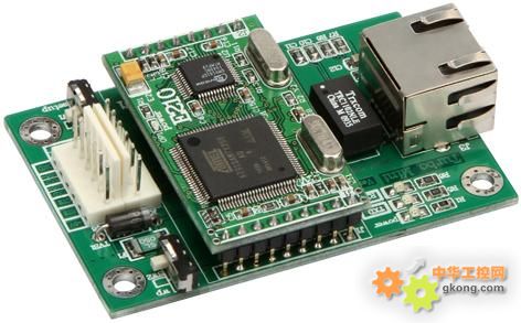

C2000 E2MAÊǾßÓиßÐÔ¼Û±ÈÇÒÎȶ¨¿É¿¿µÄ´®¿ÚÉ豸ǶÈëʽÁªÍøÄ£¿é£¬ËüÌṩRS485ºÍTTL´®¿Úµ½TCP/IPÍøÂçºÍTCP/IPÍøÂçµ½RS485ºÍTTL´®¿ÚµÄÊý¾Ý͸Ã÷´«Ê䣬Ëü¿ÉÒÔʹÉ豸Á¢¼´¾ß±¸ÁªÈëTCP/IPÍøÂçµÄ¹¦ÄÜ¡£
C2000 E2MAÏòÉÏÌṩ10/100MÒÔÌ«Íø½Ó¿Ú£¬ÏòÏÂÌṩ1¸ö±ê×¼RS485ºÍTTL´®Ðпڣ¬Í¨Ñ¶²ÎÊý¿Éͨ¹ý¶àÖÖ·½Ê½ÉèÖᣠC2000 E2MA¿É¹ã·ºÓ¦ÓÃÓÚPLC¿ØÖÆÓë¹ÜÀí¡¢ ÃŽûÒ½ÁÆ¡¢ Â¥Óî×Ô¿Ø¡¢ ¹¤Òµ×Ô¶¯»¯¡¢ ²âÁ¿ÒÇ±í¼°»·¾³¶¯Á¦¼à¿ØÏµÍ³¡¢ ÐÅÏ¢¼Òµç¡¢ LEDÐÅÏ¢ÏÔʾÉ豸ºÍCNC¹ÜÀíµÈ¡£
ÌØ µã
→¾ßÓÐTCP Server£¬TCP Client¡¢UDP¡¢ÐéÄâ´®¿Ú¡¢µã¶ÔµãÁ¬½ÓµÈÎåÖÖ²Ù×÷ģʽ£»
→Óû§»ùÓÚÍøÂçµÄÈí¼þ£¬²»ÐèÒª×öÈκÎÐ޸ľͿÉÒÔÓëC2000 E2MAͨѶ£»
→ͨ¹ý°²×°ÎÒÃÇÃâ·ÑÌṩµÄÐéÄâ´®¿ÚÈí¼þ£¬Óû§»ùÓÚ´®¿ÚµÄÈí¼þ²»ÐèÒª×öÈκÎÐ޸ľͿÉÒÔÓëC2000 E2MAͨѶ£»
→¶ÔÓÚÐèÒª¿ª·¢Èí¼þµÄÓû§£¬ÎÒÃÇÃâ·ÑÌṩͨѶ¶¯Ì¬¿â¡¢ÉèÖö¯Ì¬¿â»òOCX¿Ø¼þ
→ͨ¹ýä¯ÀÀÆ÷¡¢ÉèÖÃÈí¼þ»òÉèÖö¯Ì¬¿â½øÐвÎÊýÉèÖã»
→µÍ¹¦ºÄÉè¼Æ£¬ÎÞÐèÉ¢ÈÈ×°ÖÃ
→¾ßÓп´ÃŹ·Éè¼Æ£¬Îȶ¨ÐԸߠ

CPU      32-bit ARM
RAM      64KB
Flash    256KB
LAN
ÒÔÌ«Íø   10/100Mpbs£¬RJ45
´®¿Ú
TTL/485  TXD £¬ RXD £¬ RTS £¬ CTS £¬ GND £»485+£¬485-£¬GND
´®¿ÚͨѶ²ÎÊý
У Ñé    None£¬Even£¬Odd£¬Mark£¬Space
Êý¾Ýλ   6£¬7£¬8
ֹͣλ   1£¬2
Á÷Á¿¿ØÖÆ RTS/CTS
ËÙ ÂÊ    300 bps ÖÁ115200 bps
Èí¼þÌØµã
ЭÒé     ICMP£¬ARP£¬IP£¬TCP£¬UDP£¬DHCP£¬HTTP£¬DNS
²Ù×÷ģʽ TCP Server£¬TCP Client£¬UDP£¬ÐéÄâ´®¿Ú£¬µã¶ÔµãÁ¬½Ó ÉèÖà Webä¯ÀÀÆ÷£¬´®¿ÚÉèÖÃ(¿ÉÑ¡)£¬C2000ÉèÖóÌÐò£¬ÉèÖö¯Ì¬¿â
ÌṩÈí¼þ ÐéÄâ´®¿ÚÈí¼þ¡¢C2000ÉèÖóÌÐò¡¢´®¿Úµ÷ÊÔ¹¤¾ß¡¢ÍøÂç²âÊÔ³ÌÐò¡¢EDSockServer.OCX¿Ø¼þ£¬EDSockServer.DLL¶¯Ì¬¿â¡¢ÉèÖö¯Ì¬¿âÒÔ¼°VB¡¢VC¡¢BC¡¢DelphiµÄʾÀý´úÂë
Çý¶¯Ö§³Ö Windows98/ME/2000/XP/2003/Win7/Vista
µçÔ´ÐèÇó
µçÔ´¹æ¸ñ  5VDC £¬± 5%
µçÁ÷      ×î´óµçÁ÷СÓÚ200mA
»·¾³
²Ù×÷ζȡ¢Êª¶È  -25¡æ~85¡æ£¬5~95%RH£¬²»Äý¶
´¢´æÎ¶ȡ¢Êª¶È  -60¡æ~125¡æ£¬5~95%RH£¬²»Äý¶
ÆäËü
±£ÐÞ  1Äê±£ÖÊ
³ß´ç  66 X44mm
