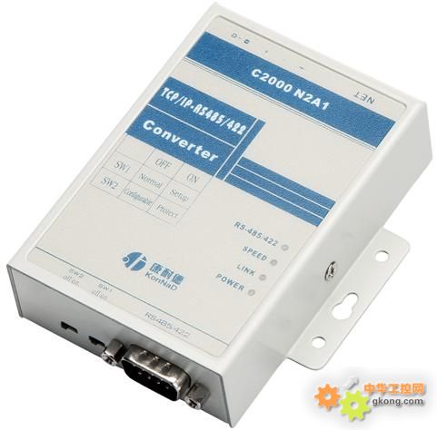

²úÆ·Ãû³Æ£º ÒÔÌ«Íø×ª´®¿Ú£¬RJ45ת485
ÐÍ ºÅ£º C2000 N2A1
¸ÅÊö
C2000 N2A1ÊÇÒ»ÖÖÎȶ¨¿É¿¿µÄ¸ßÐÔÄܹ¤Òµ¼¶´®¿ÚÉ豸ÁªÍø·þÎñÆ÷£¬ËüÌṩRS485/422µ½TCP/IPÍøÂçºÍTCP/IPÍøÂçµ½RS485/422µÄÊý¾Ý͸Ã÷´«Ê䣬Ëü¿ÉÒÔʹ¾ßÓÐRS485/422´®¿ÚµÄÉ豸Á¢¼´¾ß±¸ÁªÈëTCP/IPÍøÂçµÄ¹¦ÄÜ¡£
C2000 N2A1ÏòÉÏÌṩ10/100MÒÔÌ«Íø½Ó¿Ú£¬ÏòÏÂÌṩ1¸ö±ê×¼RS485/422´®Ðпڣ¬Í¨Ñ¶²ÎÊý¿Éͨ¹ý¶àÖÖ·½Ê½ÉèÖᣠC2000 N2A1 ¿É¹ã·ºÓ¦ÓÃÓÚPLC¿ØÖÆÓë¹ÜÀí¡¢ ÃŽûÒ½ÁÆ¡¢ Â¥Óî×Ô¿Ø¡¢ ¹¤Òµ×Ô¶¯»¯¡¢ ²âÁ¿ÒÇ±í¼°»·¾³¶¯Á¦¼à¿ØÏµÍ³¡¢ ÐÅÏ¢¼Òµç¡¢ LEDÐÅÏ¢ÏÔʾÉ豸ºÍCNC¹ÜÀíµÈ¡£
ÌØµã
²ÉÓÃARM7´¦ÀíÆ÷+RTOS£¬¾ßÓиüÇ¿´óµÄʵʱ´¦ÀíÄÜÁ¦
¾ßÓÐTCP Server£¬TCP Client¡¢UDP¡¢ÐéÄâ´®¿Ú¡¢µã¶ÔµãÁ¬½ÓµÈÎåÖÖ²Ù×÷ģʽ£»
Óû§»ùÓÚÍøÂçµÄÈí¼þ£¬²»ÐèÒª×öÈκÎÐ޸ľͿÉÒÔÓëC2000 N2A1ͨѶ£»
ͨ¹ý°²×°ÎÒÃÇÃâ·ÑÌṩµÄÐéÄâ´®¿ÚÈí¼þ£¬Óû§»ùÓÚ´®¿ÚµÄÈí¼þ²»ÐèÒª×öÈκÎÐ޸ľͿÉÒÔÓëC2000 N2A1ͨѶ£»
¶ÔÓÚÐèÒª¿ª·¢Èí¼þµÄÓû§£¬ÎÒÃÇÃâ·ÑÌṩͨѶ¶¯Ì¬¿â¡¢ÉèÖö¯Ì¬¿â»òOCX¿Ø¼þ
ͨ¹ýä¯ÀÀÆ÷¡¢ÉèÖÃÈí¼þ»òÉèÖö¯Ì¬¿â½øÐвÎÊýÉèÖã»
µÍ¹¦ºÄÉè¼Æ£¬ÎÞÐèÉ¢ÈÈ×°ÖÃ
Ë«¿´ÃŹ·Éè¼Æ£¬Îȶ¨ÐÔ¸ß
µçÔ´¾ßÓйýÁ÷¹ýѹ±£»¤ºÍ·À·´½Ó¹¦ÄÜ
¼¼Êõ²ÎÊý
ϵͳ
CPU       32-bit  ARM
RAM       64KB
Flash     256KB
LAN
ÒÔÌ«Íø    10/100Mpbs
±£»¤      ÄÚÖÃ1.5KV µç´Å¸ôÀë±£»¤
´®¿Ú
´®¿Ú      RS-485/422
´®¿ÚÊýÁ¿  1¸ö
ÐźŠ     RS485/422£ºR+£¬R-£¬T+£¨485+£©£¬T-£¨485-£©£¬GND
´®¿ÚͨѶ²ÎÊý
У Ñé     None£¬Even£¬Odd£¬Space£¬Mark
Êý¾Ýλ    5£¬6£¬7£¬8
ֹͣλ    1£¬2
Á÷Á¿¿ØÖÆ  XON/XOFF
ËÙ ÂÊ     300 bps ÖÁ115200 bps
Èí¼þÌØµã
ЭÒé      ICMP£¬ARP£¬IP£¬TCP£¬UDP£¬DHCP£¬HTTP, DNS
²Ù×÷ģʽ  TCP Server£¬TCP Client£¬UDP£¬ÐéÄâ´®¿Ú£¬µã¶ÔµãÁ¬½Ó
ÉèÖà      C2000ÉèÖóÌÐò¡¢Webä¯ÀÀÆ÷¡¢ÉèÖö¯Ì¬¿â¡¢´®¿ÚÉèÖ㨿ÉÑ¡£©
ÌṩÈí¼þ  ÐéÄâ´®¿ÚÈí¼þ¡¢C2000ÉèÖóÌÐò¡¢´®¿Úµ÷ÊÔ¹¤¾ß¡¢ÍøÂç²âÊÔ³ÌÐò¡¢EDSocketServer.OCX¿Ø¼þ£¬EDSocketServer.DLL¶¯Ì¬¿â¡¢ÉèÖö¯Ì¬¿âÒÔ¼°VB¡¢VC¡¢BC¡¢DelphiµÄʾÀý´úÂë
Çý¶¯Ö§³Ö  Windows 98/ME/2000/XP/2003
µçÔ´ÐèÇó
µçÔ´¹æ¸ñ  DC 9V~24V£¨ÍƼö12VDC£©
»·¾³
²Ù×÷ÎÂ¶È  -25¡æ~85¡æ£¬5~95%RH
´¢´æÎÂ¶È  -60¡æ~125¡æ£¬5~95%RH
¹¤×÷ʪ¶È  5~95%RH£¬²»Äý¶
ÆäËû
±£ÐÞ      ÎåÄêÖʱ£
